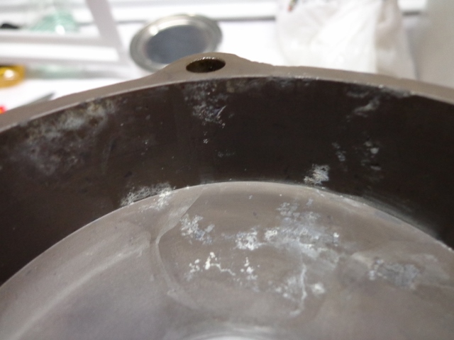

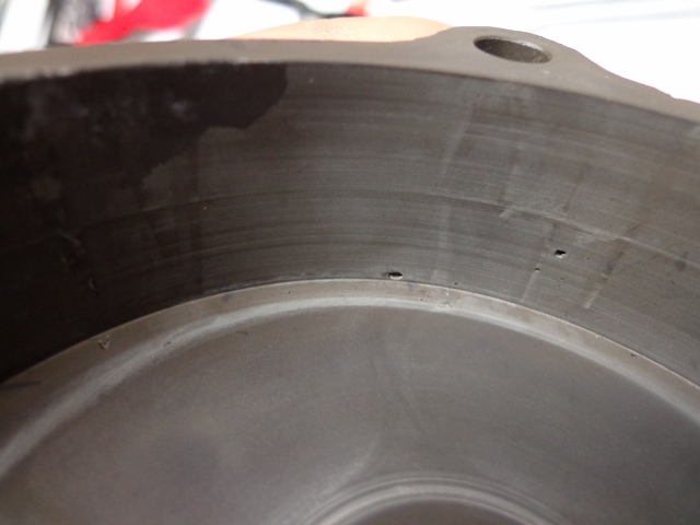

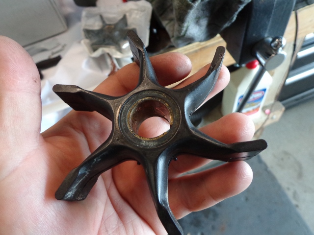

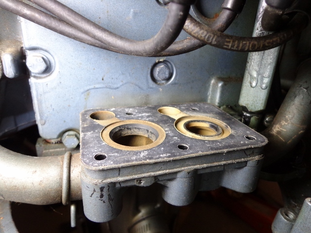

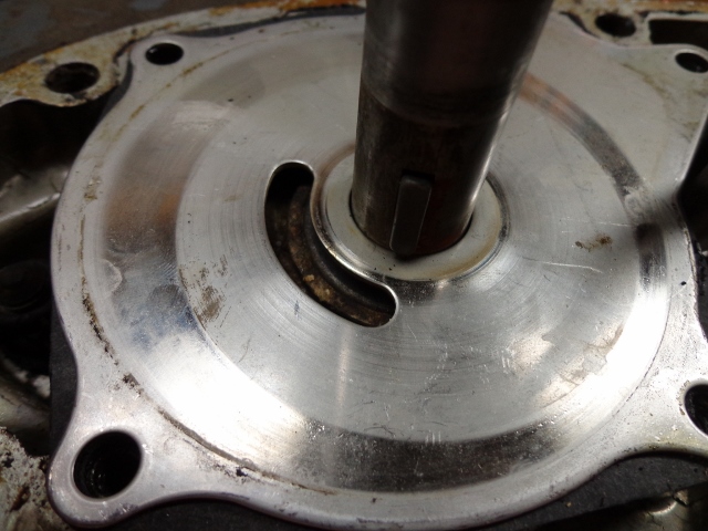

pics of the water pump housing. this one shows the bit of corrosion that did clean up smooth. the opposite side has a couple of pin holes. I think they might have been from bubbles in the casting. they don't go all the way thru. can either of these conditions cause problems? impeller. I think it looks good. the bottom plate no grooves just shiny from impeller. is this the thermostat housing ? if so what parts get replaced? or did I take this apart for no reason?
Re:Can I install a temp gauge on my 65 sport four? 12 years 2 months ago #99116
What I would do...at this point since you have it apart is take your garden hose and backflush the entire cooling system to make sure there is no junk plugging the lines or jacket. The thermostat usually can be cleaned up. It does look like your impeller has developed a "set" to it meaning the vanes probably are not doing the job efficiently. A new impeller will have the vanes sticking straight out and be stiffer than h. The housing shouldn't be a problem, looks like it cleaned up good. If you install a new impeller I usually soak it down with cooking oil/Mazola or the likes to make it install easier and then you can spin it without dry damaging the rubber. DO NOT use motor oil, it will destroy the rubber over time. Those impellers are fairly inexpensive. The last time I bought a NOS from my local dealer it was around $35.

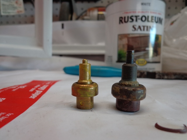

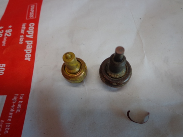

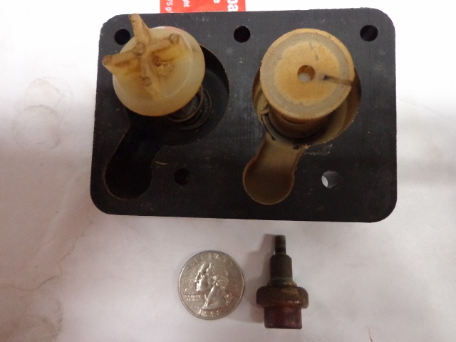

NUTS!!!!!!!!! the new one is smaller !

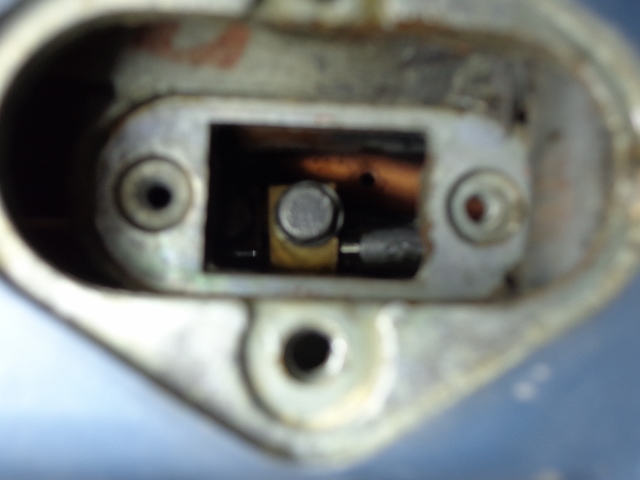

is this water tube supposed to have a hole in it ?
Re:Can I install a temp gauge on my 65 sport four? 12 years 2 months ago #99371
Hard to tell from the picture but it looks like the access port for disconnecting your shift rod. No water there.

the left of the pic is the top. I should have turned it before posting. as you are viewing the pic, the hole is to the upper right of the bolt head in the copper tube. It looks like it has been drilled . Had her out again today. Same problem. I beached her and pulled the thermostat out completely. still did not help. does pump a lot more water out the exhaust port. after a high speed run(28mph according to the speedo idon't think its right) it would bog down and try to die. I did have a thought and checked to see if the fuel tank was vented , and it was not. so, after venting the tank it actually did improve. but still had the same problem just not as bad. at this point I feel confident about not having a cooling problem. And before I foreget I wanted to thank you Sabre for your help.
A little late to this,but yes the tube is supposed to have that hole. At least all the ones I've had have had them. I'm guessing that's to cool the exhaust housing.
