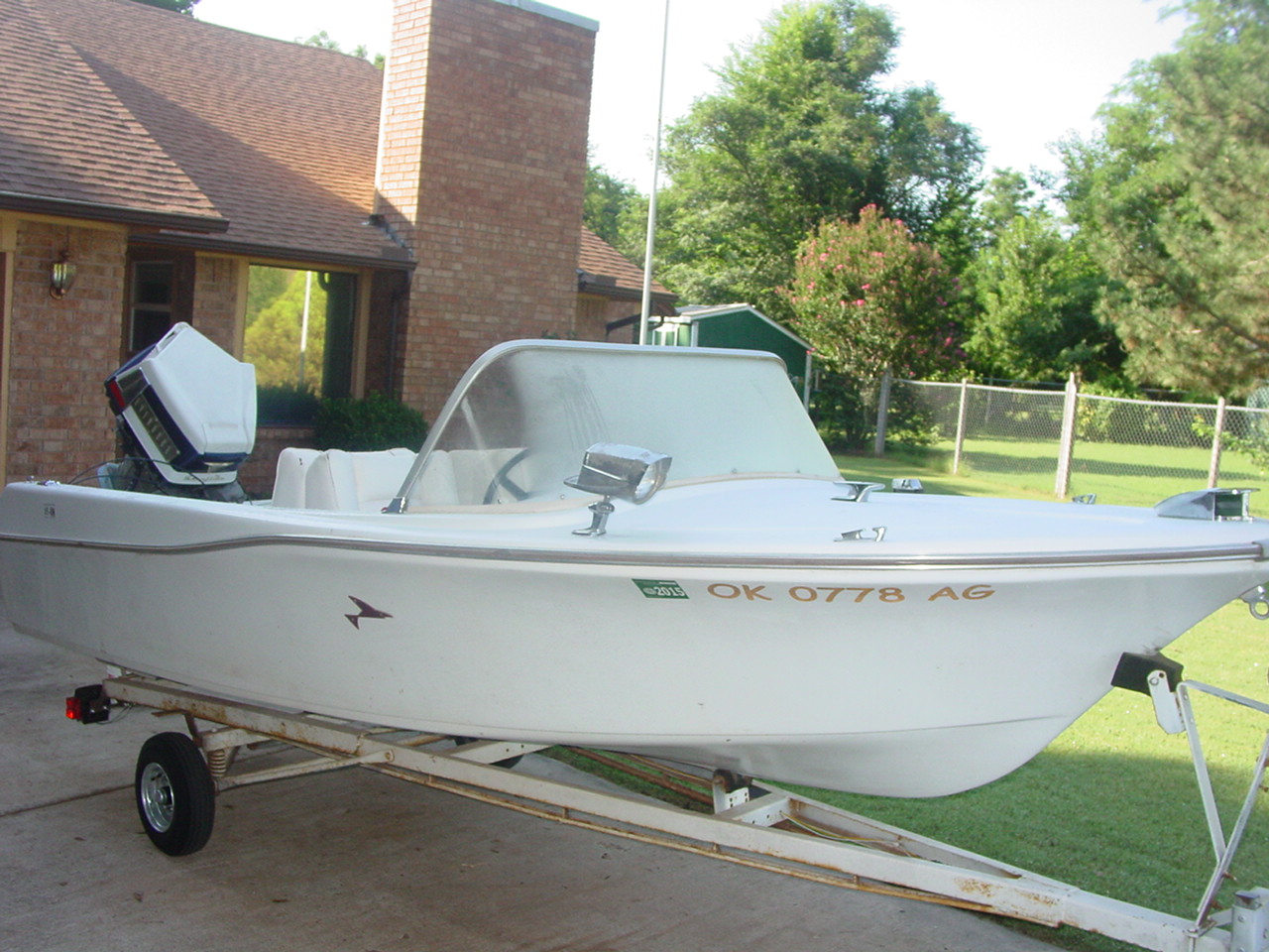

I had her out twice this week and she really screams at wot but still stumbles a bit at low idle.
This free boat has turned out to be free after all.
