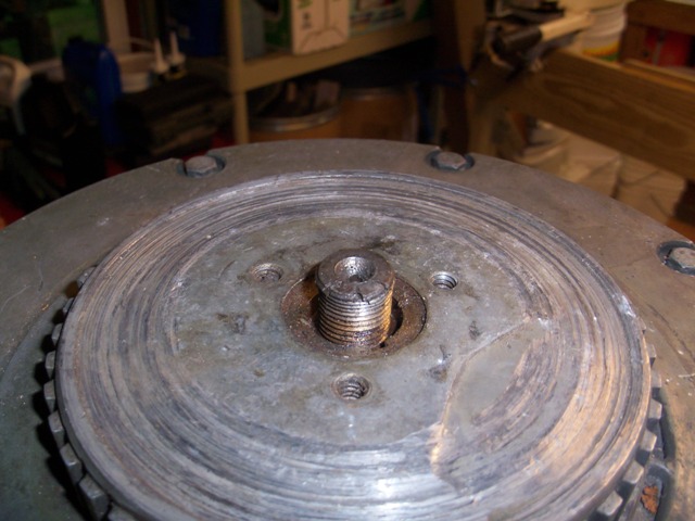

Well I started investigating the manual starter not working so I could troubleshoot the spark issue with the manual starter.
Someone else (not too bright) tried and did major damage.
I got hosed. Top of crank is damaged.
