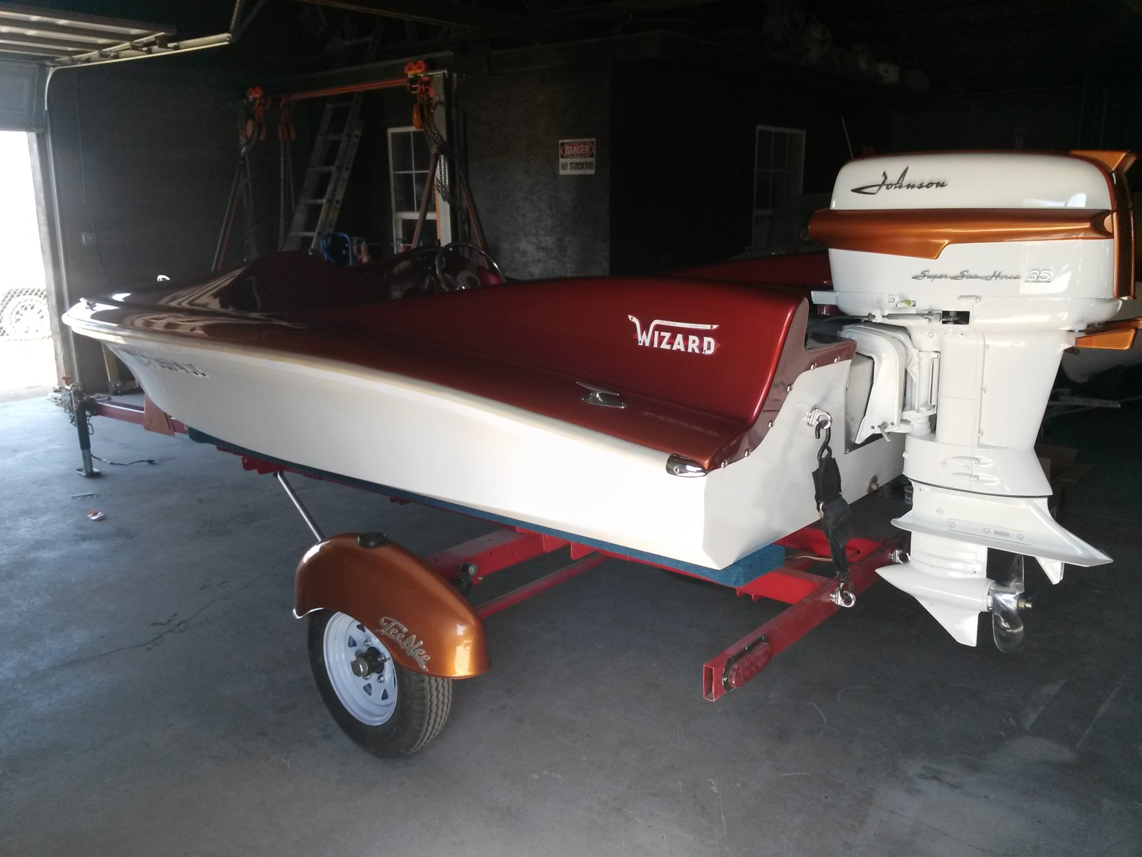

Cron, Your 58 Super Seahorse hood will fit early to mid 60's Johnson & Evinrude 40HP motors.
Here is a 58 hood that we are restoring on a 67 Evinrude 40. Only the front latch needs to be modified.
Larry

Thanks, Larry. That was what I hoped to hear. I see that the gasket(s) under the cover are the same on those models and was guessing that the '58 cover would be interchangeable.
I see more early '60s 40 HPs than '58 35 HPs and might need one for parts or to switch the cover on.
Thanks, again.
Re:'58 Super Seahorse 35 Parts 12 years 4 months ago #96746
  • cron78
  • cron78's Avatar Topic Author
