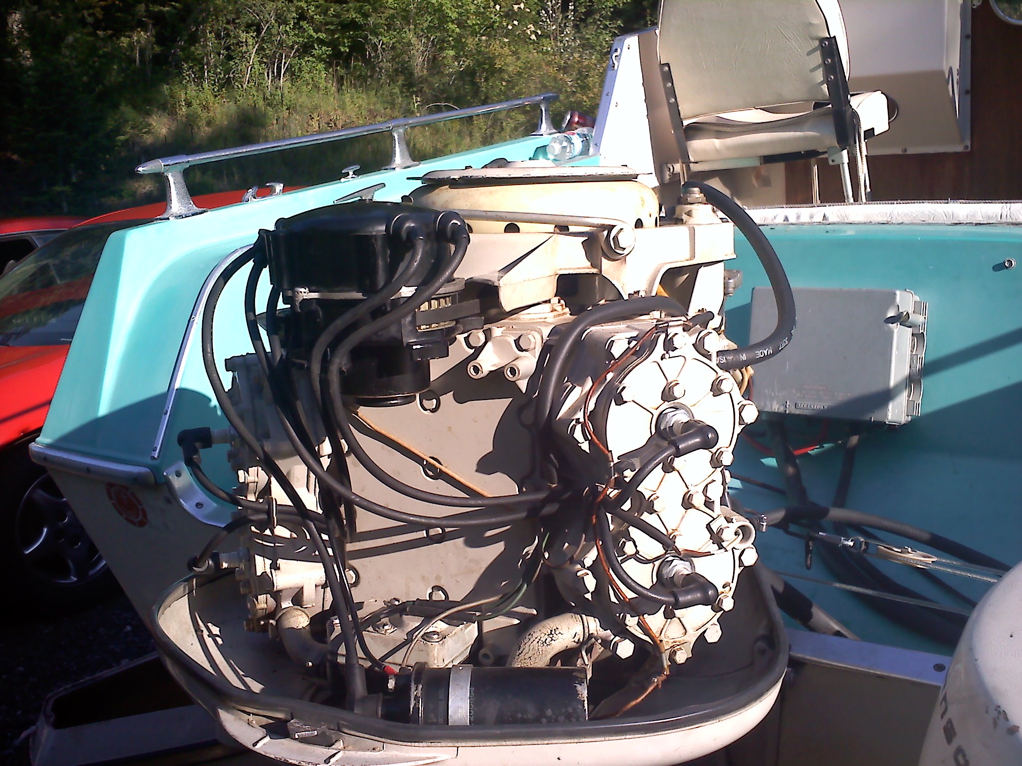

Well I thought I'd post a bit of an update. I decided to repower with a Homelite for now. Not sure what to do about the other issues going on now. I think its more ignition related because one minute it gets up on plane like nothing then I throttle down and try again and it wont get up over say 2000 rpm and then dies. I looked at the coil and noticed when i pulled the wire off that its oily inside the plug area. When it warms up it does a missfire out the exhaust when i have it in the tank too. Timing maybe? But only when warm. Im at a loss. The good news is I did get the fuel issue and heat issure sorted out. Had a small crack in the pressure line from the crankcase. So as soon as I get the Homelite put back together I may try to sell this thing.....or try to figure this issue out. Who knows.
Nick
1961 Uniflite 19' Express, Bearcat 55 powered
1975 Chris Craft 25' Tournament Fisherman, Twin 181 FL inboard
Re:75 hp Super Seahorse 16 years 3 months ago #12536
  • 64_Express
  • 64_Express's Avatar Topic Author
  • Posts: 185
  • Karma: 5
This was the pic I was going to post. Gonna have to figure this out
