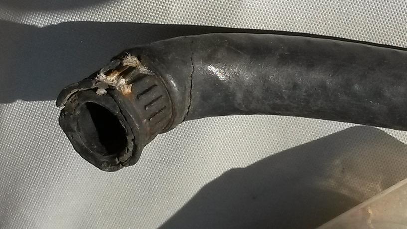

What diameter is the fuel line supposed to be between the fuel pump and the fuel inlet? I went to replace the line measured the fuel pump inlet and got 3/8 inch brought it home and it fit fine on the fuel pump but was too big on the inlet. was this hose special with 5/16 on one end and 3/8 on the other. The line I took off is hard as a rock but looks like it may have been stretched over the fuel pump inlet.
Could the inlet have been swapped with a smaller size?

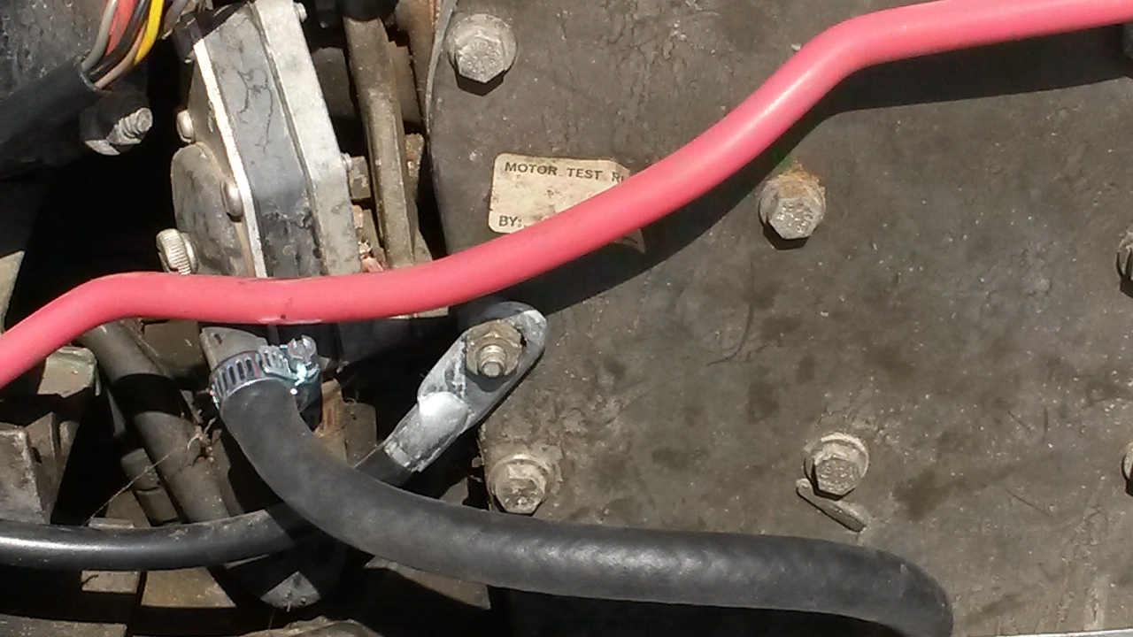

All right I bought a 5/16 fuel line forcing it over the 3/8 fitting on the filter fitting on the fuel pump. I have a big concern over the sharp turn coming off the fuel filter.
here is a pic. of the old hose and what happened to it.
Here is a pic showing why the sharp turn is necessary. It has to stay inside the upper cowling. I made the hose a little long to help with the turn.
Re:fuel line diameter 70 tripple 12 years 5 months ago #95821
While I'm not familiar with the triples, some of the OMC V-4's have a supply hose configured like you are describing. One end is a different diameter than the other. Some are still available through BRP (OMC), and the supply houses (marineengine.com, boats.net, etc.) but very pricey IMHO.
I did the same thing you did, made the best I could with what was available to work with. Looks like your loop will prevent the sharp turn, should work out okay?
Re:fuel line diameter 70 tripple 12 years 4 months ago #95899
Mark's right, that should be fine. Too late now but I was going to suggest using a heat gun to warm up the smaller hose a little then slide it on. Just don't get them too hot. It's soft rubber but it will still expand a little when heated up.
