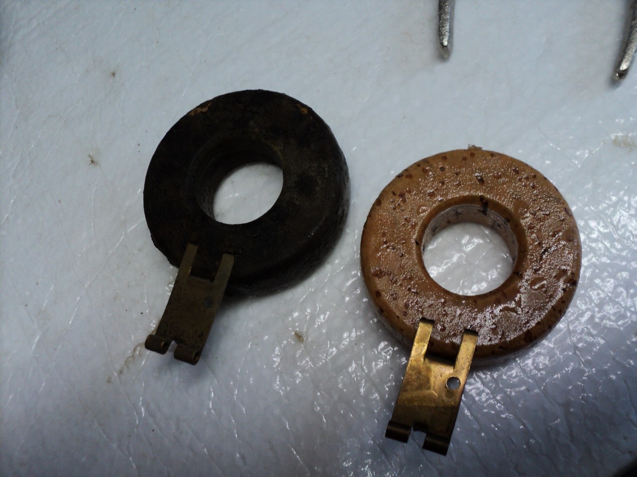

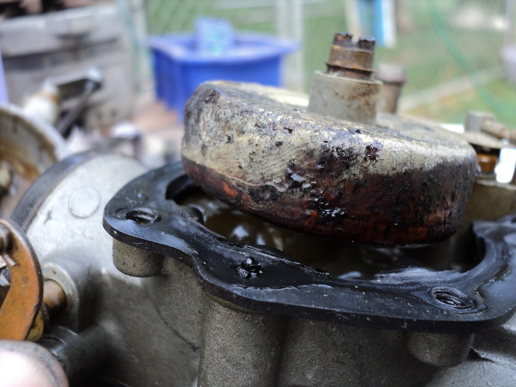

Replace all rubber components in the carb and pump and do not forget all the hoses. They are not ethanol resistant. Ferguson Poole helped me out greatly. If it has a cork float it will need coated with new shellac also. I just bought a new one. Mine was a 59 35 hp. I may look intimidating but it is not. It is a simple motor to work on.
