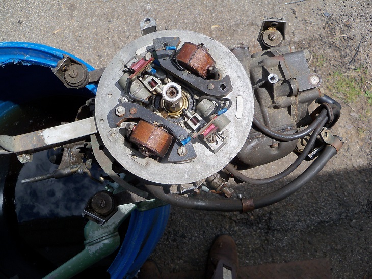

Hi All, anyone know if early 1950-ish coils are available? They appear to be completely different from my QD-13 and all the rest '52 & newer...??? One supplier's reference says that they're the same from '49-'72, but that's not correct...also I didn't see any points under the flywheel...??? Thanks-Craig

The stator plate is different, I didn't see any points, although it has 2 opposed spring loaded rods that ride on the lobe on the flywheel...??? I've never seen anything like it. I wonder if it could be converted to a newer style stator plate & coils...??? I'll try to do some pics...

Here's my solution for the 49-51 QD coils, take 2 new OMC coils and remove them from the heels. Remove the old coils from their heels and install the new ones upside down on the old heels. Make new ignition wires which need to be longer and pass them through the original holes making sure to get them clamped into the holders so there is no stress to pull them out or allow them to ride up and hit the underside of the flywheel. Connect the green wire to the points and the black one to ground, clean and set the points and you should be good to go. I did this conversion on a friends and my 49 QD in 2005 and they still run great today. All this said your coils look pretty good have you tried cleaning the points and checking for spark?

Awesome, 'how' do the coils remove from the heels? Are they glued? The last thing I did yesterday was clean the points, but I haven't installed the flywheel yet. The reason I was gonna change coils is the coating appears to have 'melted' and run down the engine. Any advice on recoating the old coils...??? Thanks for the reply-Craig
Re:10hp QD-11 Coils??? 11 years 11 months ago #95431
If the coils are dripping they are shot. The coils are held on by tabs at the outside edge of the heel just bend them straight and gently convince (I find that clamping the heels in a vice and using a piece of soft wood as a buffet to tap the coils off works) the coils off the heels. The old ones usually come off easier than the new ones but just take care doing it to not damage the new coils. Putting the new ones on is easier!

Kool, thanks, I can't wait to try it. I have a 'new' coil that I installed incorrectly, back in the mid 80's, and the heel was tweaked. I never knew why I actually saved it, but it should be perfect for a conversion...I also have several used coils that aren't cracked that might work... I'll report back on results, Thanks again.

I did a quick conversion, but I don't have new plug wires yet, I had spark in one coil, (the NOS), but not in the used, un-cracked one, I guess I'll get another new one. Something seems to be 'rubbing' when I spin the flywheel. I'll have to double check everything...
