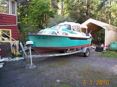

Don't overlook modern engines for your Glassic.
Here's a shot or two of my new to me 58 Skagit 20 Express sporting said outboard.
I'll be using a laptop to tune her up soon.
You can't see any smoke, not even at startup.
I'm running the recommended XD50 oil in her injection system so she doesn't get Snarky on me.
The special spark plugs are expensive, boy what a difference going from NGK to Champion to NGK again. Both are listed by BRP, and the Champion part number is called out right on the motor data decal. She barely runs with the Champions. Put the NGK's back in with no other changes and she runs great. Twice I did that just to confirm.
I've run Mercs, OMC's, Homelite/Bearcats and had a ball with them all. To me, any engine that is safe n reliable is a good powerplant.
This one came with the boat/trailer, works sweet, so right now she's a good one. The summer is lookin' good so far!

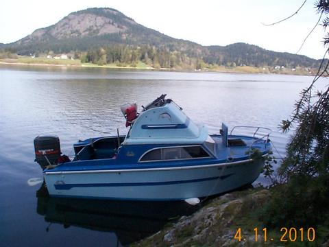

Boy, she IS a unique boat. Really beamy similar to a Dorsett San Juan or POwer Cat.
Here's some pics of her in April.
