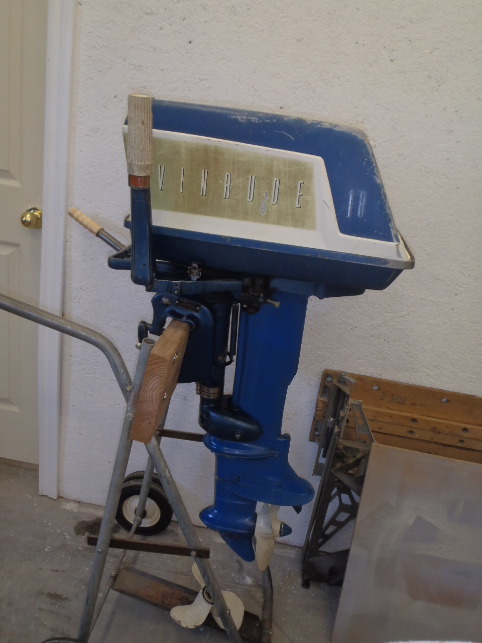

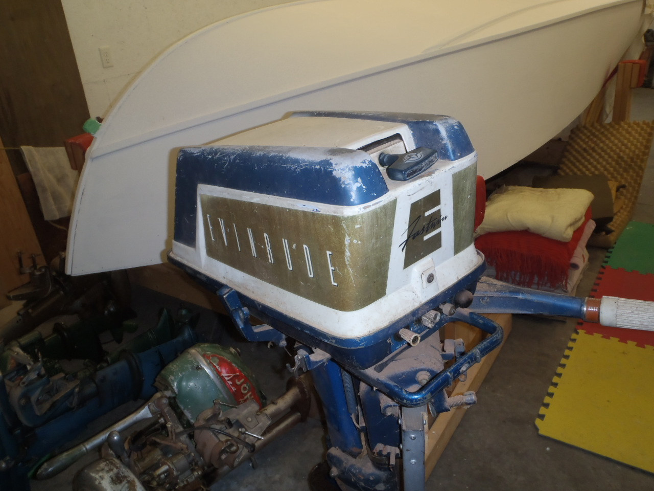

My 59 Fastwin Story:
I picked up a very sad looking 59 Fastwin for free (and trust me if it wasn't it would have stayed there) last winter. This poor thing was stored in the wood shop and had sawdust everywhere. I was just going to clean it up and sell it off but it was in such bad shape I figured no one would buy it! I did need a daily runner for my 14' fishing boat so I figured I'd check this one out and it needed everything, but the compression was good soooo I did the ignition, replaced the wires and plugs, replaced the broken recoil, replaced the carb with a good one which I overhauled, checked the impeller (it was new) drained the LU (nice and clear), spent an hour cleaning it up then tossed it in the test tank and it runs like new!
Here's before and after pics:
Note the tremclad blue tower and 2 hose clamps on the swivel!
