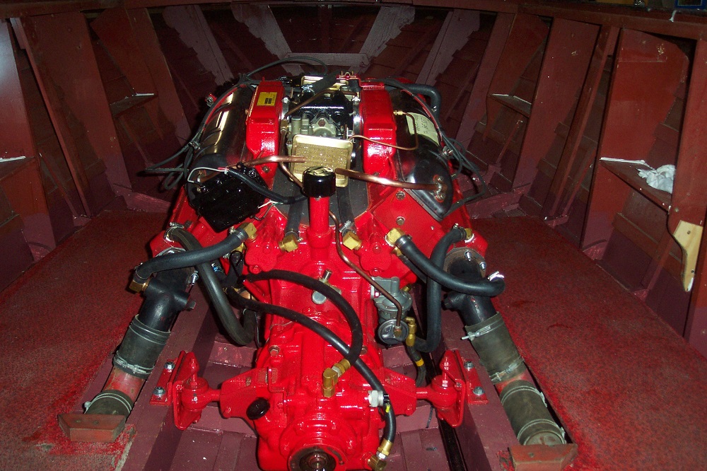

Sorry Cal not yet. Weather has been iffy so I opted to finish stripping down the Resorter's 350 to go to the machine shop for a quote on the heads and block. I'm hoping to get at it tomorrow or over the weekend. I'll keep you posted.

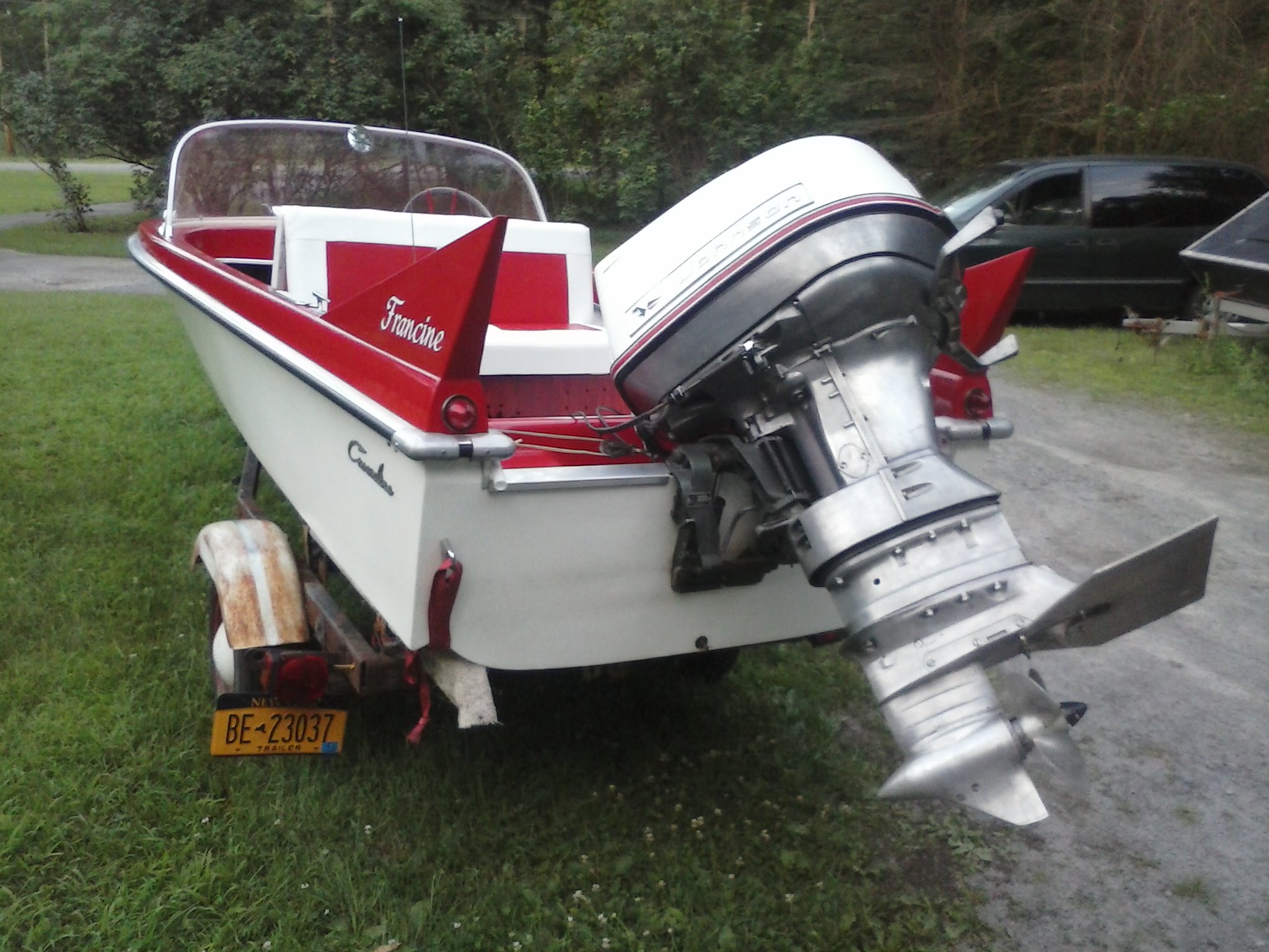

Like the boat and motor,Matty. The silver/white blends good with your boat.

Thanks Jim, she's my "first restore".
