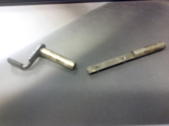

Well was going rebuild the carb on my 66 evinrude and thought it was wierd the choke blade was really loose feeling. Well found out why. It broke on the end by auto choke. Even worse it the carb housing ovaled out from it being broke. Also found inside the choke housing the springs not hooked up and the eletric solenoid missing it guts and the wire to it. Now my main fear with the housing ovaled out is there a chance of water enter the intake of the carb from the choke housing. It has the auto with the tube going to it. I found a carb on ebay that from a 67 it doesn't have the auto choke but it got every thing else like mine could rob/transfer parts between them?

The upper half of the carburetor is where the choke components are located. The electric choke carb will have the air horn drilled differently and is not a good solution. Find the correct carb for your engine & you will avoid headaches. These carburetors are easy to find - just spend a little time looking. Be sure to install a new float - and one that was made recently. New floats will resist the alcohol in modern fuels. The NOS floats coated with red shellac will fail.
