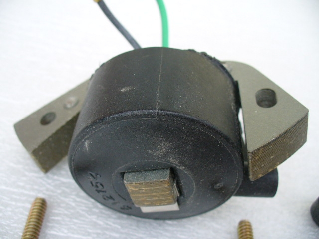

Hi,
Here are a couple of pictures of the new coils (taken when we sold some) which might make a comparison easier.
Regards,
Joe
www.fergusonpoolemarine.com

Thanks Poole, the 3 hp is a 48-50 sea king 94GG909A, has a strange looking point settup, that I've never ran into before (as I have little motor experience). Has the plastic rod that rests against the cam portion of the crank and open and closes the point. The coil looks to be in good shape I may have to get a light and test the coil as the plug wire is soldered to the coil and the wire portion is in rough shape.... The 3 hp is complete so I plan on getting this one running and freshening up the paint and decals on this one.
