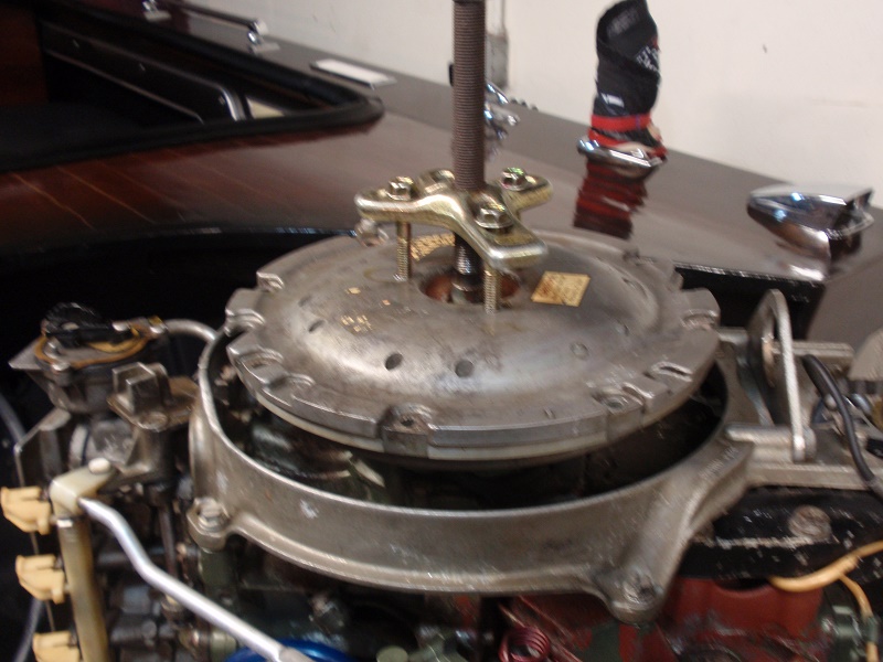

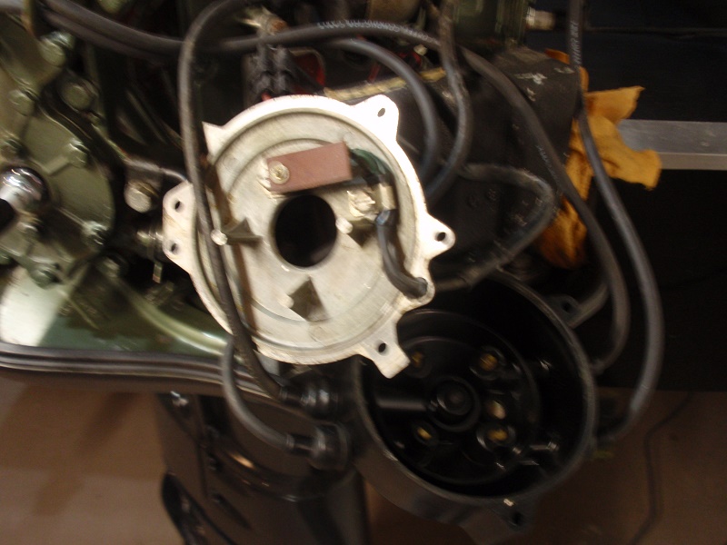

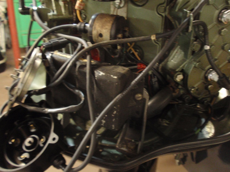

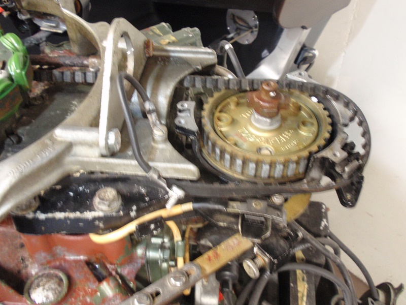

I want to change my 1967 100 hp Johnson with a CDI to a conventional ignition system. Everyone says it's an easy change but no one comes up with a step by step process or parts needed. I'll start out with some pictures and hope someone jumps in and tags along with info.
Cal
Popped the cap off for a look see.
Found one dehydrated mouse.
Belt was a little frayed on the lower edge
The distributer plate and stuff.
The CDI pack and stuff I want to replace.

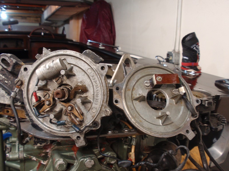

The weekend was filled with family doings, grandkids track an volleyball tourneys etc. Was pleasantly surprised when I returned home. In the mail was the distributor I bought on eBay. That was fast! I think it has everything I need to start the changout. I'll need to pick up one more set of points I can get at NAPA.

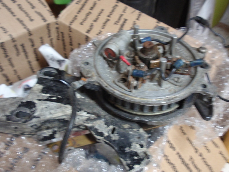

Here's the "new" old eBay distributor
Comparison of the two.

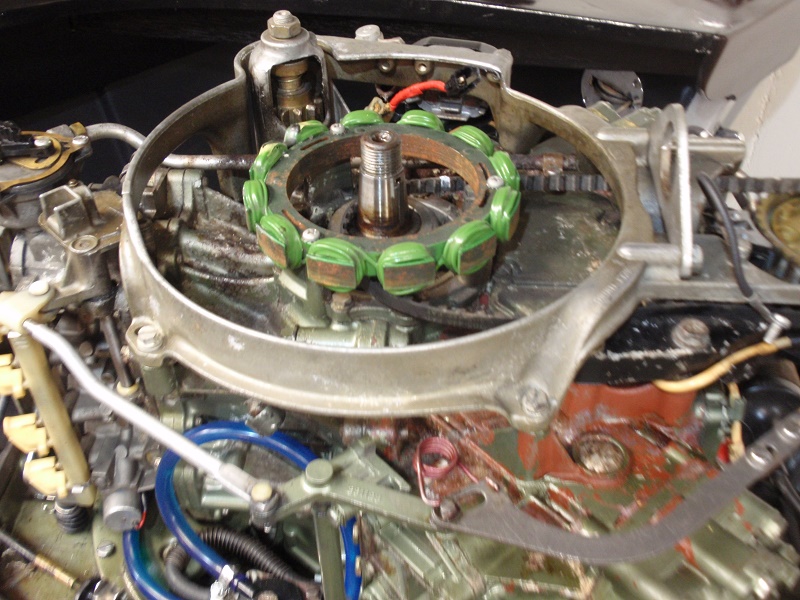

Bruce, Will I need to get a different stator? Looking at the schematics for both the '66 and '67, the '66 has four leads coming off, the '67 has two leads. Two of them go to the rectifier one goes to the regulator and the other goes to the ignition "on" light.
The '67 wire going to the regulator has the 20 amp fuse. What did you do for this?
Here's what I've come up with so far.
Install the distributor assembly
Attach ground wire
Black wire goes to coil negative and also splits off to temperature cutoff switch (assuming this shuts motor down if it over heats)
Positive pole of coil goes to ignition switch
Large wire of coil to distributor (of course)
Stator assembly
Two wires to rectifier
One of those wires splits and goes to regulator
Capacitor wire goes to gen side of ammeter
Regulator assembly
One wire goes to ignition switch
One wire goes to fused connection from stator
Ignition “on” light can stay as is.
Cal

Your engine is a 1967 and the stator and flywheel were only used for that year. You don't need to do anything with the charging circuit, unless it wasn't working. Please realize that the under flywheel charging system has nothing to do with the ignition system on this engine. Your engine uses a simple 2 wire stator feeding into a full wave bridge rectifier. The negative output of the rectifier case is normally bolted to the engine block, serving as the ground. The positive terminal is normally fused to protect the charging circuit. The 1966 and earlier motors had the "unicharger" system that used 4 wires to the stator. This is a different deal all together. But again, the alternator for these motors is not part of the ignition system, they only serve to charge the battery.
As for the coil, I used a 3 Ohm Pertronix coil, because I didn't want to mess with a ballast resistor. Most VW shops should have this coil, as it's a popular one for dune buggies and sand rails.

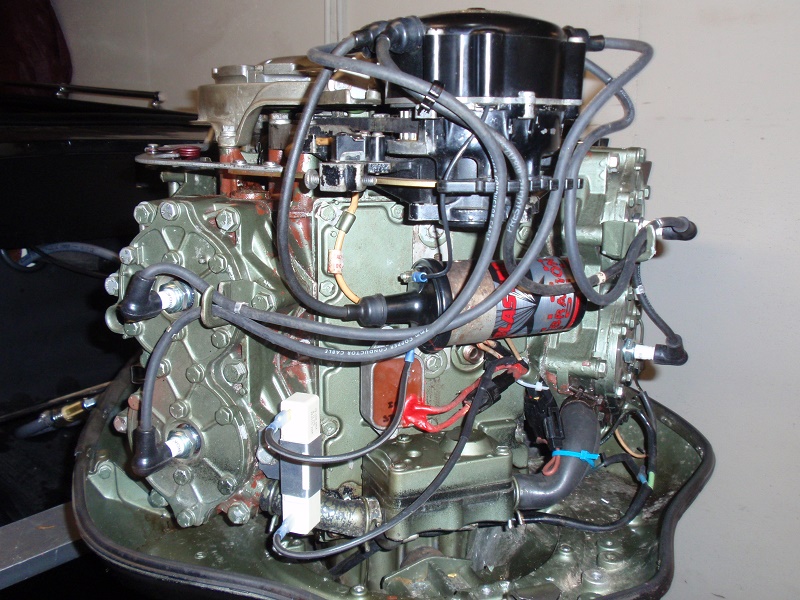

Bruce, thanks for all the helpful information, I finished up the changeover today and it was pretty straight forward. O'Reilly had the MSD .8 ohm resistor, I don't have any problems with that. I had a 2. , 1.4, and a .6 in my tool box but not the .8 :(
Put in the new points, condenser, made up some new wires for all the stuff also. I followed the manual for timing, just aligning all the marks on the flywheel, water jacket cover, distributor pulley and bracket. Got about 3/8" flex on the belt. I set the points at .012. Not sure if this is correct, I'll have to do some checking on that. It sure did clean up the mess on the back of the motor. Maybe Friday evening I can attempt to start it and do the final adjustments. I'll post some pictures later.
thanks again.
Cal

Yupper, I did use the ground wire. Here's a final picture, sure cleaned up that mess in the back. Thanks to all you guys for the help. Hopefully this is a more reliable assembly than a 47 year old CDI. And yes I did confuse the ignition and charging circuits good thing that was pointed out. Total cost for the change over. eBay distributor with shipping - $55. .8 ohm MSD ballast resistor - $12. MSD 45,000 volt blaster coil with tax - $49. Condenser - $4. 2 Sets NOS points $52. So for roughly $170 I have a conventional ign system that's easy to maintain and half the cost of a black box replacement :)

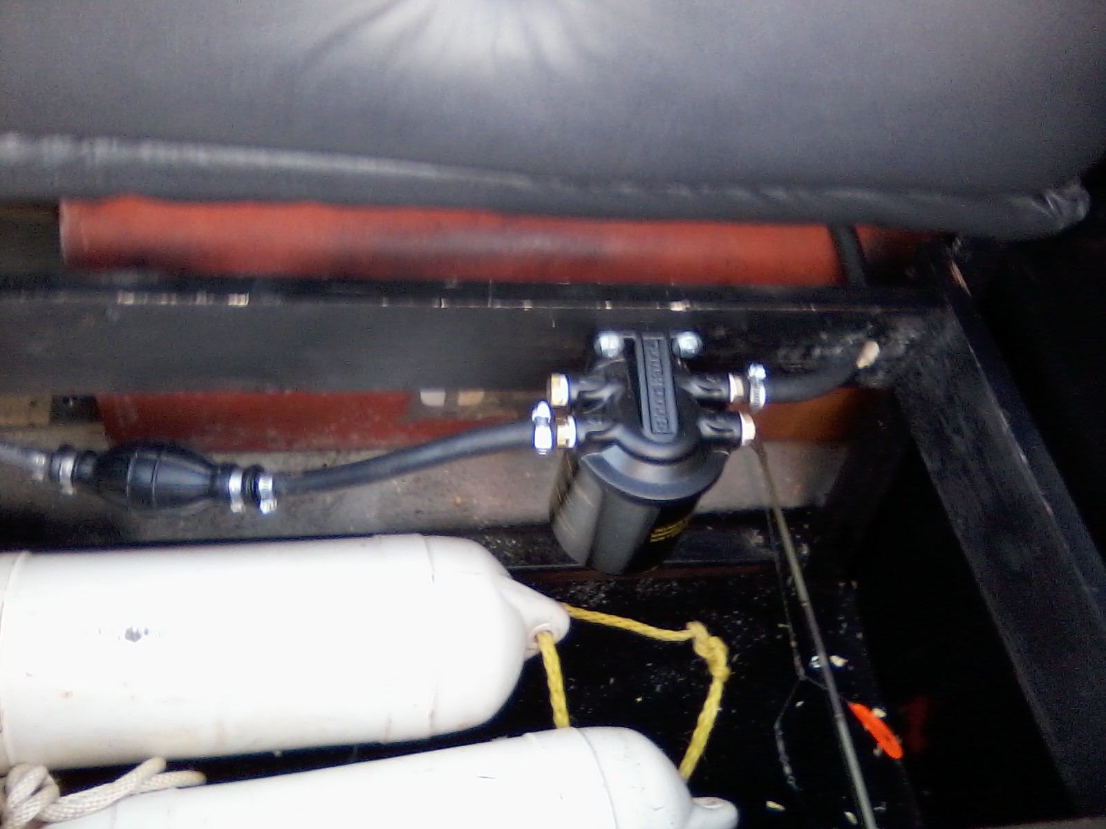

Motor runs fine now but I'm having an issue with powdery rust in the fuel tank that I'm working on. Had it on the water but couldn't open it up because the fuel filter kept plugging :(
