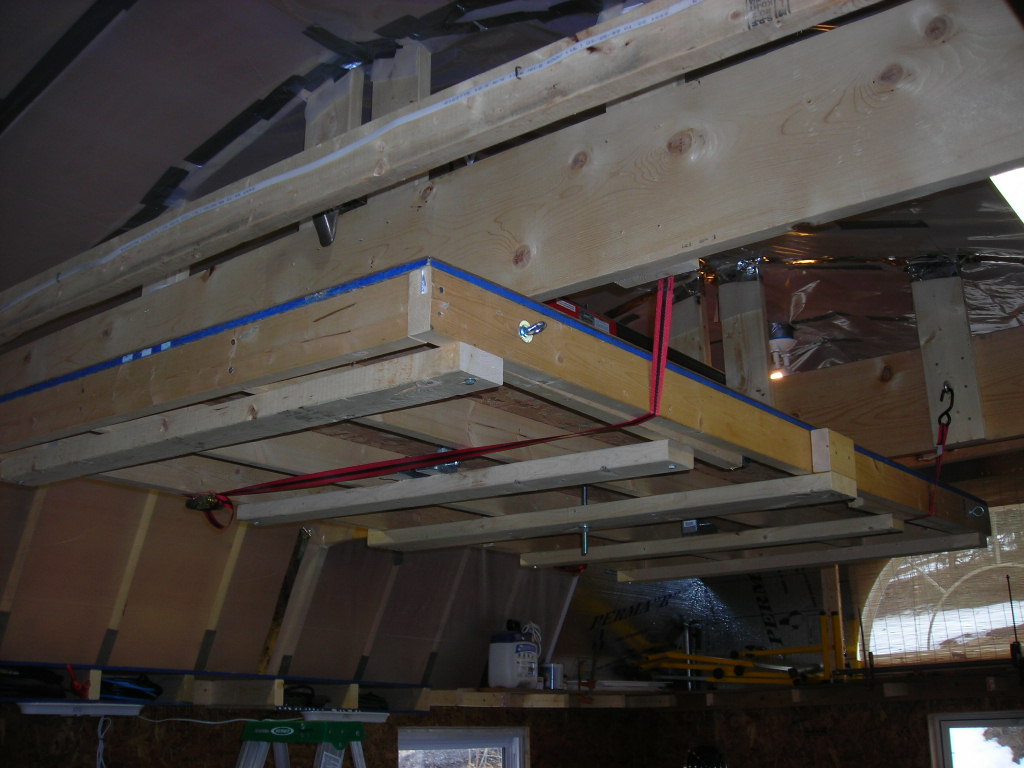

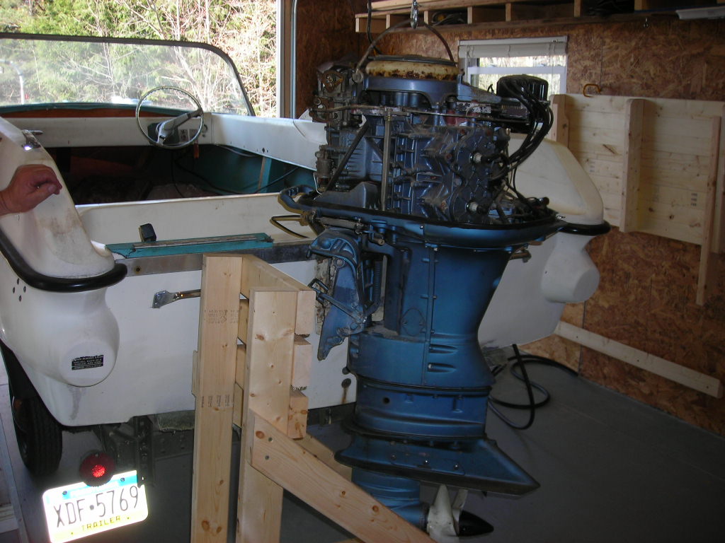

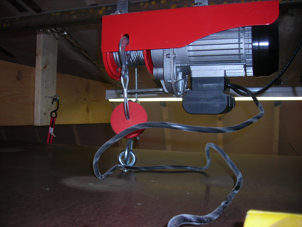

i bought an 1100 lb hoist from harbor freight last year and it does great so far,i use it to hoist my homemade foldup 4x8 table into the rafters ,and removed my boat motor easily.the reason i hoist my table is my garage is only 14x24.
