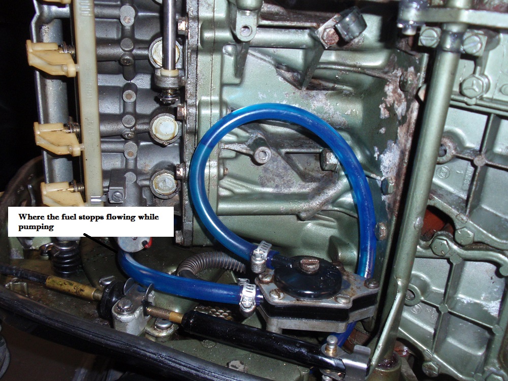

The kudos came too soon. Seems I have a more complex fuel problem. I put all new fuel lines on this past week, the clear kind that you can actually see the fuel flowing. I pumped the bulb up tight and watched as the gas went through the lines. It gets past the fuel pump and a small amount goes towards the carbs and then it stops. Seems like air is backing through the carbs. The engine will run for a short time with the little bit of fuel that was in the line and then shuts down of course. I took the fuel pump apart and it appears to be good, nothing cracked, no holes, springs etc are all good, no splits or tears in the rubber which is very flexible. I'm thinking the carbs, floats, needles are probably varnished up and something is sticking. Any way to clean them out without a complete disassembly? Hate to spray carb cleaner in there not knowing what it will eat up.
Help.
Cal
Re:Wish me luck 12 years 7 months ago #92051
Take the carbs apart & clean them completely. Then you know they are good. You don't want to burn down one cyl running it lean.
Re:Wish me luck 12 years 7 months ago #92053
I suggest you take the starter apart.---Clean and lube the reduction gear in there and the bushing in the block.
Re:Wish me luck 12 years 7 months ago #92059

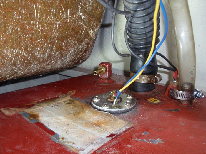

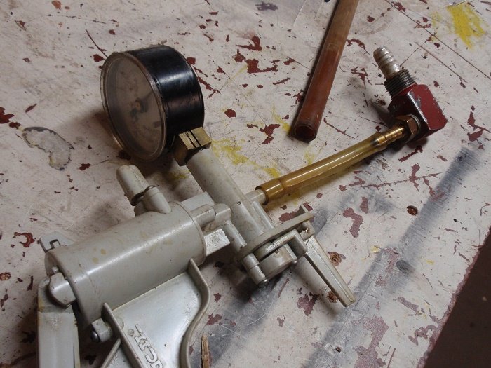

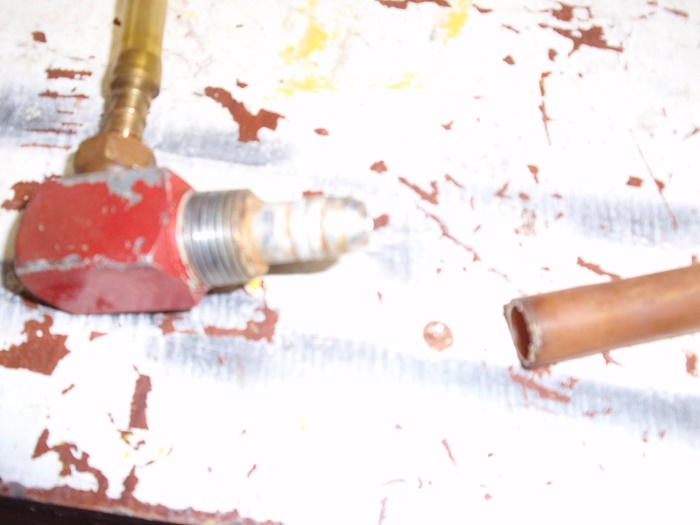

I think I have good news though that can put this whole discussion to rest if I'm lucky.
I pulled the hose off that feeds into the carbs and pumped the bulb until it tightened and then I'm seeing air bubbles in the line. At first I thought there was a leak in the fuel pump somewhere so I screwdrivered everything to make sure, all tight. Some serious thinking and perusing over a couple beers wondering where air is coming from and the only thing left was the feed line from the tank itself. I pulled the whatchamacallit dipper from inside the tank and put a vacuum pump on it while sealing the end with my finger. It was losing vacuum pretty fast. After putting oil/gas resistant gasket sealer around it, resealing all the threaded ends I rechecked the vacuum and it held at 30" solid. Maybe this was the problem all along.
Any opinions??
Re:Wish me luck 12 years 6 months ago #92276
Could have been it. Put it back together and see what happens. If it's still acting up your no worse off than you were before.
Re:Wish me luck 12 years 6 months ago #92277

The last thing I want to do is rebuild another carb. Since I repaired the inlet tube inside the tank things seem to be holding. Over the past week the bulb has held tight, no air bubbles in the line. The weather has put the kibosh on any testing but I'm hoping things will be fine.
I received a letter from the previous owner of the boat, actually the original owners son. Bought the boat new in '68 and used it extensively but after his wife passed it was relegated to behind the barn and sat for many years. He was an AMS/Oil dealer and always used those products in/on the motor. That probably explains the good condition everything was in, all I had to replace was a starter solenoid, plug wires, water pump impeller and other mouse damage. Compression is 120 in all four. Lower unit oil was clear when I changed it and doesn't leak a drop at all :)
