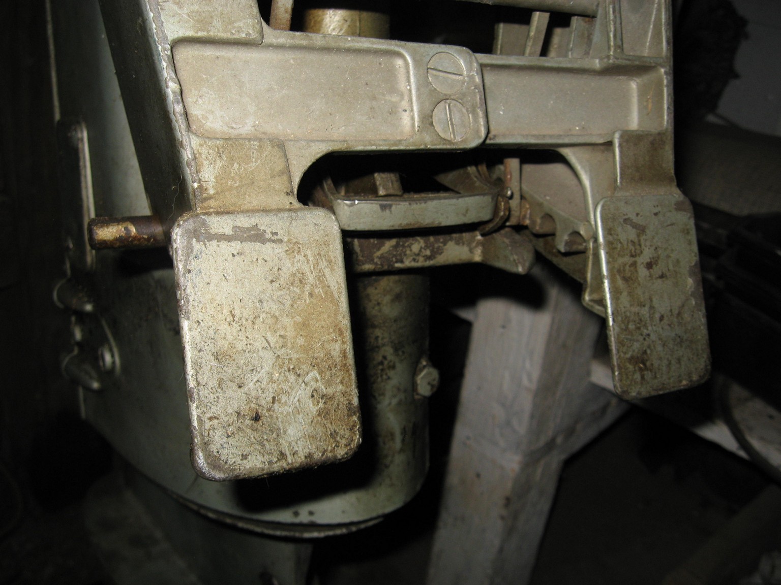

My 35 HP Golden Jubilee has no bolt holes for the transom. Is it OK to drill two through the bracket? If so where would you do it? Thank You in advance.

Not sure why you want bolts, Big Twins have done fine without them for years. Also, the brackets are cast aluminum which could crack if you weaken them by drilling holes. Just make sure the clamp screws are tight and you should be fine.
Re:Bolt holes in bracket? 12 years 7 months ago #90755
I like the security. I run a lot of shallow water around here. I already a design of one in mind that will require no drilling and fit between the bracket arms.

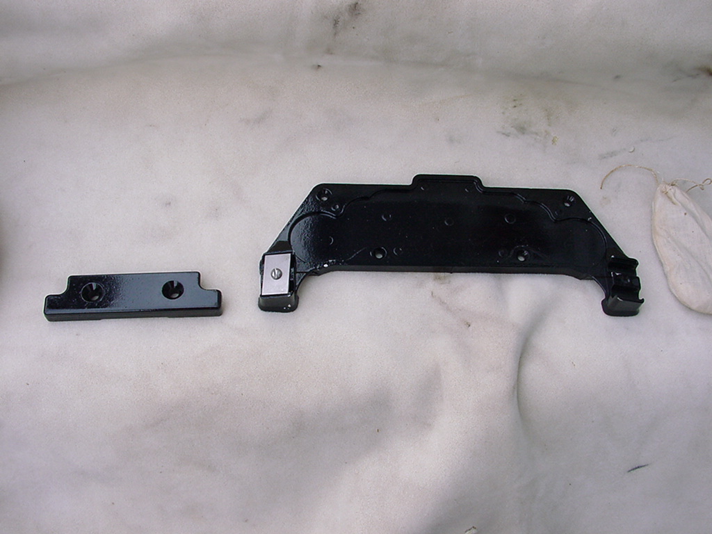

There is an accessory bracket available that bolts through the transom and the motor bracket drops into it and is secured. I will post a pic when I get home from work and I'm 90% sure I have an extra one kicking around the shop.
Al
Re:Bolt holes in bracket? 12 years 7 months ago #90864
Here's a pic of what I am talking about, it's the part on the left that attaches to the outside of the transom and holds the tabs on the motor bracket.
Re:Bolt holes in bracket? 12 years 7 months ago #90865
Hey, I have one of the inner transom brackets, but the boat didn't have the exterior piece.......
