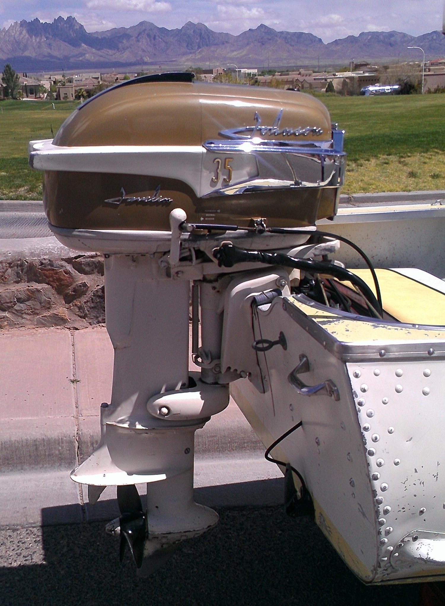

I have a '57 Johnson Golden Javelin on a Lonestar Malibu. The engine has developed a crack in the mid-case just under the exhaust port (both sides). I understand this was a problem with some early castings being thin in this section and later castings were beefed-up. Does anyone know how to repair the cracks or (more likely) where I can get a new beefier mid-case?
Any 1957 and 1958 Johnson or Evinrude mid section will fit (Except the supper silent). Just will have to paint it. If you cannot find one local let me know and I can sell you one of the many that I have laying around.

TallTexan - Yes, I'm interested in getting a mid section from you. I am in southern New Mexico for shipping purposes.
Questions:
1. Do 'beefier' mid sections exist for these engines?
2. Would one of yours be 'beefier'?
3. If replacing with a 'thinner' mid section, can anything be done to prevent the cracking?
4. Does anyone know what paint (formulation, color) to use?
