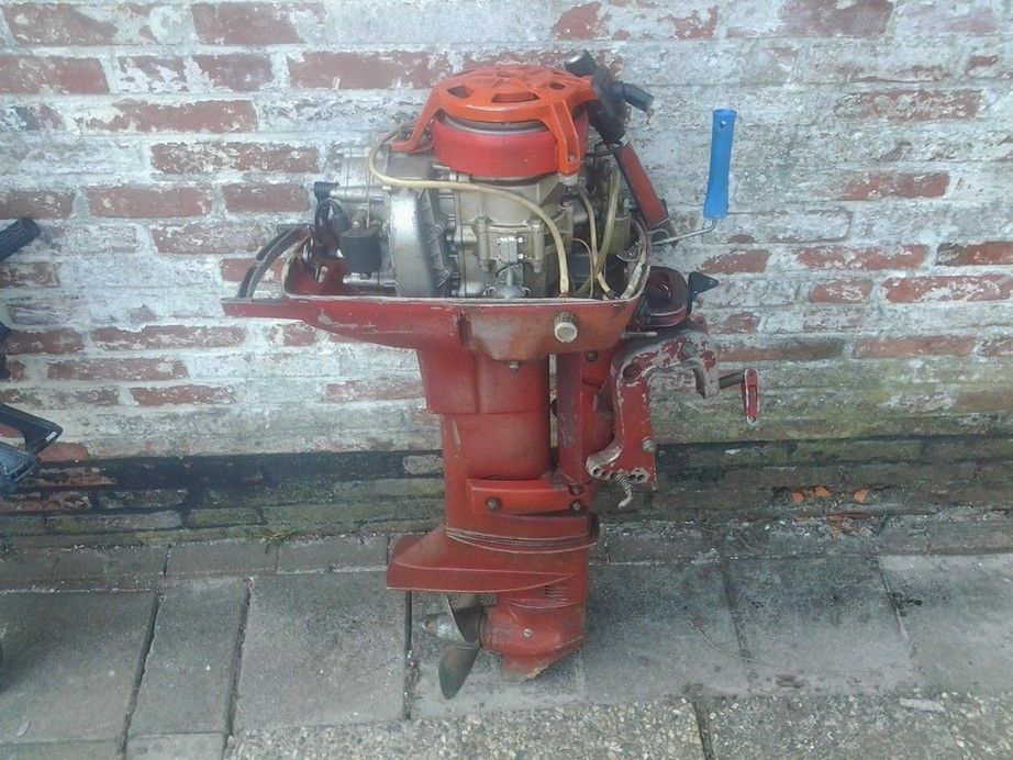

hello,
Does someone know if this is a evinrude 25 hp? they sell it as a evinrude 25 hp but i don't think so. And these are the only pictures on the internet there is no picture of the hood. maybe someone over here knows it.
Re: Evinrude 25 hp? 12 years 11 months ago #87090
For one thing the exhaust is on the wrong side to be a 22 cudic inch OMC built motor.--Recoil does not look like an OMC either.
I see motors misidentified all the time !!
Re: Evinrude 25 hp? 12 years 11 months ago #87091
Thanks for the fast reply. But do you have any idea what it could be?
Re: Evinrude 25 hp? 12 years 11 months ago #87093
Bundy ??????
Re: Evinrude 25 hp? 12 years 11 months ago #87097
  • ed-mc
  • Posts: 1482
  • Karma: 235
  • Thank you received: 131
Looks furrin' to me! Like, maybe a Suzuki given the greenish powerhead paint. Any other guesses????...........ed
Re: Evinrude 25 hp? 12 years 11 months ago #87184
looks like an early 60s West Bend before Chrysler bought them...?
Re: Evinrude 25 hp? 12 years 11 months ago #87189
The cowling does not extend out very far from the block at the front.----Likely due to a carburetor on the side ???????
Re: Evinrude 25 hp? 12 years 11 months ago #87192
I don't think that it is a west bend they didn't use that kind of recoil. And it does not look like my early 60s West Bend 20 hp as well?
And I also think that the carburetor is on the side.there is also a fuel line which goes to the side. So that will probably be on the side.
Re:Evinrude 25 hp? 12 years 11 months ago #87261
  • Kerry
  • Posts: 675
  • Karma: 51
I don't see plugs or wires...... DIESEL?
Re:Evinrude 25 hp? 12 years 11 months ago #87277
the coil is on the side of the cyl. there is a plug but looks like only one cyl
Charles
Re:Evinrude 25 hp? 12 years 10 months ago #87291
This is a 10 hp West Bend that I was told could be a 20 with a 20 carb.
Re:Evinrude 25 hp? 12 years 10 months ago #87384
  • Kerry
  • Posts: 675
  • Karma: 51
Any more powerhead pics? This has my curiosity running wild!
Re:Evinrude 25 hp? 12 years 9 months ago #88689
  • dspeck
  • Junior Boarder
  • Junior Boarder
  • Posts: 62
  • Karma: 4
Back in the 50's/early 60's when there was still a Montgomery Wards chain, they sold engines that were that color red. I think they carried the brand name "Buccaneer". Bucaneers also came in other colors - I remember a two-tone combination of green and cream white, too. They looked like several other motors of the day - Gale, Sea King, Brooklure to name a few - which I understood to be out of production Johnson/Evinrudes. But, they could have been of foreign origin for all I know. We had a 12 hp Brooklure my dad brought new from Western Auto Supply. We ran it on a plywood kit boat my dad had built. I learned to ski behind it when I was 9. I'm now 66 so you can figure out how old it was. It had more compression than my arm could overcome so when I needed to start it, one of buddies would lay across the top of power head to hold it down while I yanked with both hands. He never fell in the drink and it always started.
Re:Evinrude 25 hp? 12 years 9 months ago #88693
  • Robby321
  • Robby321's Avatar
  • Posts: 902
  • Karma: 42
  • Thank you received: 10
I think you are correct, as looks like a Buccaneer!"
Re:Evinrude 25 hp? 12 years 9 months ago #88748
Where would the carburetor be mounted on a " Buccaneer "---- front or on the side of the block ?
Re:Evinrude 25 hp? 12 years 9 months ago #88766
I googled old european outboatd, I came up with 3 pics with similar looks, but this one has the same screw? on the end of the handle....too bad there was NO info. just a guy tryin to sell pics!
so its a euro of some sort manufactured some where.......
. www.colourbox.com/image/old-boat-outboard-motor-works-without-cover-image-4611625
Re:Evinrude 25 hp? 12 years 9 months ago #88767
it also looks like it might be a cresent?

Re:Evinrude 25 hp? 12 years 6 months ago #93830
maybe it's a bit late to react but I just found out what outboard it is. It's a russian brand "neptun". here is a video i just came over:
