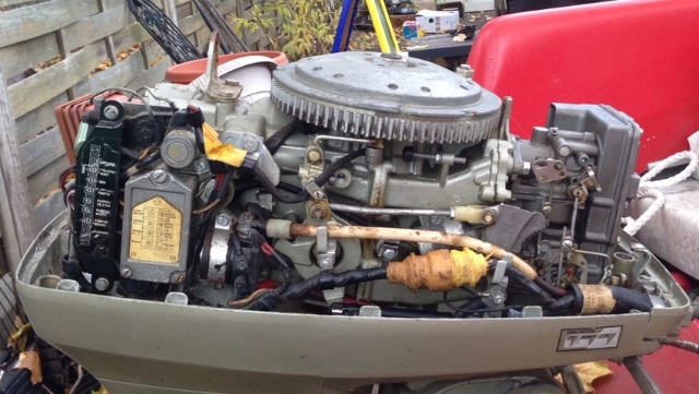

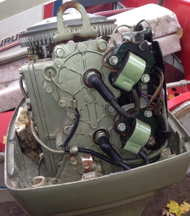

1972 Evinrude 80273c 50 hp 13 years 5 hours ago #86087

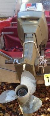

The outboard came with a boat that I bought. The previous owner stared it was working several years ago. I took cover out and tried to turn the fly wheel and will not move. Same with propeller. It might be seized. So my am question is shall I take spark plugs out and spray wd40 in them over a week and see what will happen? Any advice will be great.
Re: 1972 Evinrude 80273c 50 hp 13 years 5 hours ago #86090
The lower unit should be in forward.
That is the way it is when motor is not running.
You should be able to move the prop a bit the way it is.
If not then take the lower unit off and see where the problem is.

Re: 1972 Evinrude 80273c 50 hp 12 years 11 months ago #86154
Sometimes if you keep the motor tipped up like in your photo and put transmission fluid in the cylinders for a few days she will loosen up the pistons. If your crank is welded you're pretty much screwed into a complete teardown.

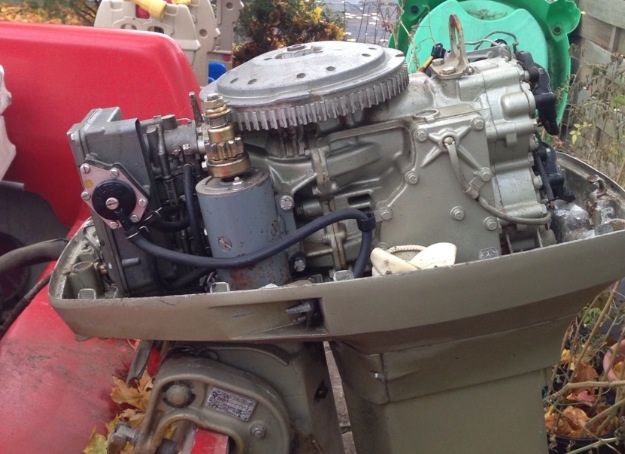

Re:1972 Evinrude 80273c 50 hp 12 years 11 months ago #86182

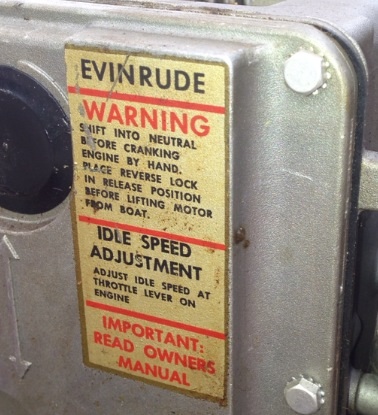

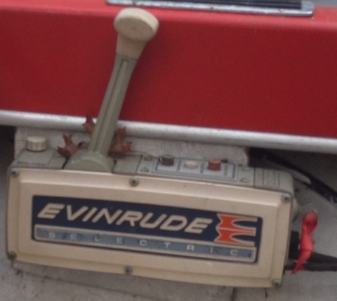

So I took the cover out today to inspect the motor. It is freezing here in NJ. Toolkit the plugs out I have a small light that fit inside the spark plugs location, looked into cylinders All clean no rust just carbon deposit. Looked around and if states in. 2 places to put it in neutral before starting engine. I am assuming that for the lower unit to go in Neutral if needs to be connected to the battery. I found another article that states that when outboard is off it engage into Forward.
So the magic question is do I need a battery?
Re:1972 Evinrude 80273c 50 hp 12 years 11 months ago #86192
What they are saying is that you have to select nuetral on the control !
Even with the battery hooked up the motor will still be in forward !!
It is not until the motor makes about one revolution that it kicks into nuetral. ---Simply put that is the way it works on these " Hydro-Electric " lower units.
It DOES NOT SHIFT UNTIL IT IS TURNING whether that is with a rope or with the starter motor.
So just once more --Proper oil must be in the lower unit and full.--The battery must be hooked up.
Nuetral selected
Key turned on
Then when motor turns it kicks into nuetral after one turn with a rope or starter motor.

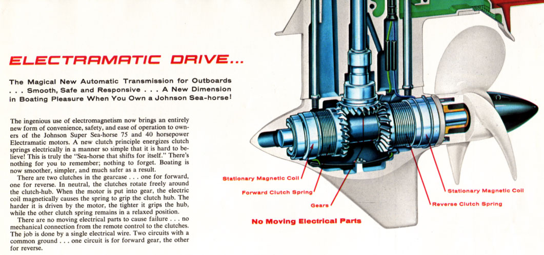

Re:1972 Evinrude 80273c 50 hp 12 years 11 months ago #86197
I must add to what the professor said by "proper oil" These selectric lower units function with magnets. You shift into neutral and it powers an electro magnet that pulls/pushes the gear away from the forward set of teeth, same with reverse, shift into reverse and a coil magnet pulls/pushes the gear into position. That being said you cannot use regular lower unit (gear) oil. It must be the proper lube for the electric lower unit. All OMC dealers should carry the stuff and I know that some of our local "farm" stores also have it.
Cal
Re:1972 Evinrude 80273c 50 hp 12 years 11 months ago #86199
Sorry, there are 2 solenoids in the lower unit.-These solenoids operate valves.----When motor is turning the oil pump provides pressure to move the shift piston according to what is selected ( nuetral and reverse ).----The shift piston pushes on the clutch dog to do the shifting.
These units are elegantly simple and very reliable too.
Re:1972 Evinrude 80273c 50 hp 12 years 11 months ago #86207
OK. I concede, I was thinking of the old model 800 I/O I used to have many years ago.
Re:1972 Evinrude 80273c 50 hp 12 years 11 months ago #86209
In the above electric shift the magnet pulls / drags the spring.----The spring then wraps itself tight around the drum to do the driving.---The gears / springs are meshed and spinning all the time when the engine is running.
The drum is splined to the prop shaft
Also elegantly simple and reliable too.
