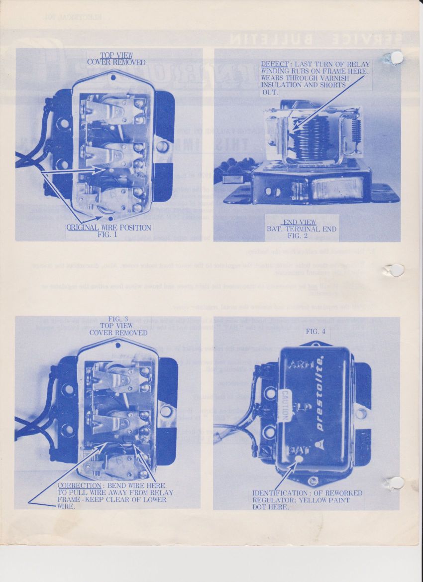

If you have a '70 Lark, there is a service bulletin issued that may explain the short- bad voltage regulator:
