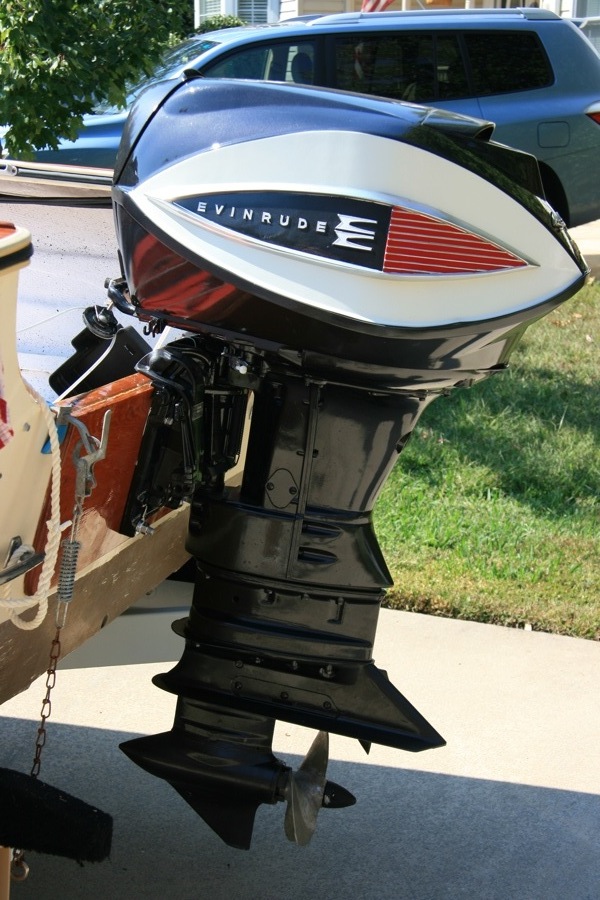

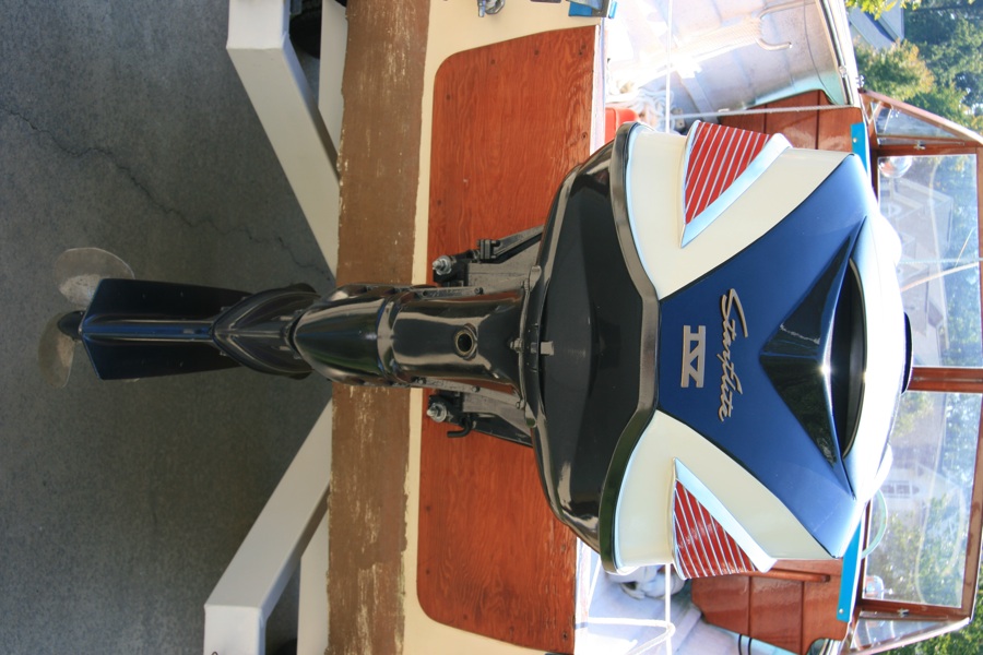

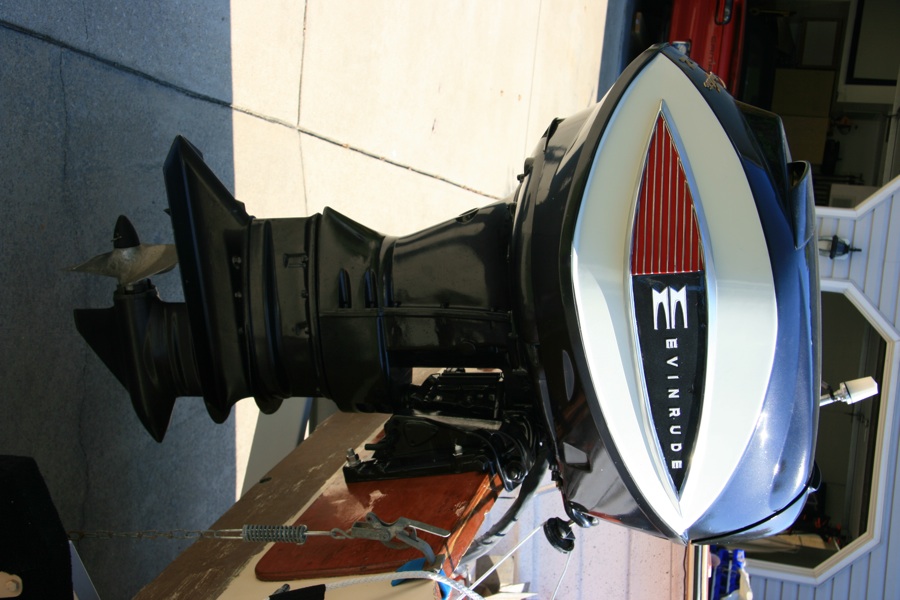

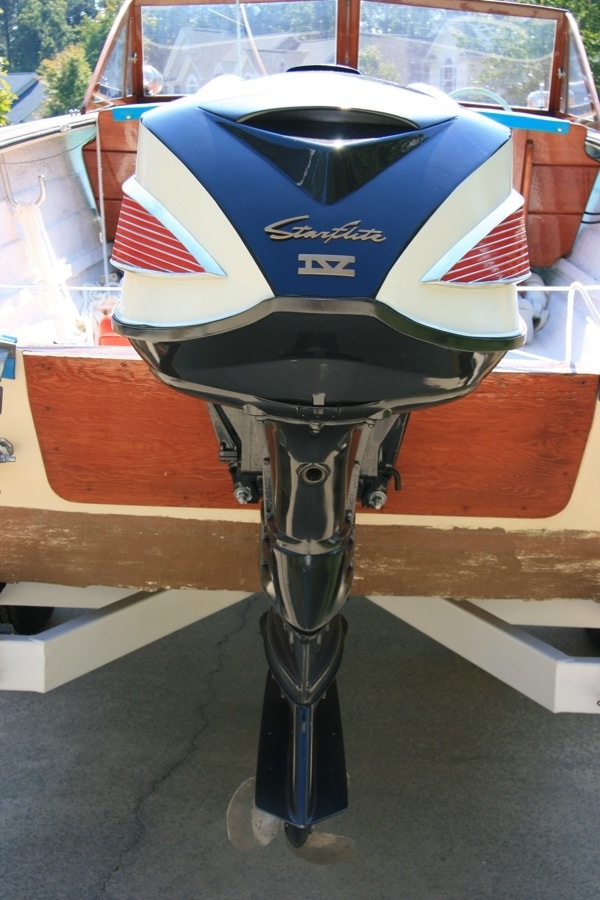

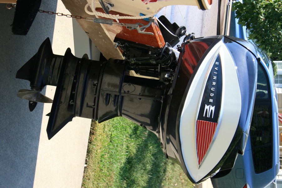

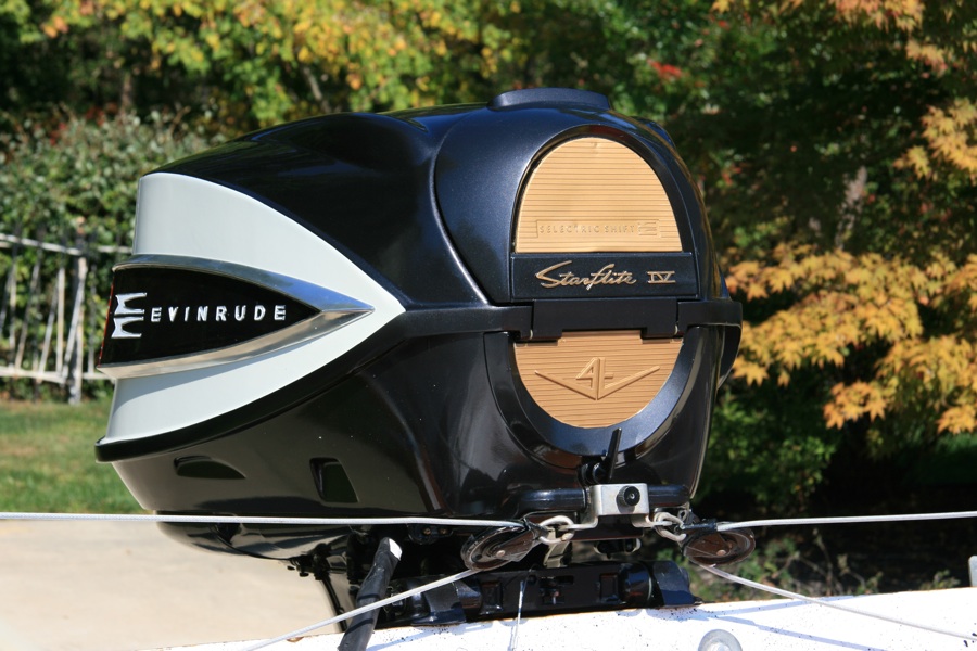

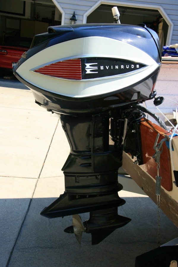

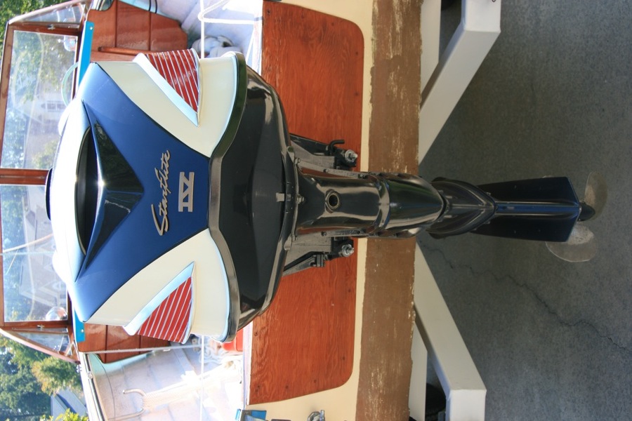

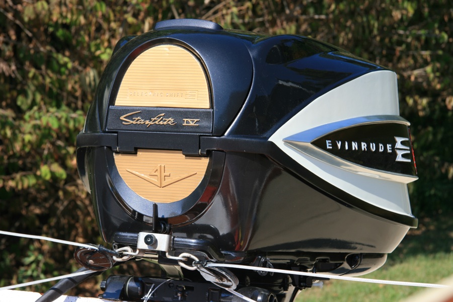

Well it's finally done. For clarification I put the '67 80 hp inside the '62 75 hp housing to make it more period specific since the 75 powerhead was bad, compression was about 65 on all four, so it's a spare parts motor for the 80.
Probably not the best paint job on the cowl emblems. Looks good from 10' away or so. ;) That will be a winter project to strip and repaint them. God enough for now though. Now I just have to get it wired up. It runs well. I replaced the points and condenser just because. I'll keep the old ones as spares if needed. Now I just have to get her on the water and tweak the high speed jets with the old tach/dwell meter I have.
Here's the pics.

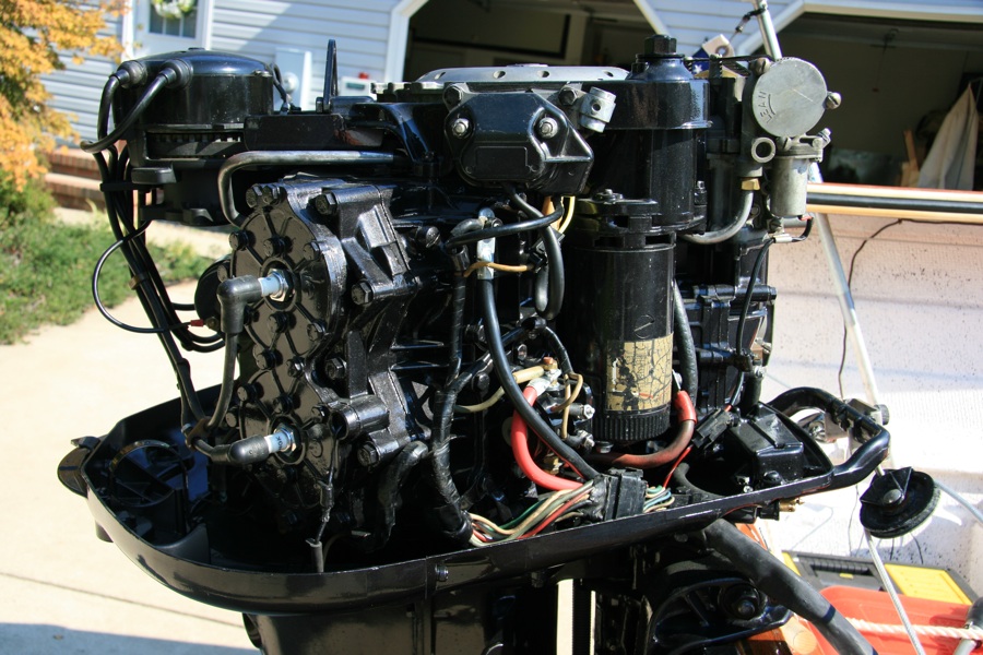

Here's the inside shot:
Now I just have to see f the current prop will work ok. It came with it but I'm not sure what diameter and pitch it is. I have to look it over again and see if I can find a part number. i also have a PJ76 10 1/8" x 11 but it's beefier than the one that's on it so not sure if it will work or look right. The spinner tip on the current one that's on is smaller then the face diameter of the PJ76. I guess I'll know once I get it on the water and check the rpm's.

Wow, thanks guys. Trust me if I took a close up you'd see the flaws.
Proff, thanks, wouldn't be the first time I got those backwards! So I guess the key will be to prop it to keep the RPM's below 4500 max then?
Jim, believe it or not I sprayed them. Lots of tape and a sharp exacto around the letters. Problem is using the 2 part paint and NOT using self etching primer, when I pulled the tape off in a few spots it lifted the paint. Had to use a brush and creatively touch it up in spots.
