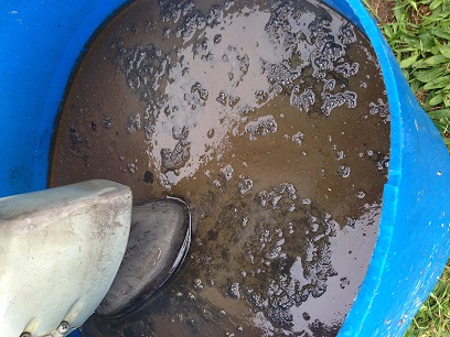

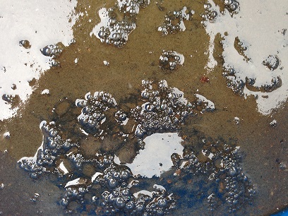

Last.... I have attached some photos of the water consistency after running in the test barrel.... my concern is the greyish bubble clusters, which I believe to be churned up unburned fuel and oil. Is this normal?

Stuff in the barrel looks fairly normal for a motor like that after 15 / 16 minutes of running.

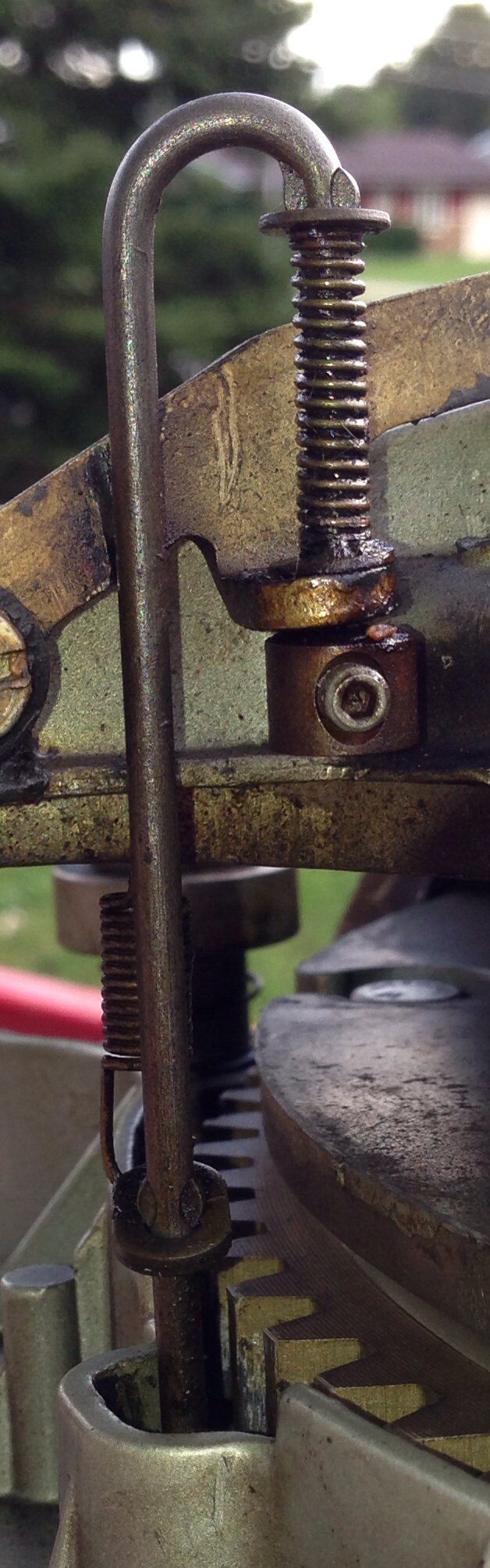

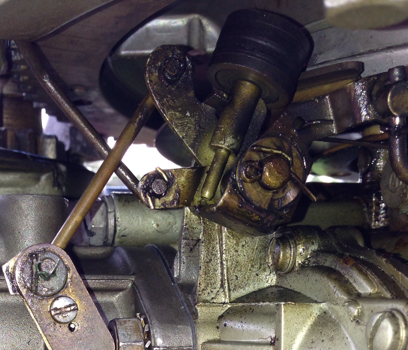

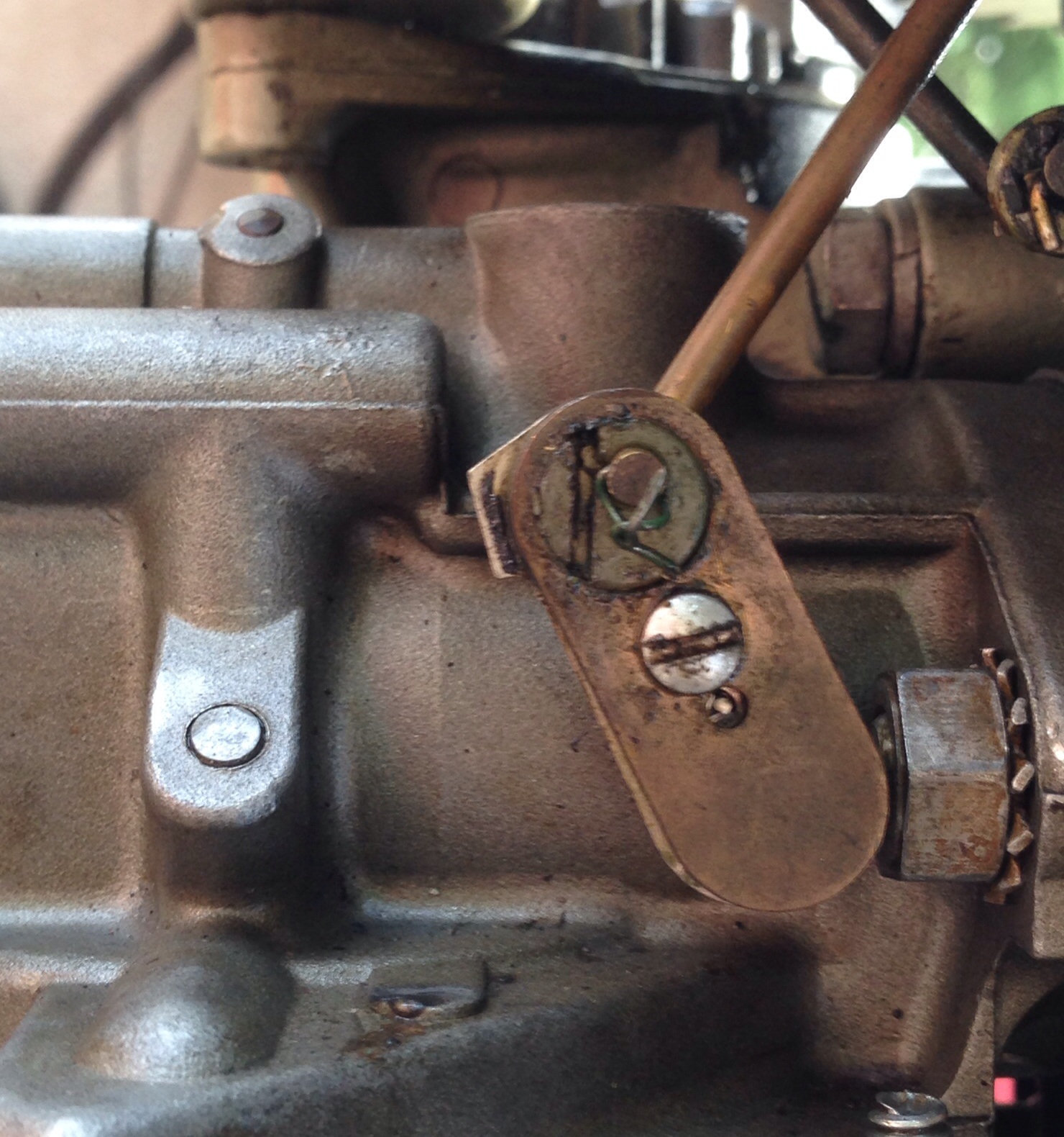

Here are some pics of that rod with the throttle all the way back. I noticed the plate in the carb was all the way open in that position. Is that normal?

Rod

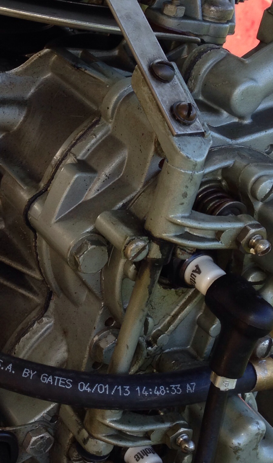

Professor.... I really appretiate your help with this. I'm just not motor suave so I'm trying to figure out what exactly you are looking for. On the carb, there is only one connection on it that goes anywhere. Which is the arm in this picture. It connects to the lever(s) at its upper right in the picture. From there, there are only two options, either back to the throttle connection, or to up above the flywheel, which is in the next picture here. These pictures are all with the throttle lever in the idle position.
If this still isnt what you are looking for can you give me an example so I know what it looks like?
And I checked the spark. It will jump 1/4 inch gap.

Upper rod

Upper rod.
Other than this, all the other rods can be seen in the other pictures that i posted in the thread.

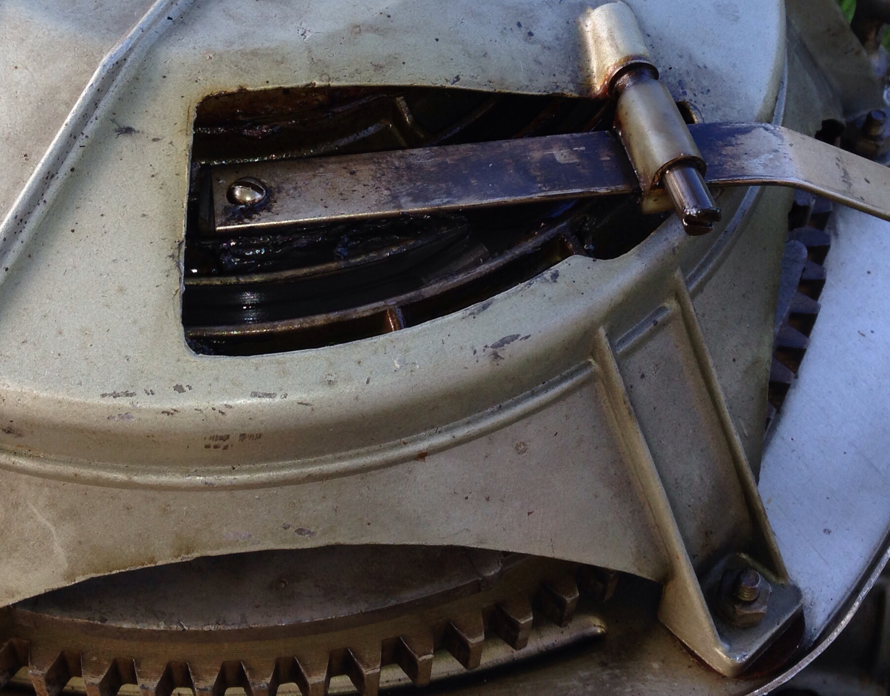

Re: '59 Lark 35 update (carburetor ?s) 13 years 1 month ago #84674
You have now posted a picture of the interlock
It is designed to prevent you from pulling it over with too much throttle applied.
It is NOT at the back of the rod going to the towershaft.----Sorry, I do not think I can help any further here.
