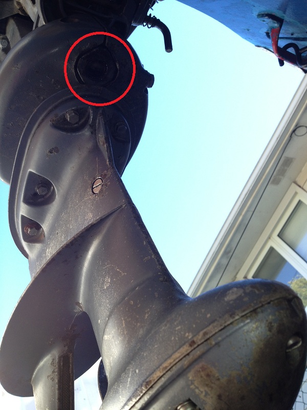

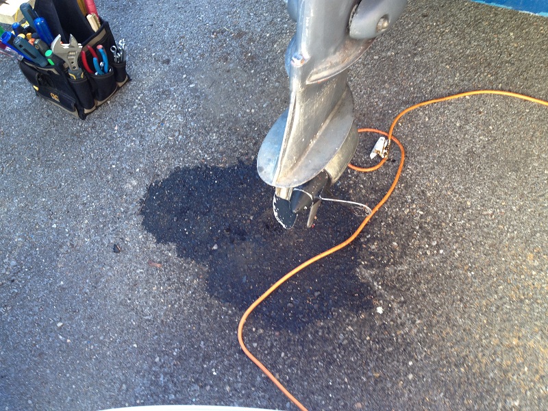

Emptied out the lower unit and finding instead of gear oil, rusty water and gasoline i think. (and not very much of either). I filled it up with fresh oil and took it it down to the lake for a test fire. no go because the fuel pump was toast so i replaced the pump. Fastforward 24hours, I am about to take the boat down to the lake for another attempt to get the rebuilt carb dialed in but before i go i notice a dark spot on the driveway. it looks like some very dirty oil has run out of the....huh? take a look at the pics. any ideas why this happened, if thats my gear oil? am i missing a seal or plate or something there? ive circled in the photo where the oil seems to have leaked from.

could this possibly be gas from excessive flooding due to improper float setting on teh carb? its breaking down the asphalt last time i took to the lake i flooded it really bad and later that night confirmed float wasn't closing valve to its seat.
also just drained the lower unit, looks like all the oil i put in it was still there!? had an orange/brown color to it
Re:Evinrude 33 ski twin more problems 13 years 1 month ago #83725
At this point I would just get it on the lake and get it running at it's best. Once you have it set up and back home drain the LU and see if the fluid is all milky or nice and clear like it should be. If it is milky take it apart and put in a seal kit then try it again. These old motors drip all sorts of weird looking stuff and most of it is of no concern! The flooding can certainly cause the fuel to drain down inside the exhaust casting and drip black stuff. Let us know how it does on the water.

That red circle is way above your upper oil plug. There is no lower unit oil that high.

yes It had to be gas on the ground.
