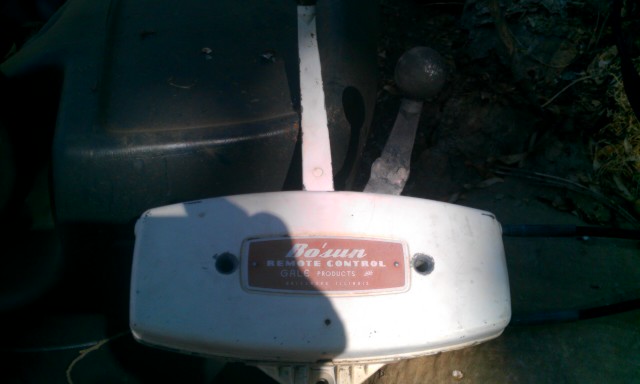

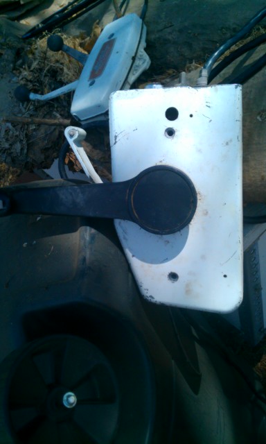

I fremoved the 40Hp Lark today and will install the Johnson tomorrow. I have my choice of 2 control units a Gale twin stick control that came off an old glastron on my property in Texas and a single control unit from the bass boat the one off the bass boat has no cables. Do you think it is possible to wire the switch on the dash from th 40 to the 70 and use the twin stick Gale control.

Next question control cables. Atre the cables used between the two remotes the same. I ordered type 400 cables as the motor is a pre-79. However after googling some more they show the 479 cable for the Johnson single lever remote.
