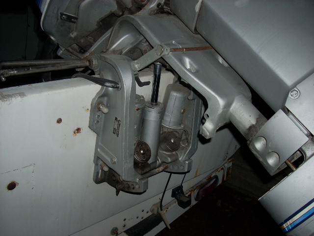

I have a '79 85hp Rude and leaks but is quite small of a unit as you can see in the pic, self contained with motor and all, seems very compact. Wonder if it could just bolt on to yours? I dont know what trim and tilt is opposed to just tilt? Whats mine below if anyone knows...On the throttle theres a button for up and another for down, or maybe a rocker switch?

Trim and tilt can be used to adjust the angle of the motor at full throttle. That is done by the 2 short rams.----The middle cylinder is the tilt cylinder. Magic check valves and such direct the flow of fluid.
A " tilt only " unit can not be used at full throttle.
Only a muscle saver when boat is moving slow ,stopped or on the trailer

Interesting, i thought the two short rods were like dampners ;) So much for brain cells.... I saw the parts list diagram, lots of parts in a small package :( . If known, when motor goes down slow on its own is it usually the O-rings or valves, think the valves are a bit pricey as i remember?

The 2 short rods / small cylinders are the trim cylinders.
2 cylinders are needed on these units to deal with the loads of the motor pushing against them at full throttle.
Interestingly that same trim and tilt unit works on the 235 HP V-6.
