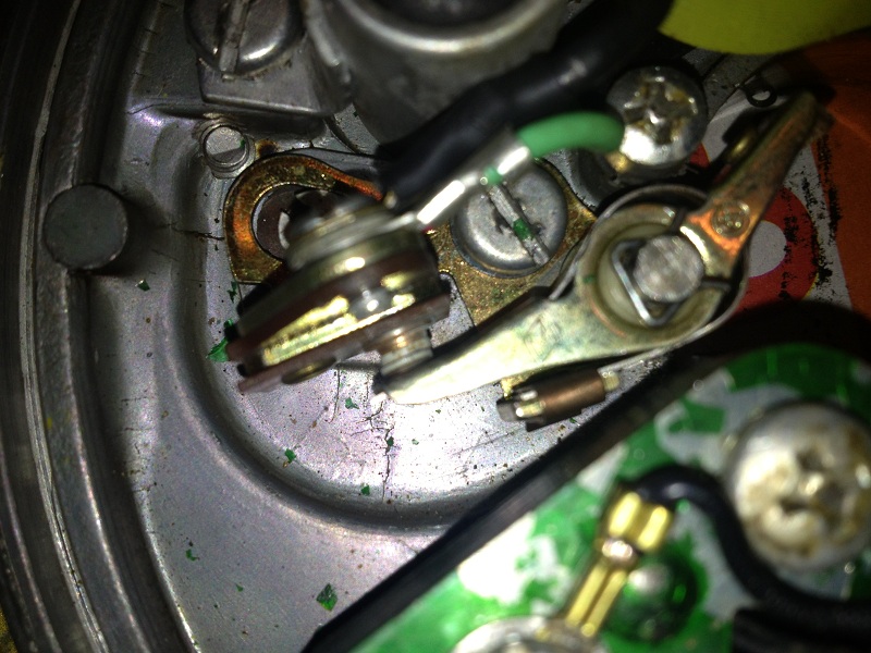

Finally got the flywheel off. :laugh: It was a scary experience, used a harmonic balancer puller, and because the bolts that came with the puller were all to large in diameter, i had to buy some bolts & washers (1/4"). I was worried that the bolts i picked up would snap off flush with the top of the flywheel. I got to the point where i could barely turn the wrench with all of my strength to get the puller to get the flywheel loose. When the flywheel finally did let go of the crank shaft i was convinced i had snapped the bolts on the puller, but thankfully not.
Anyway, heres a pic of the breaker points , i was only able to get resistance down to 1ohm and stupid me I didn't check resistance before cleaning so i have no idea if it is an improvement. I used what i had to clean them, q-tips and sensor cleaner. I also tried soaking a piece of cardboard from the inside of a roll of paper towels. and rubbing it back and fourth between the points. Also performed a visual inspection of the coils and condensors. Discovered today that my new meter doesn't measure capacitance :angry: I used to have a real nice clamp on meter worth a couple hundred bucks, then I lent it to a guy at work and he quit and moved away!
I guess i should probably replace points but will try it out the way it is now first. -tomorrow after work, damn this fleeting summer sunlight. I'm going to have to start working with a trouble light if i want to make any real progress through the week.
Re:1965/68 Evinrude Ski Twin, ignition wiring issues. 13 years 2 months ago #82099
That " u-shaped clip " that holds the spring is not installed the way it was at the factory.----Just a minor detail , it is always installed horizontally.---Are the coils cracked or were they replaced already ?

Re:1965/68 Evinrude Ski Twin, ignition wiring issues. 13 years 2 months ago #82124
Both coils have been replaced !----The green one may be aftermarket and the blue one may be an OMC replacement.
No need to go into testing the coils with an ohmeter.
Just make sure the points are clean and set at 0.020" to get spark.----You can use the timing marks found on the flywheel and magplate to do just a little better job of setting up the magneto.

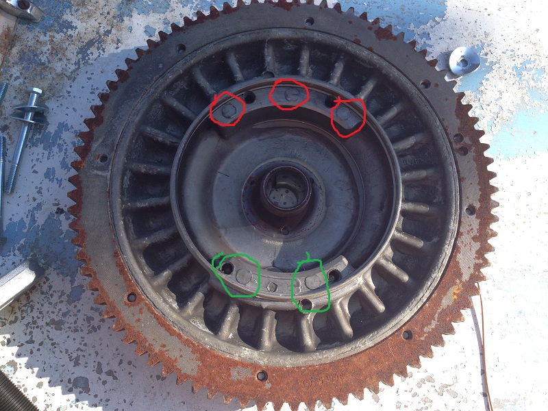

Well its all back together but no spark on either cylinder :angry: I need an oiler wick anyway which i will have to buy a set of points just to get. hopefully new points will help, Im tempted to just get new coils and condensors too.
But what if its not the magneto?
Is there any chance the flywheel magnets are pooched? if i look at underside of the flywheel there appear to be 5 magnets. (2 on one side, and 3 opposite across the flywheel) If i move a piece of metal (a bolt) near the 2 it gets drawn to them, but the 3 magnets i cant feel a magnetic field.
Im having difficulty understanding timing as well, could that be a factor in this particular -no spark- problem?
it appears that the laminate was rubbing the inside of the flywheel , could that have cause this problem?

Re:1965/68 Evinrude Ski Twin, ignition wiring issues. 13 years 2 months ago #82551
There is only one magnet (with two poles) the mass on the other side is probably there to counterbalance the magnet.
Have you tested the coils and condensers with an ohm meter?
If you put in new points, make sure to clean them (sliding a clean biz card dipped in acetone between the closed points).
I don't tighten down the flywheel until I get a .25 inch blue spark on each coil roping it over (with just a rope on the flywheel). Much easier to pull it over with both plugs out, but make sure you ground the spark plug wire on the side you're not testing...
