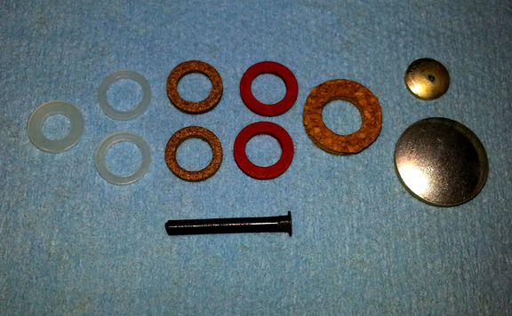

Rebuilding the RDE19 carb. Got an OMC carb rebuild kit, but need a little help with the washers/packing. The high speed needle had the remains of two black fiber washers but the low speed needle had no washers. It looks like someone's had the needles out at one time. Anyway, I know these kits cover several carbs and I won't need all of the parts, but which of these go in the high speed and which go in the low speed needles? It's an OMC 439075 kit with float. Here's a pic of the selection.
Thanks! Dave

It looks like you haven't had a reply yet, so here's my two cents. I am not an expert but I am rebuilding an old OMC carb now also. This is what I have; a Sierra kit for a 1960 40 hp. The packing washers (tan colored) go in both high and low speed, inserting them first and then one of the plastic washers on top of the packing on both high and low speed. My carb had a lot of packing in each speed, and the kit has several new packing washers, so I have installed more than one in each. Again, I don't know, I am working my way through this with only the help of the guys on here.

Thanks Mike, I ended up using the two brown washers and a nylon washer in the low speed and two reds and a nylon in the high speed. I was going to do one of each in each side but couldn't get the reds into the high speed. Seems like they were just a hair too large and not flexible enough. My Seloc manual says to put two fiber washers in the low speed and three packing washers into the high speed, but never really explains the difference. So I punted. Both needles seemed to seat fine and have resistance when turned, so we'll see how it goes. Gonna be a few weeks before I'm to the point of firing her up so I'll update later on. Thanks for taking the time to reply, much appreciated!

The main function of the packing washers is to keep the needles from turning by themselves.

The Sierra kit I used had six fiber packing washers, and my carb had a lot of old packing in each so I put three in each with a plastic on top. These are the details I get hung up on due to my lack of experience. I realized that I can't assume that after 53 years no one else has been into this carb and engine
