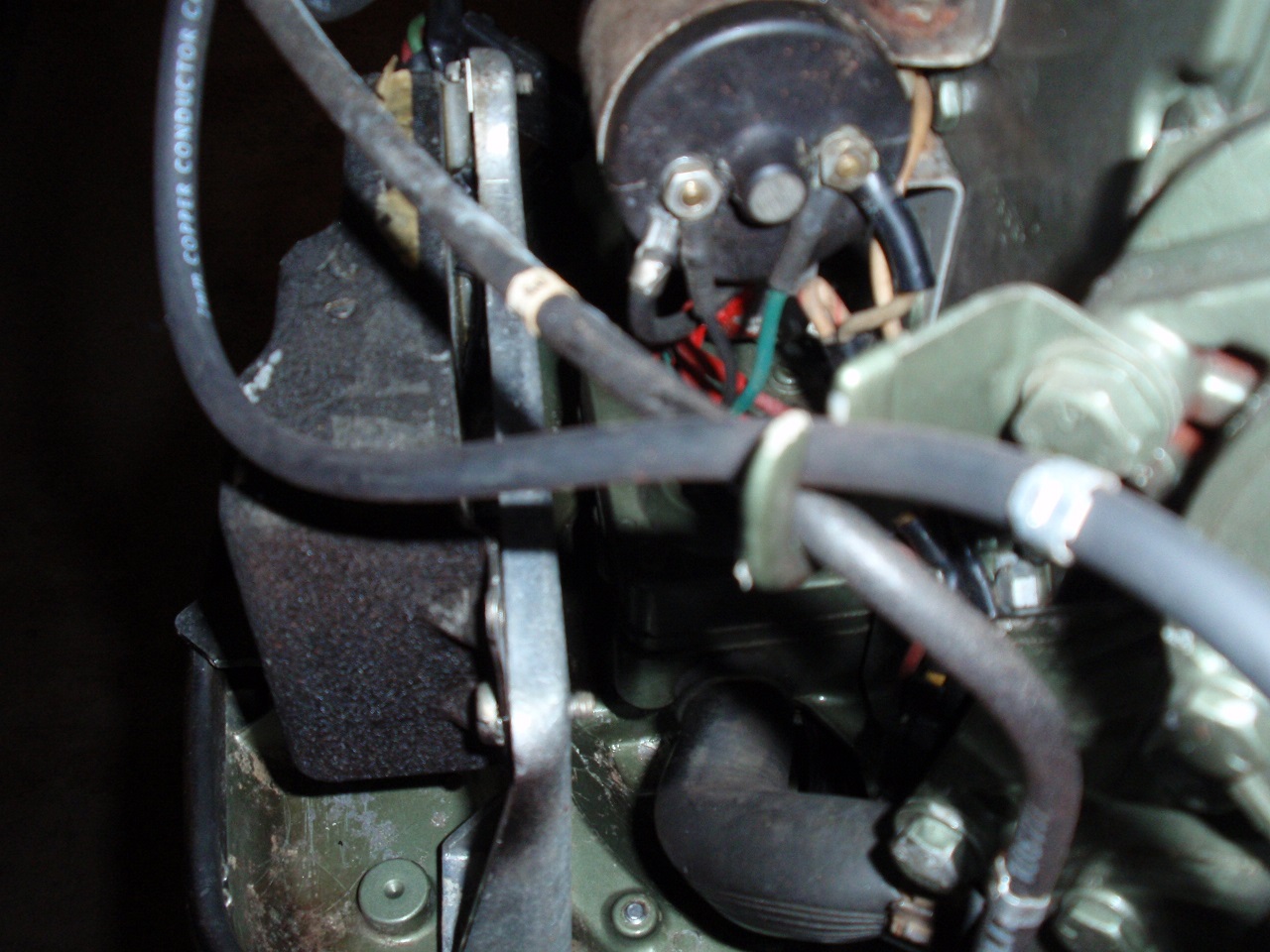

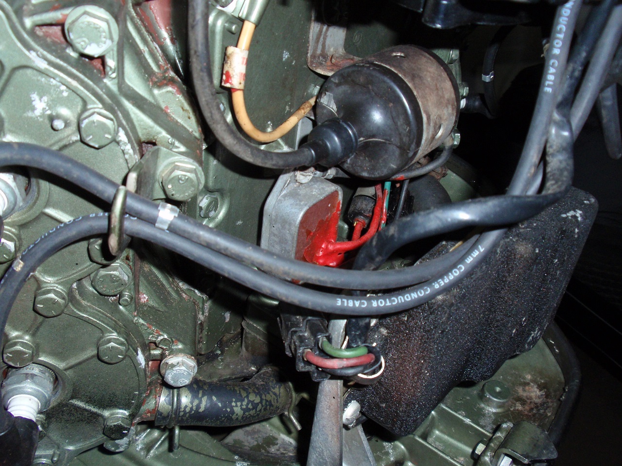

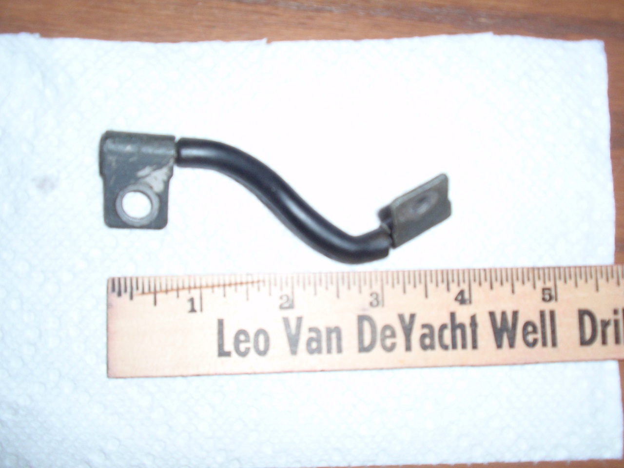

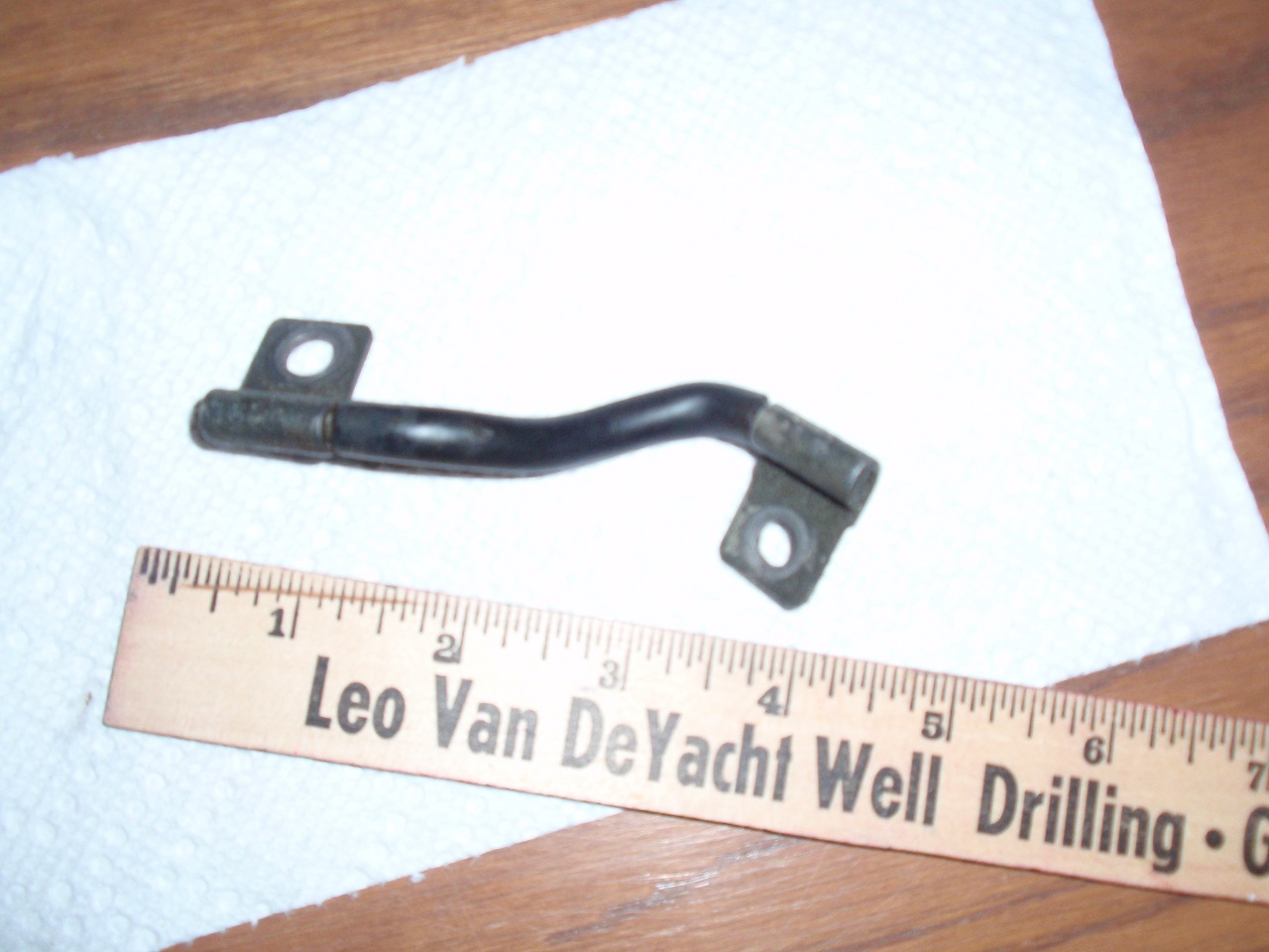

I'm putting the wires back on a Johnson 100hp golden meteor and have an extra wire left over (always the case). Looks like a ground wire for something and must be somewhere around the solenoid or starter. It has a natural curve to it and the terminal holes are just large enough to fit on a case or carb cover. Anyone have a suggestion?

The start relay is grounded via the neutral safety switch, so it's not for the the relay. Is the engine a 1967 or 1968? The 68 had the power pack mounted to an aluminum bracket at the rear of the engine. It had a couple ground wires from the power pack to the frame. Be very careful with the CDI pack - be sure the battery terminals are correctly connected and firmly attached. Any spark or faulty connection when the power is on will likely blow the CDI pack.
Re:A little help please 13 years 2 months ago #81731
Bruce, thanks. It is a 68 with the power pack mounted in the back. I had to remove the pack to replace a cooling hose so I'll check all those bolts. By the looks of the terminals there are marks of lock washer so I'll look for a connection from the pack to the head.

Cal,
By chance, did you have the flywheel off to work on the timer? Also - according to the OMC wiring schematic, there should be a ground jumper from the negative post on the coil to the engine block. This could be where the vire goes - between the negative terminal on the coil - then to one of the screws on the coil clamp. Are the holes the right size? If there is not a ground jumper on the engine - that is likely where it goes. Should be 16 gauge black wire with two eyelets - which describes your part to a "T"
Re:A little help please 13 years 2 months ago #82933
Bruce, No, I did not remove the flywheel. I'm looking at the wiring diagram for a '68 100hp with CD ignition. Just so happens that there is a big grease slug over the area you are talking about, the pulse transformer, is that the "coil" you are talking about? The holes on the large black wire are smaller.
