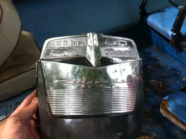

Does your engine happen to have the chromed metal door that closes over the carb controls and the pull cord?

Re: Hand pull compression for a '56 lark? 13 years 3 months ago #81048
Yep! It's in okay shape (pic below.) Pretty faded, and someone cut a chunk out of the top of it for some reason. Also, the shift cable clamp looks like it broke out of the motor housing, and they drilled new holes for it not once but twice.

Re: Hand pull compression for a '56 lark? 13 years 3 months ago #81196
Someone has chopped the top of the front door off. It had a pointed area that covered the hole for the pull starter cord. You are lucky to have any of the door at all - most of the time they are missing.
