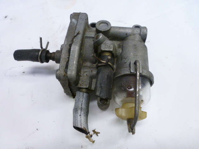

Does your fuel pump look like the one in the picture here?
If so - then this is the kit you need to repair it. OMC part number 379777 Sierra part number 18-7801-
Do not repair it with a new old stock part that has been on the shelf for many years. Get one that is newly manufactured, as the rubber is designed for modern fuels
If the pump looks different - please photograph it & post it here. Ebay will nearly ALWAYS be your best place to go for parts. I purchase repair parts from ebay nearly every week - and I have had very good service from most ebay parts sellers. You certainly can't beat the prices. In fact, I just ordered a kit from the link to the Ebay seller.

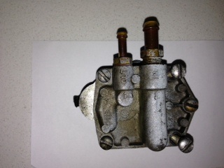

Thanks so much for the info for the old/new fuel pump. I had ordered the original part from a seller on Ebay which i have not received yet and will try to return.
Here is a photo of my fuel pump, i entered the original part number (#304089) on marineengine.com and found out that this part was replaced with a new model part (#388685).
I found this part in a Johnson dealer and installed it yesterday.
I went for a quick ride and it seems to work well.
As you will notice on the photo my fuel pump does not have the sediment bowl attached to it.
Do i need to install a new sediment bowl?
Also i'm looking for a low smoke oil to mix with the gas. I don't like the smoke and smell coming out of my motor.
Do you know if a type of oil exist that would be compatible with this 1958 motor?
Someone told me to add Lead Substitute to the gas - saying that these old motor run better with lead.
Thanks!

OK - your motor uses a smaller fuel pump than I was thinking.
So did the engine run better with the used pump from the shop?
As for Lead substitute, no do not use it on your engine. These engines did not require lead in the fuel, in fact, the manufacturer advised against using leaded fuel. Leaded fuel is important for old 4 cycle engines that use intake and exhaust valves in the combustion chamber. The lead helped to lubricate the moving parts. Your engine does not have these parts, so no lead needed. Leaded fuel can actually harm a 2 cycle engine by causing deposits to form in the combustion chamber and on the exhaust ports.
Keep in mind, that when your engine was built, the oils available for 2 cycle engine operation were very basic oils for car engines. The fuel to oil ratios shown in the owner's manual and inside the hood of your engine were based on mixing gasoline with 30 Wt. non detergent motor oil. The modern TCW oils for water cooled 2 cycle engines are superior to the old oils - therefore less oil is needed to do the job. I can not say what the proper ratio for your engine would be - but I believe 32:1 (1 part oil to 32 parts gasoline) would be adequate. Don't take my word for it though, ask a reputable shop what they recommend for the engine.
