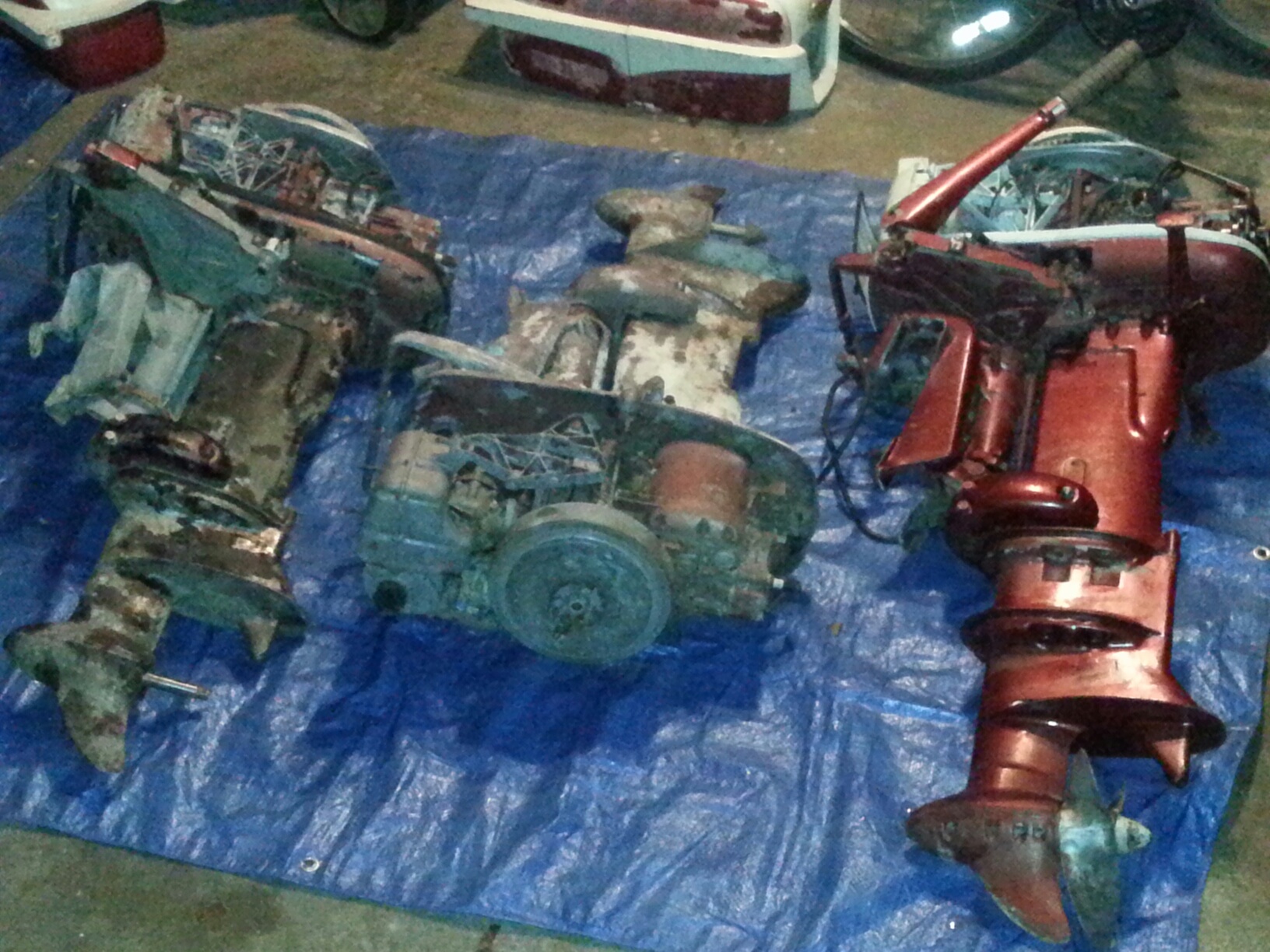

Just had to share, the wife's not up (not that this would impress her)!
Drove two hours tonight after work to check out two '57 Johnson 35hp's. One was supposed to be near mint, the other a likely parts donor. The "near mint" turned out to be a long shaft RDE-19 (maybe a 6 rating on a 10 scale) and a short shaft Evinrude (Lark?) 25532 also a 35 hp. I guess I was a little disappointed that the near mint wasn't so minty so then he says he could throw in the other old motor he has... Turned out to be a 30 hp RD-18. The RD-18 is in the middle of the pic.
Plans are to do some swapping with the "good" RDE-19 and convert it to a short shaft and remote steering (it's a long shaft and tiller) with parts from the Lark and add a fuel pump. I'm thinking if I remove the 5" extension from the long shaft and switch out the water tubes and shaft it'll work out... or is there more to it than that? Cowl needs paint too. The pull rope also doesn't retract, but that's minor at the moment since it's electric start. Will look good with the Invader, if she's ever finished!
But I have no plans for the RD-18. It isn't frozen but that's about all I checked on it so far. It's a sweaty one, definitely a fixer-upper. Will probably go to a good home at some point in the future.
Now to figure out how to break it to the wife I came home with THREE motors in the morning!

After a little cleaning and closer inspection, I'm thinking that I don't have two 35's and one 30hp. It looks like I have one RDE-19 35hp and two RD-18 30hp's. One of the 30's had a swapped out transom bracket on it with an Evinrude Lark 35hp tag on it and its freeze plug number doesn't match the transom bracket number. If you look at the two "parts motors" in my pic you'll notice two have the smaller, rounded flywheel and the RD-19 has the larger, toothed flywheel. And the intake baffles on the two powerheads are different than the RD-19's. But back to my main question: if this is true does anyone know if I can still go with my plan to change the RD-19 long shaft to a short shaft by removing the extension an swapping out the shaft/water tubes, etc with one of the two RD-18's? From the outside, the lower units look identical... same bolt patterns, size, etc. I haven't busted in to them yet and won't be able for a few more days, just figured someone here has tried this.

What you need to do is not change Lower Units (LU) however take the 5" extension out
Here you will take the drive shaft and the shift rod out of the 30 hp.
The your paint will still match and all will be OK.
Changing the shift rod will require you breaking the LUs apart, however that is no biggie, and while apart you can clean check things out.
You will need a new Spaghetti seal that you can enough to do 5 or 6 motors here
