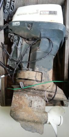

Guys a have a chance to pick one up for $100.00. It supposedly ran when pulled off. It's is rough as the pic's show. Cables and wiring were cut as well but included with it. So what's your thoughts on cleaning this thing up and running it? Model# 125ESL71 It would be used to eventually replace my 850 Merc on my 74' Silverline.

A very good motor in its day.
Has an electric shift system that is scoffed at by many folks.
That " Hydro - Electric Shift " system is actually very good and reliable.--The battery powered electronic ignition system is a nightmare of expensive parts as well.----If you have tools / know how / manual ,it might be worthwhile.
If you have to rely on the marine shop you might want to look for another motor.

It looks to have sat in the water on perhaps a patio boat, or some boat that then never tilted the lower unit out of the water. The skeg is missing a few chunks where the engine has bashed int rocks. Be sure it is not a salt water motor. Bolts that look rusty where the heads touch the castings suggests a salt water motor. Also, if the castings have bubbling corroded looking paint adjacent to the head gasket area, it's probably a salt water motor.
Be sure to do a compression check WITHOUT squirting oil into the cylinders beforehand. The check needs to be done on a "dry" cylinder. Compression when new was around 110 lbs per cylinder

too much corrosion for me,I would think its been neglected. a leak down test will tell all on top, i have had fitts with that ign system in the past. ide keep looking

Well I picked it up Friday on my way home. Good news is that it's not corrosion but rather someones piss poor paint job on the lower unit that is flaking off. No matter because it's gonna get painted. Other good news is that all the electrical was gone through and replaced about 5 yrs ago for the dates on the parts. Now to get my buddy to weld me up a stand so i can get to work on it. I do need to find an image or picture of the steering cable hook up and I need a throttle cable for it as well.
