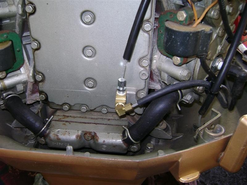

My experience on the Johnnyrudes has all been on the V4 CrossFlow motors, but the principle would be the same. Here's a pic of the current set-up I'm running, T'd off to run a tell-tale and the pressure gauge just as you described;

Marks, nice work there. I plan to do the same, why did you chose to install it so low? and do you think I need both a tell-tale and a gauge or just the gauge? I guess its double security? Did you get the T in a kit or did you get it from the local hardware store?

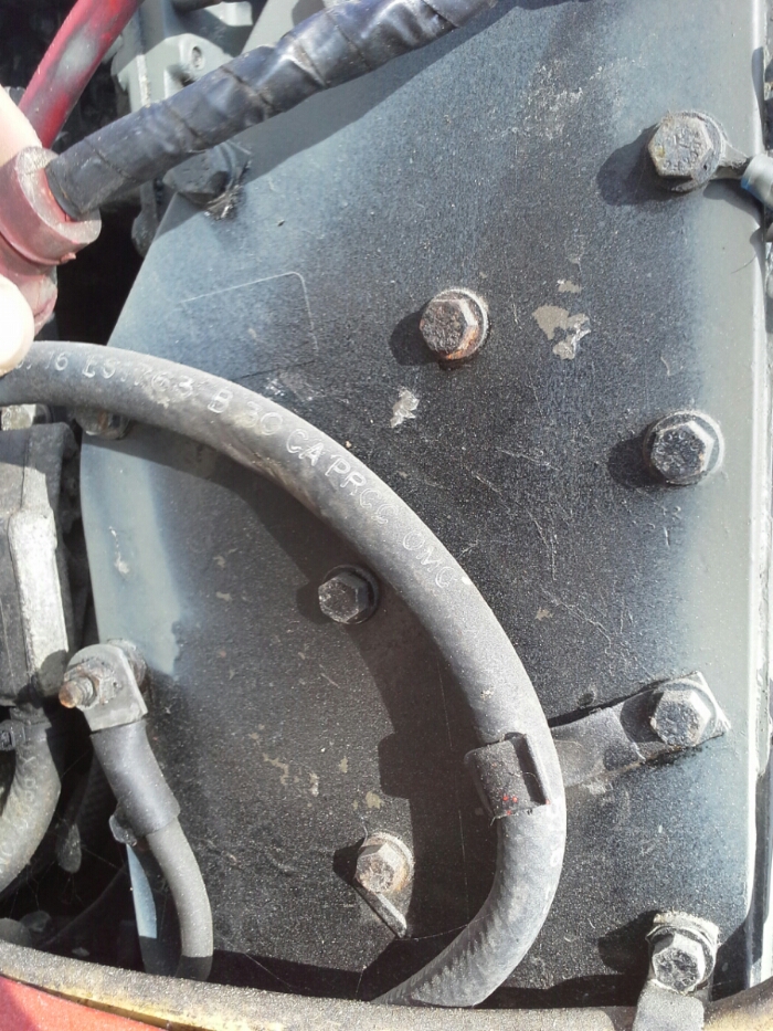

above is a pic of my motor

Thanks Jon, I ran the 1/8" plastic tubing through 1/4" rubber hose to protect it, acts like a sleeve I guess. (Maybe overkill?)
That's where the factory put a boss for the tell-tale on this motor, I just T'd it off to run a gauge as well.
I just like being able to glance down at the dash (the gauge) and make sure everything is working as it should be.
