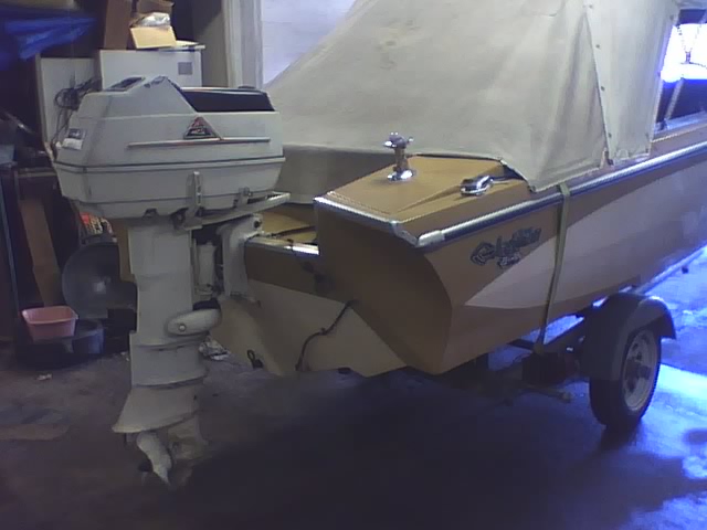

I finally got the '63 40hp Gale long shaft to the lake. I mounted it on my '68 Glastron 156 Aqualift. It ran good in the barrel at the garage, forward, neutral, reverse, no problem. I drove the 20 miles to the lake, put her in, started right up, but with the shifter in 'N' the L/U was in Reverse and had no Forward...??? I pulled her out and drove back to the drawing board... I discovered that the shift linkage had somehow pulled apart at the brass connector. So I put it back together with a new 1/4" NF bolt and tightened it up. Took it back to the lake and seemed to be working fine...except, when I was taking her up to WOT, it like hit 'neutral', I pulled back on the throttle, and tried it again... I was thinking maybe the center hub was gone in the prop...??? It ran ok at low speed, but when I tried to get her up on plane she 'free-wheeled'. I cruised around at low speed and then very gradually took her up to top end, seemed to go ok until I hit a wake, then it free-wheeled again... Is it the prop or the L/U slipping out of gear? The F-N-R seemed to function fine at docking, shifting back and forth, so I believe linkage is still connected...Thanks for any help
