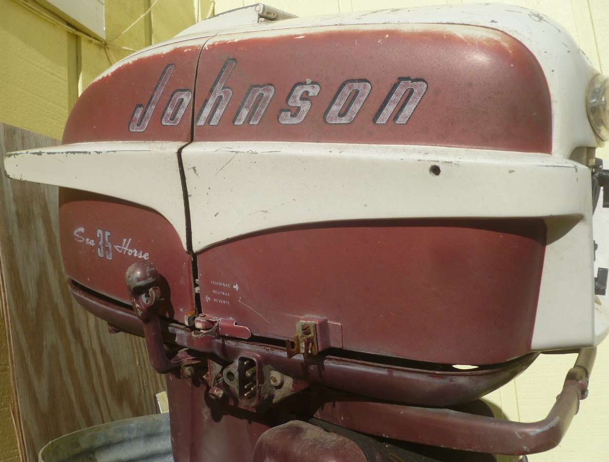

Hi, I have a question about identifying johnson sea horse motors. I want to get a manual to help fix mine up but don't know what kind it is. Im pretty sure its from the late 50s but not much more than that. Any help is much appreciated.
Re:1959 35 HP Johnson Spark Plug Torque 13 years 5 months ago #77945
here is a picture of it.
Re:1959 35 HP Johnson Spark Plug Torque 13 years 5 months ago #77959
  • ed-mc
  • Posts: 1482
  • Karma: 235
  • Thank you received: 131
Looks like a '57 to me!
Here's a model-year guide:
www.marineengine.com/manuals/johnson/index.html#j35hp
Re:1959 35 HP Johnson Spark Plug Torque 13 years 5 months ago #77982
I would also say '57, '56 was 30hp, my '58 35hp Super SeaHorse, is gold & white...these are great motors
Re:1959 35 HP Johnson Spark Plug Torque 13 years 5 months ago #77985
So do you know how I would find out the model number for it? I checked Johnson's website but they don't go back that far. This is a pic of the front part, has both a pull and electric start. Don't know if that helps. And how can you tell its a 57 as opposed to a 58?
Re:1959 35 HP Johnson Spark Plug Torque 13 years 5 months ago #77986
Here it is, had to scale it down.
Re:1959 35 HP Johnson Spark Plug Torque 13 years 5 months ago #77992
So after a bit of searching, I think it is an RDE-19. Does that make sense to anyone else? And does anyone know where I can get a cheap manual for it? The only one I found is 50 dollars, and another 40 for a parts catalog, though I'm not sure if I'd need that.
Re:1959 35 HP Johnson Spark Plug Torque 13 years 5 months ago #78027
You can download the manual on Andgott's website for free, in .pdf format;
www.agott.com/glassboat/manuals.html
