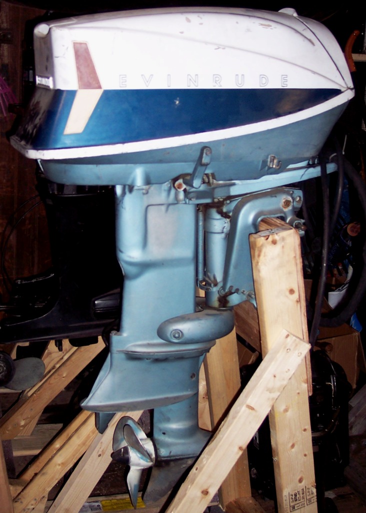

I picked up a 'new' motor yesterday, an Evinrude Speeditwin 28.
The model # is 28352A, which I believe makes it a 1963. It appears to be in great shape, and supposedly runs well, though I have not seen/heard it run yet. It's even got electric start. It was under $100, so I took a chance- It should be a good motor for my Lake N Sea unless I find a slightly older one that I like better.
Does anyone know about these motors? Good? Bad? I see that a number of the parts (carb kits, impellers, etc) are still readily available.
I found a 1964 service manual for the speeditwin- I am ASSUMING that it's the same as the '63 model, unless someone can tell me differently... I haven't bought it yet, I wanted to make sure that it would be for my motor, too!
Any input/info on the motor would be greatly appreciated!
-Andrew
