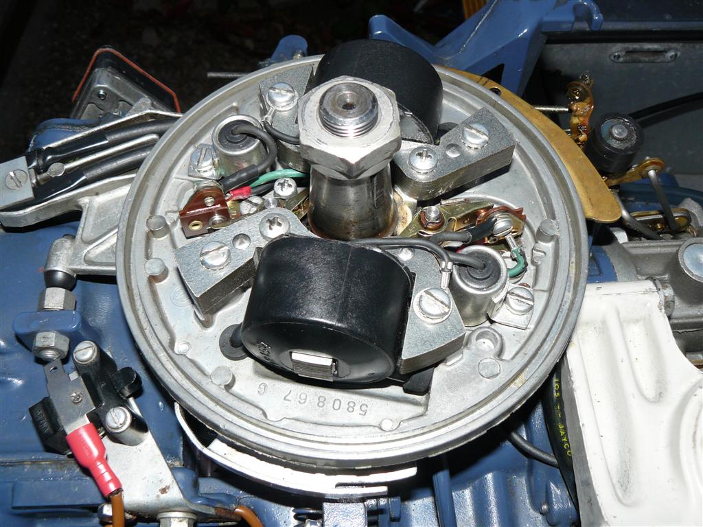

I have the pre '72 Norseman clearout from Evinrude Belgium, a model 40103 Ski Twin from 1971. It is a budget model that utilised the last Ski Twin 33hp parts with a 40hp block, adjustable low and high speed needles vs. the fixed high speed common on late model BigTwins and including a non shrouded mid-section, more in common with the late 50s 35hp BigTwin and might have run a tiller arm at some stage as it has an open end without the start/slow/fast hand throttle. I cannot get it to run properly and believe it to be a synchronisation issue now, but need some advice as the marks all appear to be correct. It will not throttle fully out to max RPM and sounds as if the ignition is retarded, plus the throttle stop is not fully home against the stop at WOT. I have newly fitted a fuel pump, carb kit, coils, plugs, condensers, points, pump housing, impeller - the usual service items - have cut back the HT leads and get 4.5ohms on a resistance test and checked the anti-pop too. Compression is 130 on both cylinders and it's run on a a diet of 50:1, but consumption is very high. It's very possible that someone has fiddled with the motor settings, as it was at least 2nd hand when I bought it, but in largely unmarked condition - i.e indicating that it's life had not been hard. Anyone with knowledge of this hybrid? I've run out of ideas.. even entertaining a check that the throttle arm was not bent.

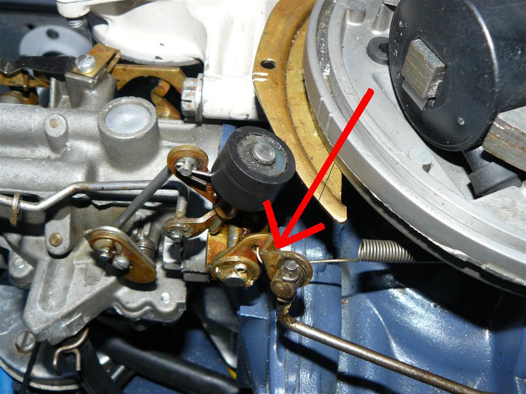

Post the same picture as in the first post, but with the control in the slowest idle position.

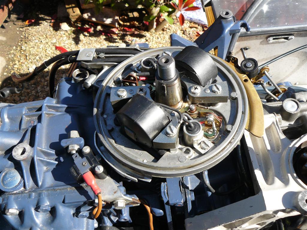

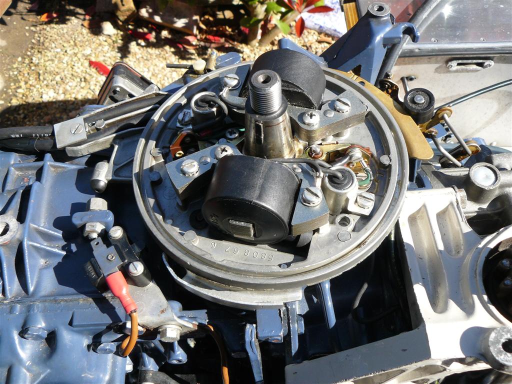

Professor I looked at it again today versus a '64 (RDS-26S) Johnson that I pulled the flywheel on and made the synchronisation changes to the Ski Twin (40103) using the Clymer 40hp setup D & 5 - tried to copy the setup, but the Johnson has a fixed h/speed needle and a different screw setup on the throttle arm. Not sure if I have it spot on now? The only issue I see now is that the HT leads meet marginal resistance as they run across the block when the armature plate moves to the full throttle position...and sometimes the stop is not quite reached. Am not sure whether bending / replacing the control lever spring will improve it, or whether it just relates to the way the leads were routed?
a. Throttle closed - synchronisation as setup today
b. Throttle closed - Cam follower at point where throttle shaft just moves imperceptably
c.Throttle wide open
d. Throttle wide open following synchronisation setup today - throttle shaft no longer rests on stop on carb (it was dead against the stop yesterday, but the armature plate looked like it wasn't far enough across and did not touch the stop on the block ) - ignore the rod from the cam follower to locking lever - it's not in the way in the pic.
e. Throttle rod control setup to 1/32th in (this is at WOT though..)
Still not convinced, but I have little experience on these motors, so doubts do persist..

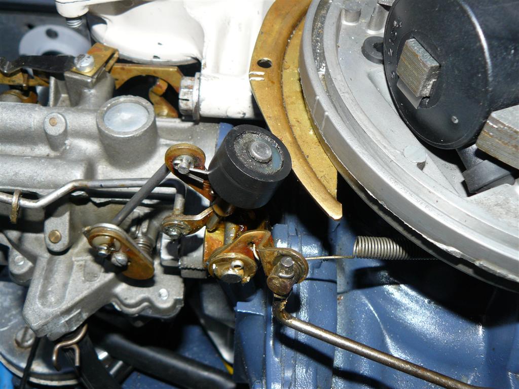

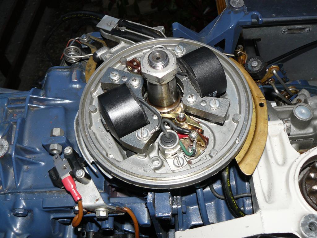

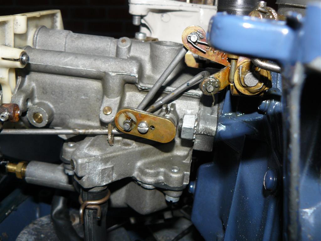

Here's what it looked like yesterday - throttle closed. The 2 marks on the cam align with a cast pointer on the front of the block (out of view)
Re:Ski Twin 40hp Running Issues 13 years 6 months ago #77135

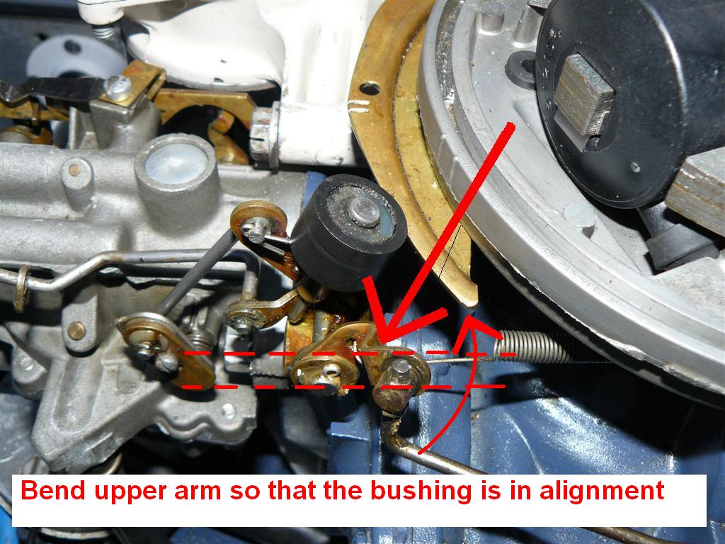

The resistance of the spark plug wires probably isn't the problem. If the wires are stiff & don't allow the free rotation of the magneto plate, replace them. By removing the magneto plate, you have an opportunity to clean and lubricate the bronze bushing that the mag. plate moves upon. Also check on the primary leads over on the other side of the engine to see that those aren't getting stuck or caught on something that would prevent free movement.
Have you repaired the bent / distorted throttle arm on the carb? The arm is distorted and the lever openings are no longer in alignment. The lever should not be skewed to either direction - This must be corrected. I'm guessing that the throttle stop bushing was incorrectly set and this caused the arm to be bent by trying to force the control at the helm. I've attached a picture of the throttle arm actuator for you to look at. The brass bushing with the set screw must not come into contact with the throttle arm bushing until the magneto is fully advanced. The magneto stop arm should be firmly against the block prior to these two bushings contacting each other. The remaining 1/3 to 1/4 travel of the throttle is all at the carb, - not the magneto.
I hope this helps

I spent the morning bending it back to look the same as a spare I have and setting it up. Does the throttle shaft need to be fully against the stop on the carb, i.e. fully open when the magneto plate is up against it's own stop? And then the set screw tighten up? I noticed, on the Johnson, that there was a little movement left in the throttle shaft at wide open throttle (but that could just be because that motor isn't setup yet..).
Although the magneto plate was clean and reasonably greasy, I did a proper job on your recommendation and replaced the fuel pump which wasn't right one for the motor - I guess they got the part numbers mixed up, as the arm was fouling the top of it at part throttle. Nice sunny day here, but tides a bit odd and too short notice to do the final on-water check with my test prop - I'll try it out next weekend and report back.
Thanks very much, greatly appreciated! I was tearing my hair out; will teach me..

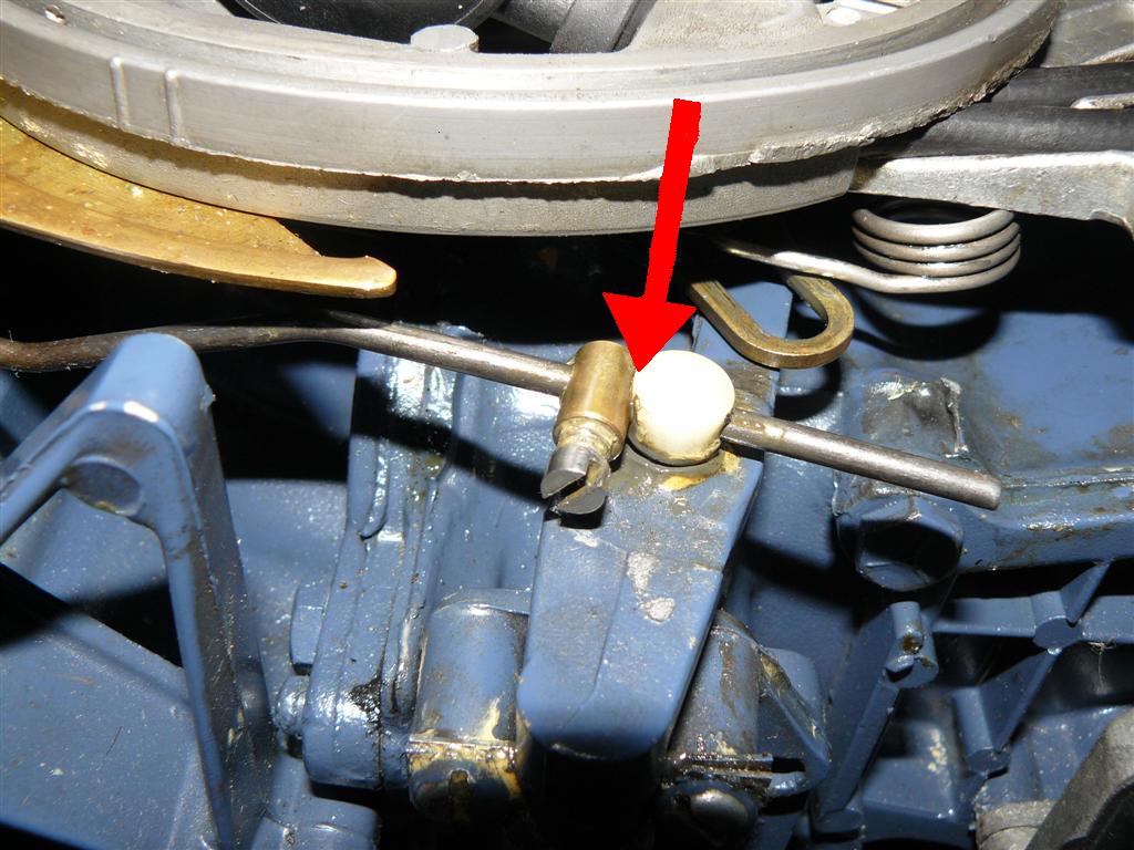

Re:Ski Twin 40hp Running Issues 13 years 6 months ago #77157

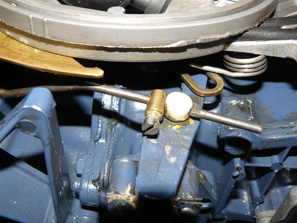

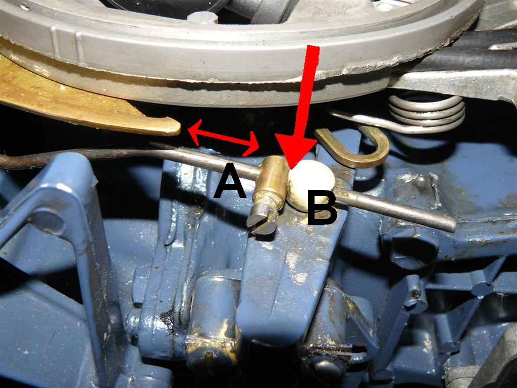

Look at the picture below. Loosen the set screw on the brass collet marked "A" . Slide the collet forward and away from the throttle arm on the tower shaft. Move the main engine throttle to the fully advanced full throttle position and hold it there. The magneto plate should be fully against the stop mounted to the engine block. With the engine throttle held in this position, open the carburetor fully, and hold it in the full open position. While both the engine throttle and carb are fully maximum positions, slide the collet "A" back to the point that it is snug up against the bushing "B" and tighten the set screw. Now return the engine throttle to idle. The carb should be fully closed down to the idle stop. The collet "A" and bushing "B" should have a fair amount of distance between each other. Now - open the engine throttle and watch the magneto plate advance. The bushing "B" should not come into contact with the collet "A" until the magneto has stopped advancing and is FIRMLY against the magneto stop. Up to this point, the only opening (and it is only slight) of the carb has been accomplished by the rubber roller contacting the low speed throttle ramp on the magneto plate. At this point, the collet "A" should be near to touching, or up against bushing "B". The engine throttle is probably at about 2/3 to 3/4 open at this point. Upon opening the throttle even more - the last 1/3 to 1/4 of it's travel - the bushing "B" pushes against collet "A" to open the throttle of the carb. Keep in mind, that when moving the engine throttle, the carb will barely open until the last 1/3 to 3/4 of the throttle travel. Also, the engine must be in forward gear when doing these adjustments, as there is a safety lock-out when it is in neutral and reverse to prevent wide - open throttle run-away.
Re:Ski Twin 40hp Running Issues 13 years 6 months ago #77247
  • chirombo
  • chirombo's Avatar Topic Author
  • Junior Boarder
  • Junior Boarder
  • Posts: 93
  • Karma: 1
Done! I hope to test it properly before a river run (at walking pace) next weekend. Thanks for the help again.

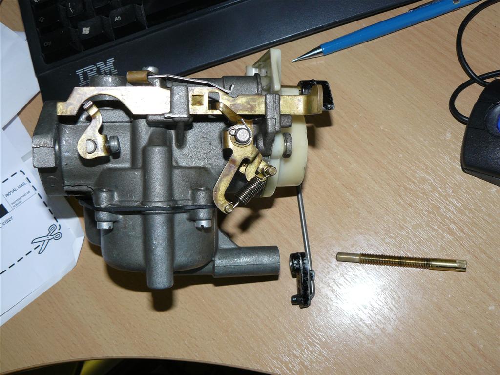

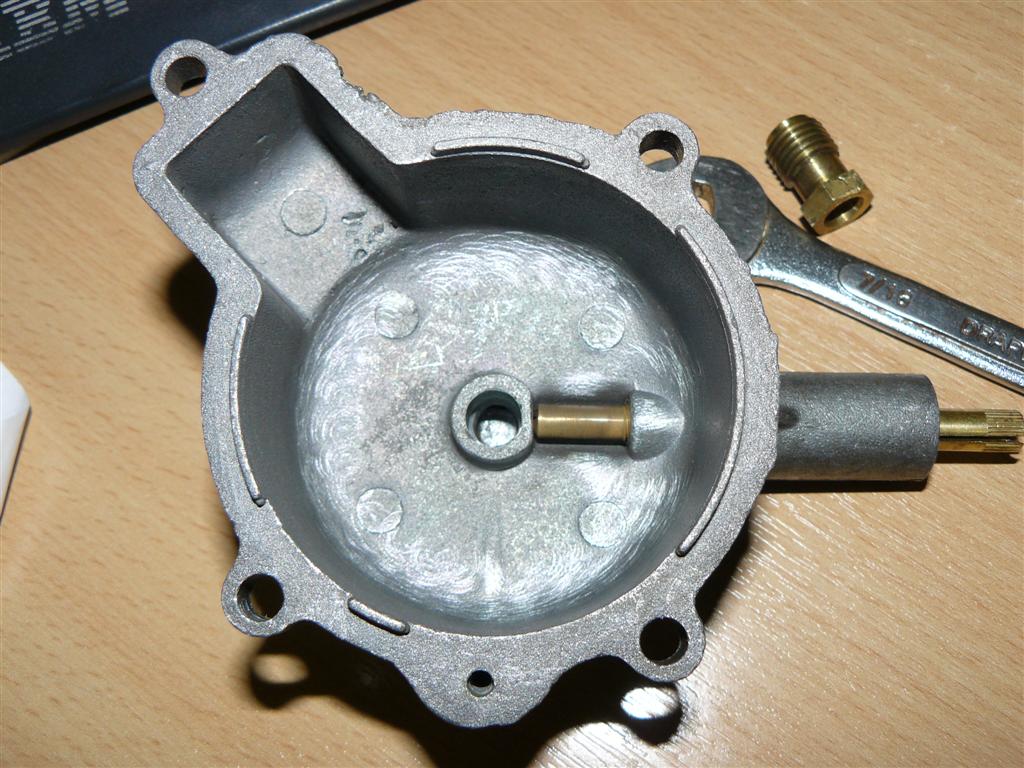

This is a pic of the carb and hs needle. I've never seen one like it though with that blunt end. The float bowl has a slightly smaller diameter hole than the needle. Thinking it may share a common carb with the 40hp Gale of '61/'62 I checked the manual, but that too has a proper needle shape for high speed.
I need to hunt down a factory service manual for this specific motor, as everything about it screams hybrid.
Re:Ski Twin 40hp Running Issues 13 years 5 months ago #78068
The blunt end on the hi speed needle is how it is supposed to be, not sure what to tell you now, hope the carb swap helps.
