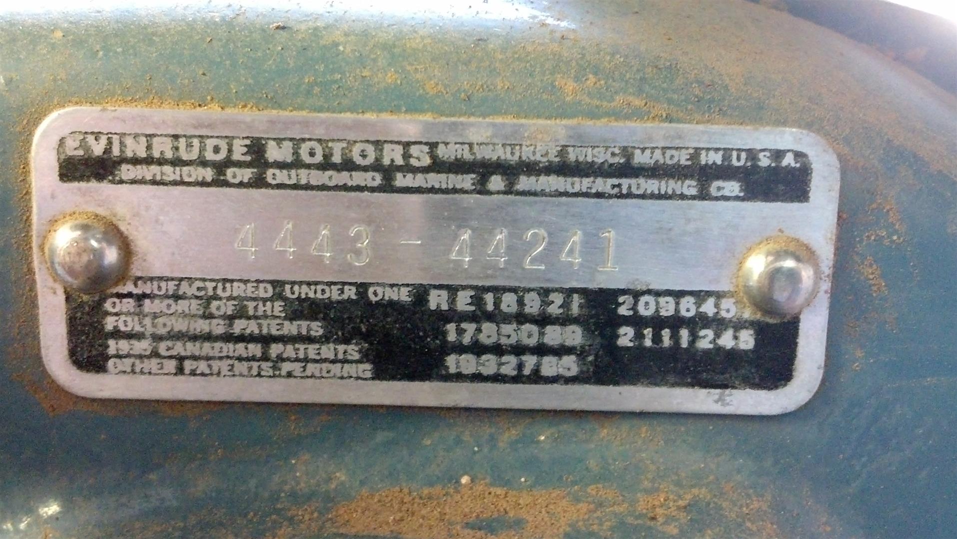

Looking for a source of general info on this motor. My son picked it up at a moving sale some years back and it's been sitting in his garage ever since. It's a Fleetwin without the forward/reverse shifter. To reverse, you spin the motor 180 degrees. Has a clutch knob on the top to go from neutral to forward. Gas tank is integrated into the top cover. This motor appears to have little use on it. Still sitting on the original stand. Excellent compression, but the plug wires have come loose from the coils and the coils themselves, viewed through an aperture in the flyweheel, look badly aged. The only missing parts are the side covers. When my son first got the motor he took the covers off and put them on his workbench. His wife tidied up the garage for him and the side covers were never seen again. :S
We would love to get this old gal running, so I'm wondering if things like the spark coils are available anywhere. Also wondering what year it is. I know it's pre-1955 because info on the 55 models shows a F-N-R shifter on the side. No pics of the motor yet, just the serial number plate.
Edit: I checked the info on the forum and found that this is probably around a 1951 model. By 1954 they had a full F-N-R transmission. I'd still appreciate any info about the motors and parts sources, especially the side covers and spark coils. Also wondering, were the coils and plug wires constructed as a unit, or can we maybe pull the flywheel and attach new plug wires to the old coils?

I believe it's a '52 judging by the s/n.
Re: Early Evinrude Fleetwin info? 13 years 6 months ago #76767
A 443 is a 1952-52 7.5 hp. It uses a 16 to 1 oil mix, however you can get by with a 24 to 1 mix. It does not have bearings on the rods
