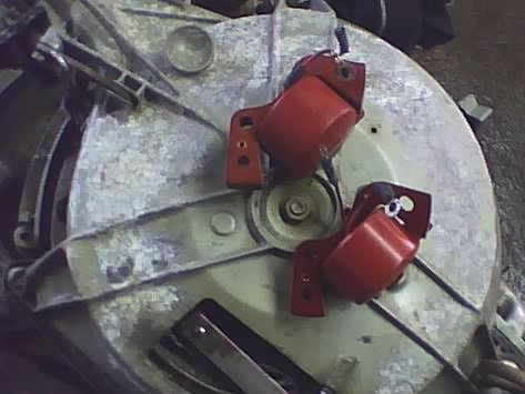

BTW, the coils look like they could be original ('59), kind of orange-brown, marked OMC W. Germany, but they also look like new, no age or cracks. Would you think they could be original, or maybe NOS? I do plan on changing them anyway. Thanks

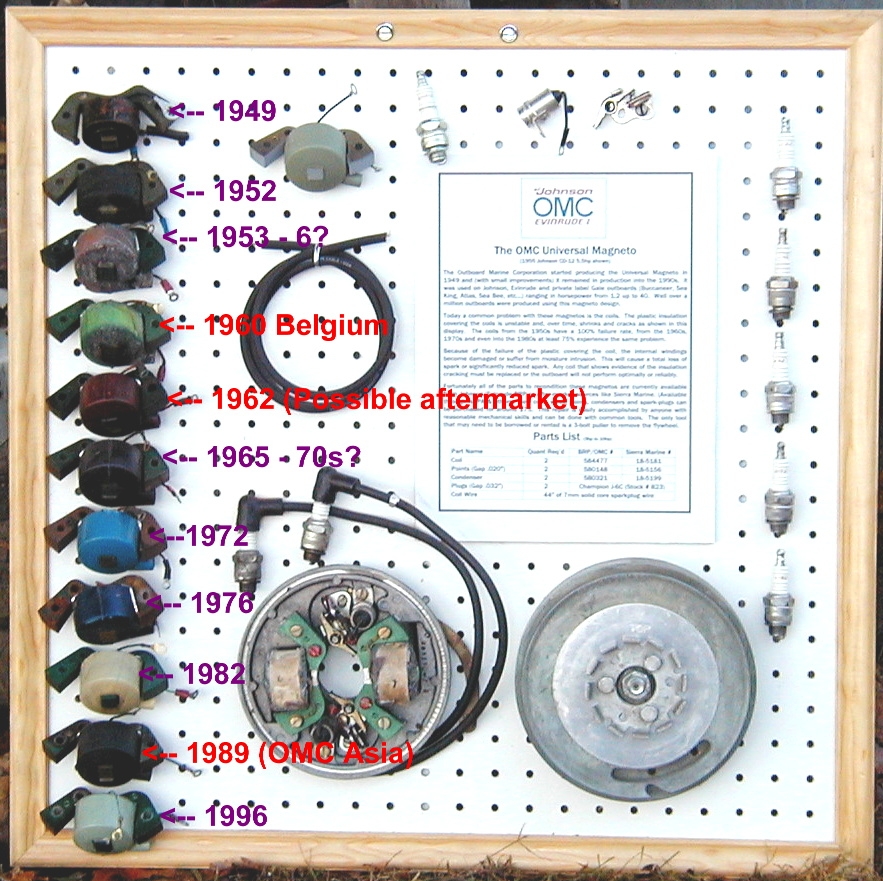

Some where on line an AOMCI member has a photo of a board with many of the coils and date used over the years for OMC
I looked and as of right now cannot find it...I most likely will run across it one of these days when I am not looking for it

Here's the photo of the OMC coil display- I saved it last time it was posted.
Re:35 Lark Point Gap??? 13 years 6 months ago #76709
The West German coils are NOT originals, so that means yours have been replaced at some point. You're likely good to go on that front...

Wow, that's cool. I can't really tell if any of those coils on the board are the orange/brown like mine. If I remember right my '52 10hp Johnson has similar ones, except they have a small gold-foil decal attached that reads 'West Germany'. The ones in the '59 Lark have 'OMC W.Germany' molded into them. I'll try to get some pics. And I did solve the points gap, with further adjustment, see sometimes a couple cold one can shed some light (lol)... Thanks for all the good info!

I'll try to post a pic of the old coils...

Those coils don't look like the original-equipment OMC coils that crack with age. Physically they look great and if they're putting out good spark, I don't see any reason to not use them.
Or at least save them for another project if you're gonna put new coils in your Lark.

Upon, initial testing, I got no spark in either cyl. I have changed coils, points, condensers, plugs and wires. So I won't know if the old ones are ok until I test them in another motor, which I'm sure I will.
Interestingly the throttle (butterfly) shaft was set up in this motor, which suggests me that it was probably sitting for a very long time...Thanks for the input...BTW, I didn't think my pics were posting because I can't view them myself...???
