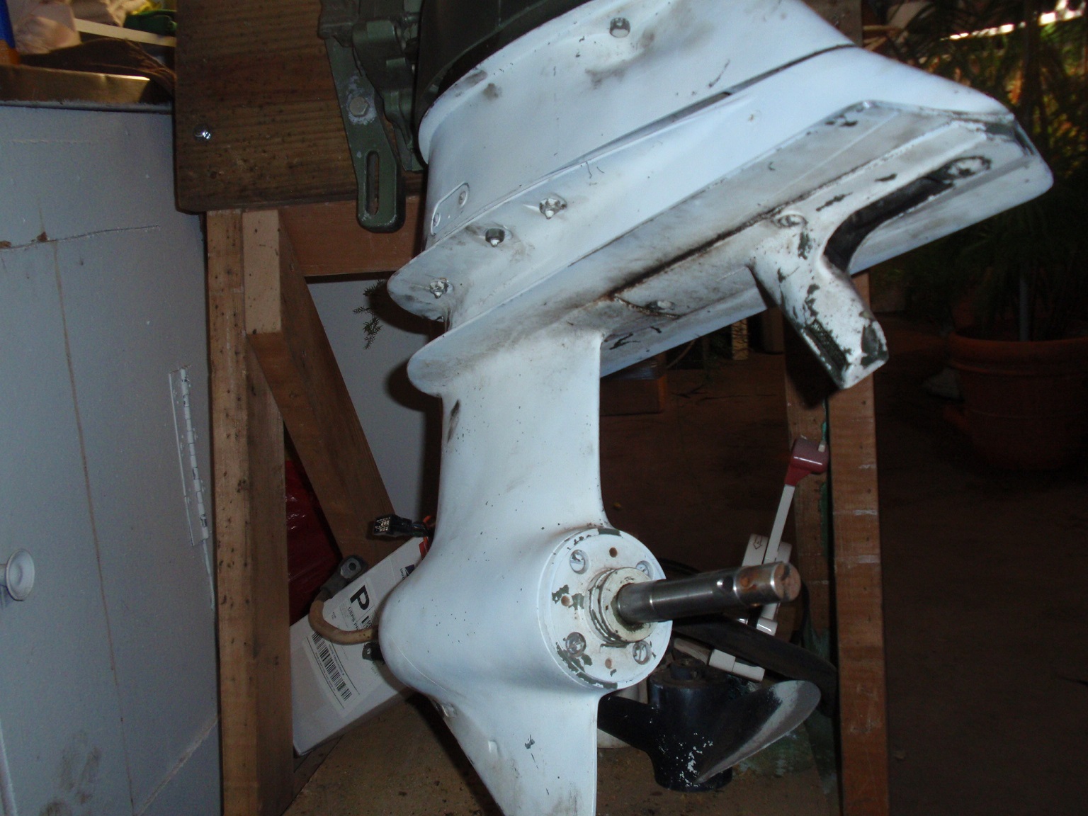

I want to test my 100hp Johnson golden meteor. Right now it's on a stand, put on a new starter solenoid, water impeller and just changed the lower unit elec shift lube, $10. a qt at the local dealer. Where or how can I hook up a garden hose to this puppy? I have muffs but this isn't the normal water inlet.

So if make up a fitting to fit over the intake portion somehow it should work? Does that "taco" cover the whole underside thingy or just fit over the down part?

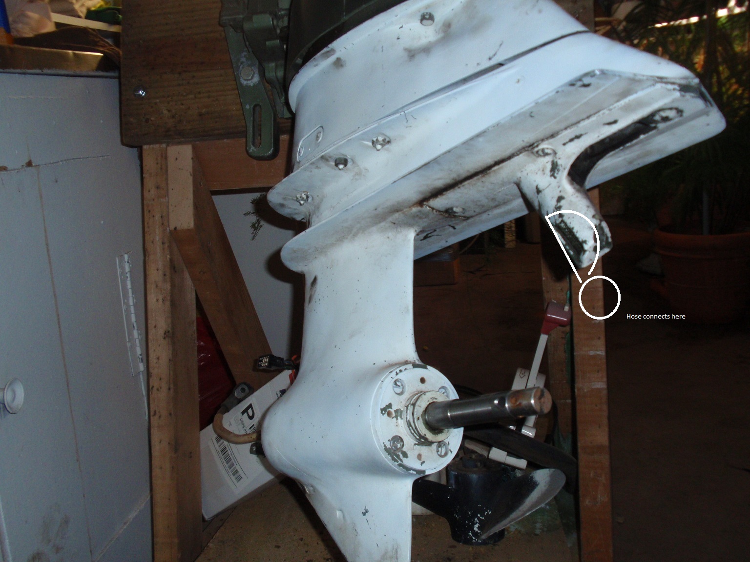

Re:Golder Meteor cooling 13 years 6 months ago #76238
I tried as best I can to show how mine goes on. I can take a picture of it tonight. Hope it makes sense.

Re:Golder Meteor cooling 13 years 6 months ago #76246
Tamahawk, thanks. I wasn't quite sure where the intake was. I think I can "field engineer" a piece to fit that little portion.

I see the small cover on the side of the lower unit.----I thought that was removed for proper cooling in a test tank ?---I will look at one of these lower units later today to see where that port leads to.
Re:Golder Meteor cooling 13 years 6 months ago #76332
That is a really big lower unit but I think I have a "stretchable" garbage can that will work. Seems like a really small inlet area for the cooling, what about opening the side port like mentioned?
