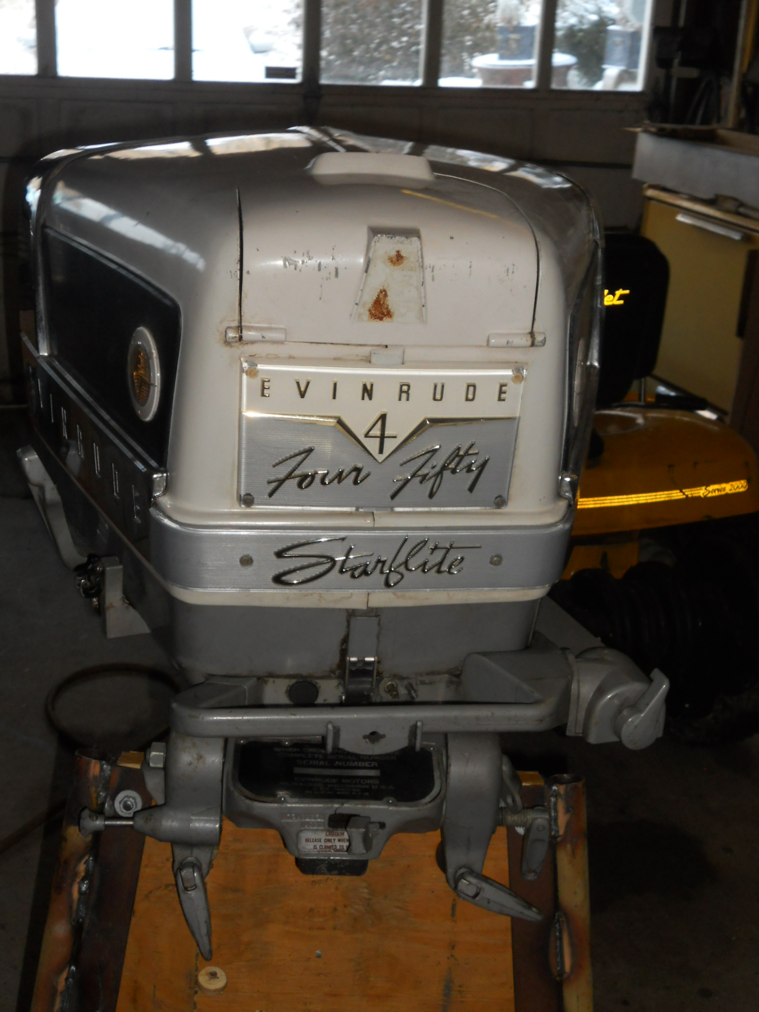

New to the site here. AOMCI member for ten years or so. I found this one on Craig's List in NH.Cosmetically its as good as it gets for 1958. I got the wiring harness, but no controls. Two weekends of fooling around with it, clean points, plugs, dist. cap contacts, carb, fuel pump. I replaced a couple of mouse chewed wires, and checked out the water pump and gearcase oil. All good. I hooked up some ears and a gas tank, and WOOO! she started on the fourth pull!
I remember seeing one of these when I was a little kid, and always thought it would be cool to have one. It'll go great on my Jet Deville project. Now go rebuild that transom...
Larry

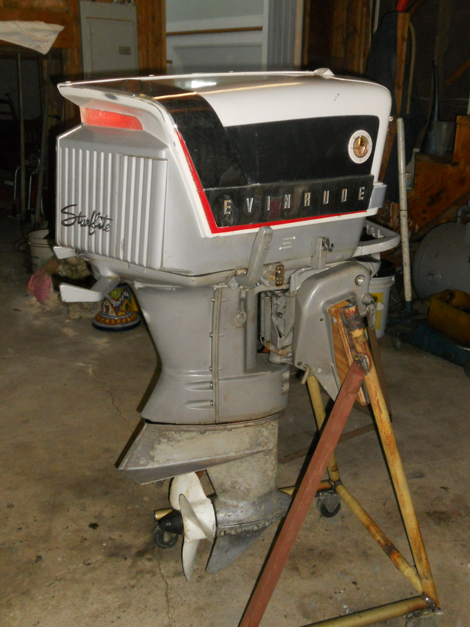

Another pic. They don't make graphics like this anymore... Anyone have that little emblem that's missing?
Larry

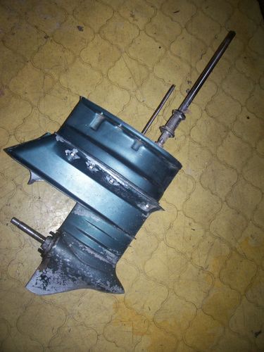

I can't attest to the gear ratio, but the original "Fat Fifty" lower unit (aka "Heavy-Duty" lower unit) is about as hydrodynamic as a log! It was meant to swing a large prop at low speeds, to take advantage of the motor's large amount of torque, for pushing heavy boats/loads.
Later motors had what was called a "High Speed" lower unit, with a much smaller gearcase diameter and a streamlined shape, which cut the water much better. It also carries a smaller-diameter prop and I'd expect swings it at a faster speed, so maybe there is a diff in gear ratios!
At any rate, the 2 lower units are interchangeable and if you get a late-enough one, the shift clutch is improved with spring-loaded balls which ensure the clutch snaps smartly into gear, and holds that gear better.
The biggest weakness on these old mechanical-shift V4's is the shift clutch/gear design, 'cause they depend on the tightness and adjustment of all the pieces in the shift mechanism to hold the motor in gear. Any wear/slop leads to slippage and damage of the dogs on the clutch and gears. Mostly on the forward gear since there's more stress on the dogs.
But I digress, there should be plenty of the High-Speed lower units kicking around, finding a good one is the chore. They are a bit harder to work on, since the case halves don't split like the Fifty.
There are 2 long studs holding the lower and upper case/housing together, and they can be a real bugger if run in salt. A fresh water gearcase should come right apart, with little persuasion (maybe a bit of heat if necessary).
Check your local Craigslist for dead V4's, there should be a couple or 3!
I found a pic of a 75hp V4 on eBay, for an example. The housing on top is the 5-inch extension piece for a longshaft and is just bolted on.
HTH.......ed
