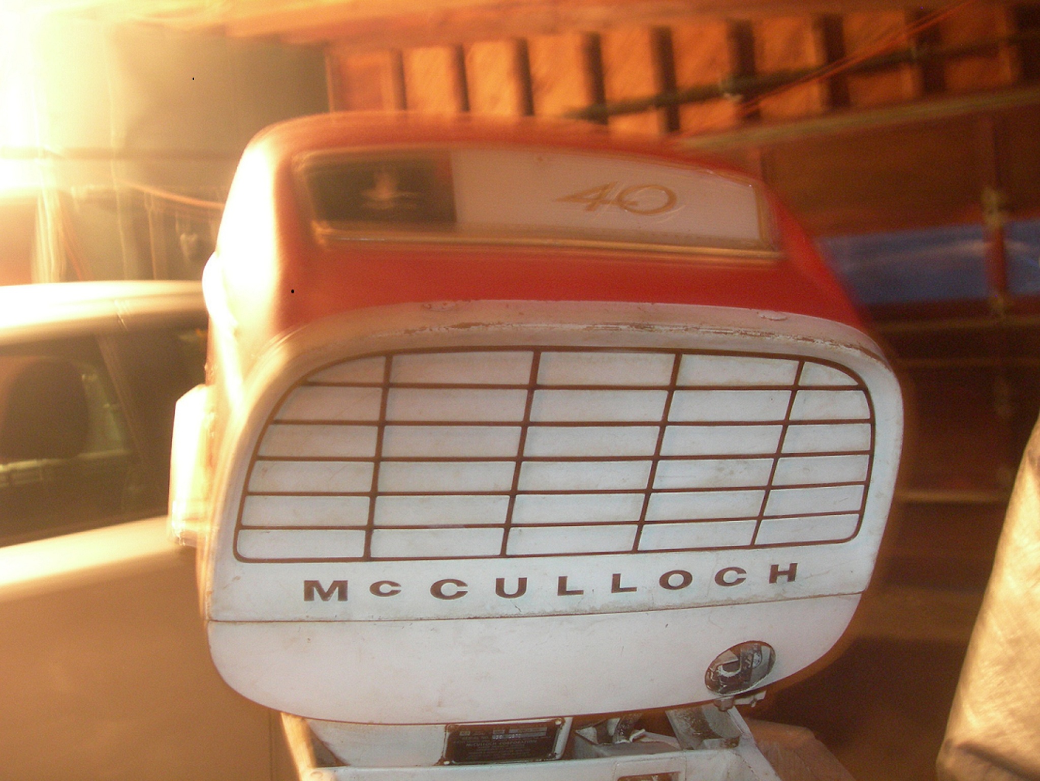

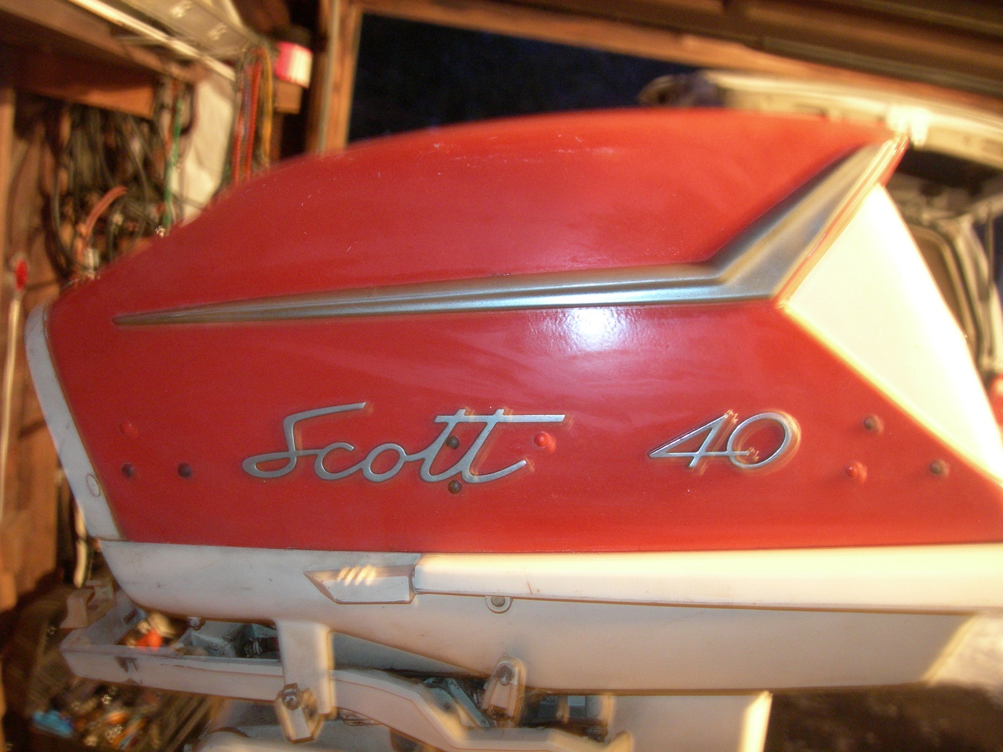

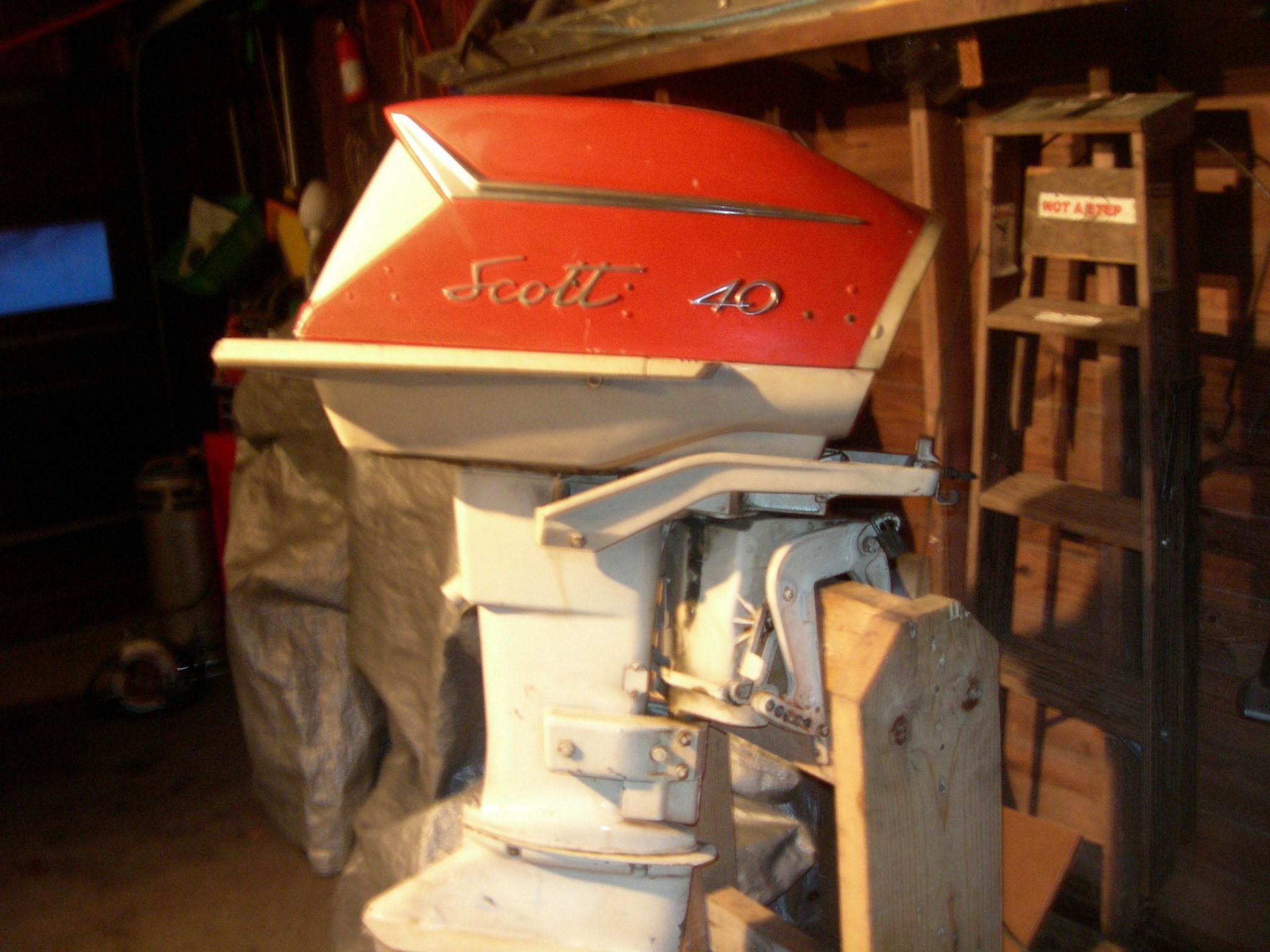

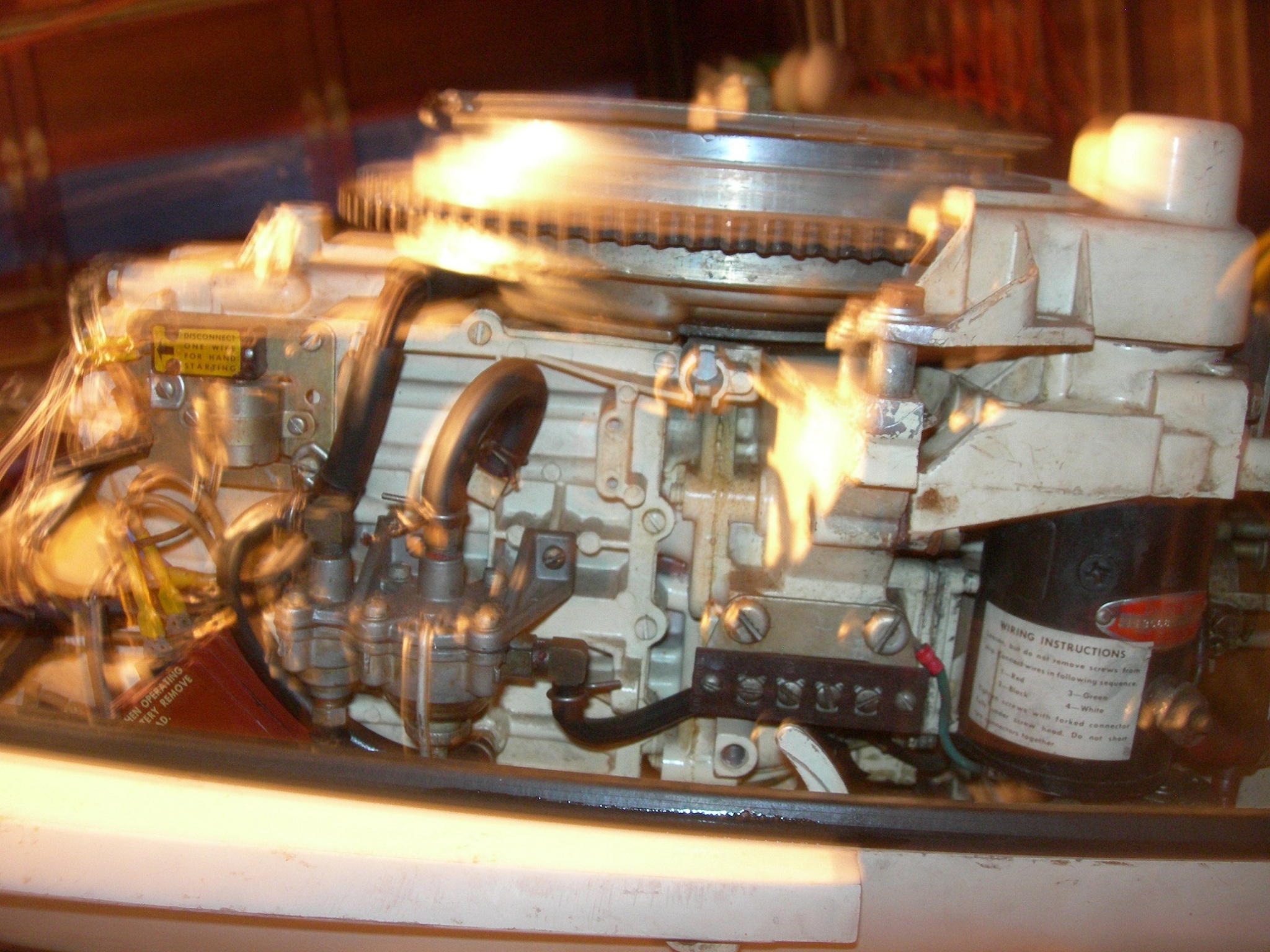

So now to the motor....here are a couple of initial pics and I will follow up with some questions shortly as I start to look into waking it up. I have found documentation on wiring etc so I think I can figure out how to rig a harness(using the empty terminal block to connect thru to solenoid/choke/???rectifier maybe and see that there is a starter solenoid inside so I assume I just need battery cables to run to battery from one side of solenoid and ground somewhere on block/starter grd).
Anyways here are a couple crappy pics for now to start this thread. Looking forward to help from Ponyman/Scott and anyone else with Scott experience...and thanks in advance.

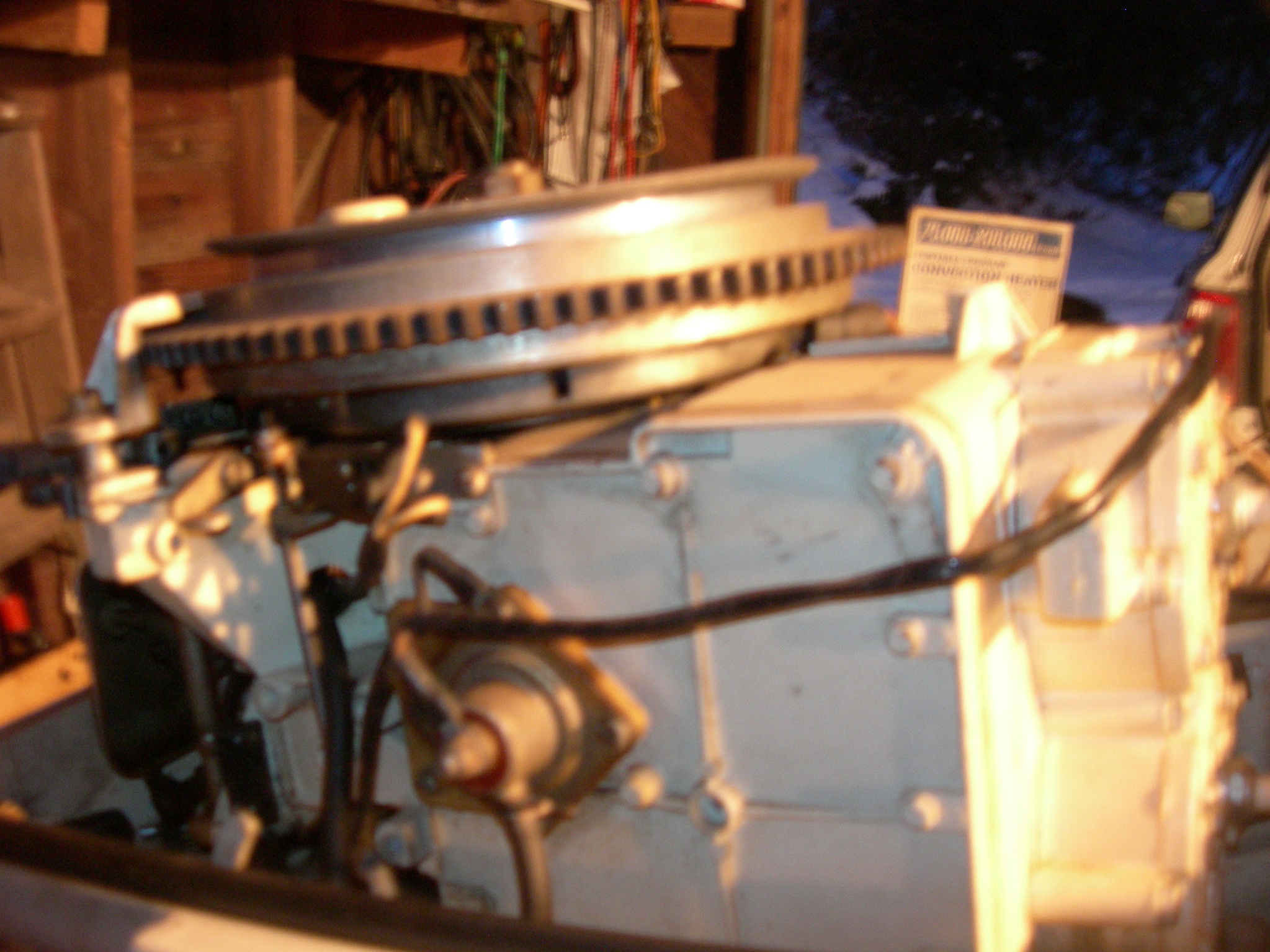

Gotta hang on....pics a bit too big. New computer...need to figure out how to resize. and post here
OK Here we GO..

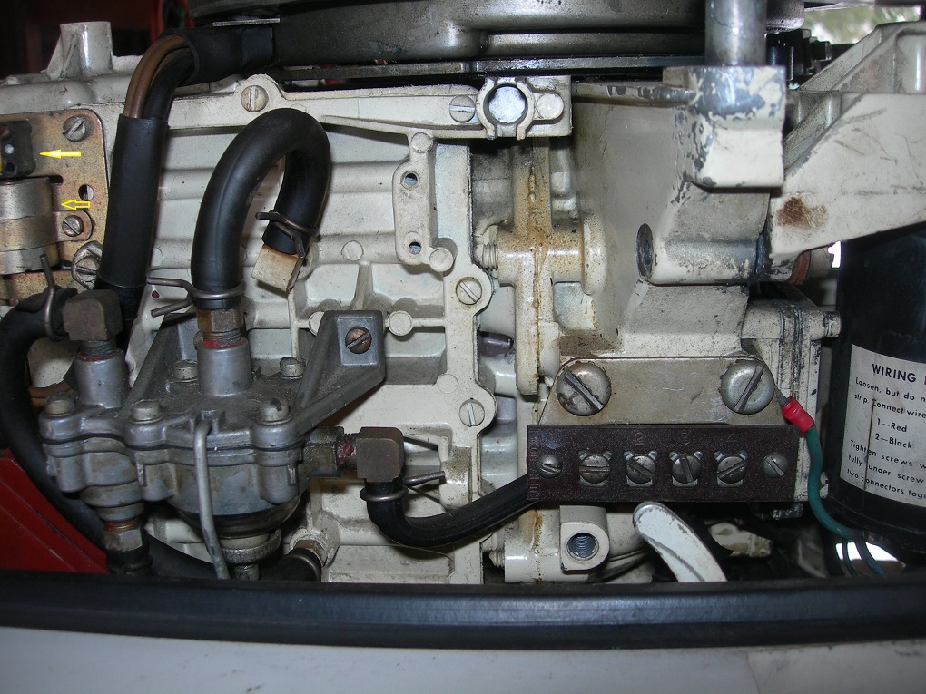

Am anxious of course to get this baby woke up so I picked up a couple of battery cables and an ignition switch. I used a 4 foot piece of the original 4 wire ignition/choke cable as a temp way to start. I connected the following on the ignition switch..the red wire to the B post, the white wire to the S post, the green wire to the C post and the black wire to the I post. Hooked it up to the engine on the terminal block following instructions on the sticker on starter(very simple straight forward)…push in choke worked in the run position but when key turned to start nothing happened but I hear a click in one of the two things I have pointed out in this picture(yellow arrows). Maybe Regulator and or circuit breaker?
One thing to note…there is a break in the casing of the little red wire running to battery side post on the solenoid from the terminal block and I also just noticed that the nut on the positive terminal of the starter is stripped and won’t really tighten properly….probably gonna have to find a new brush set eh?
Thoughts?

Ok that clicking was not the issue(normal)...it was the stripped thread on the +starter post...built it up with some washers and got enough thread to get it tight. While I had the starter off I pulled the carb and cleaned it and set the aluminum float properly.
So now it was turning over....quickly checked compression(good) and spark(weak).
Pulled the flywheel and cleaned and set the points. Coils and everything looked really good.
Cranked again...good spark.
Excited to fire it up....don't have the old proprietary fuel line fitting so I hooked tank hose directly to fuel pump. Noticed sediment in the bowl under the fuel pump so removed it to clean and the darn rubber gasket was so brittle it broke which brought me to a schreaching halt just before my test run.
Gotta find a bowl gasket now....tank line fuel fitting and might as well replace the brittle old fuel and vacuum lines while I am at it. Hoepfully ScottGuy upstate from here in Mexico NY can help me out with these parts.
Stay tuned. I can't wait to wake this old girl up after a 30 year sleep. I've read good things about these 40 Scott Twins. Just remembered that a new impeller will be on my list of things as well.
