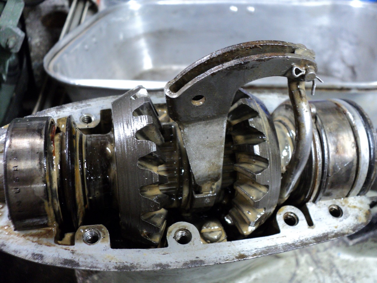

I'm going to put new seals in the lower end. Does anyone know what all I need. Everything looks good down there. Does not seem to be a seal on the shift rod.There was a little water and milky looking.
Re: Another question 59 35 hp Golden Jubilee 13 years 8 months ago #74793
There is a wee bushing and it is used to hold an o-ring in place and it is the seal for the shiftrod.
Now it can be replaced without removing the bushing. Other way is to remove the bushing and replace the o-ring.
That shift rod seal is often overlooked.
