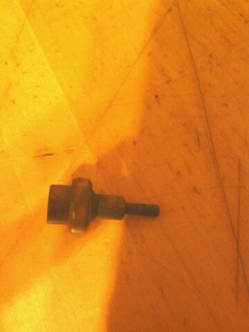

How would I check the Vernatherm on my 1960 V4S 75hp johnson, to make sure it is operating properly?
Thank You
Jim

That vernatherm looks familiar...that looks like my table too!
It's been awhile but i'm pretty sure i put it in water on the stove. turn burner on and make sure the post on the vernatherm moves when water gets hot (bring to a boil). I do not remember how much it moves.
