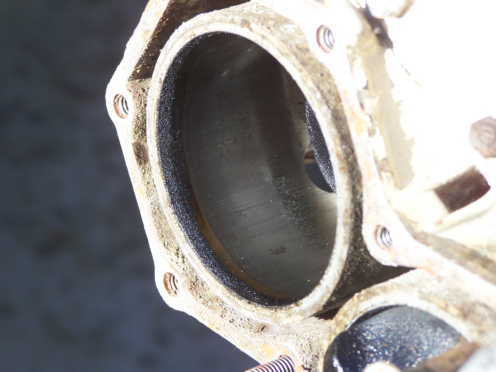

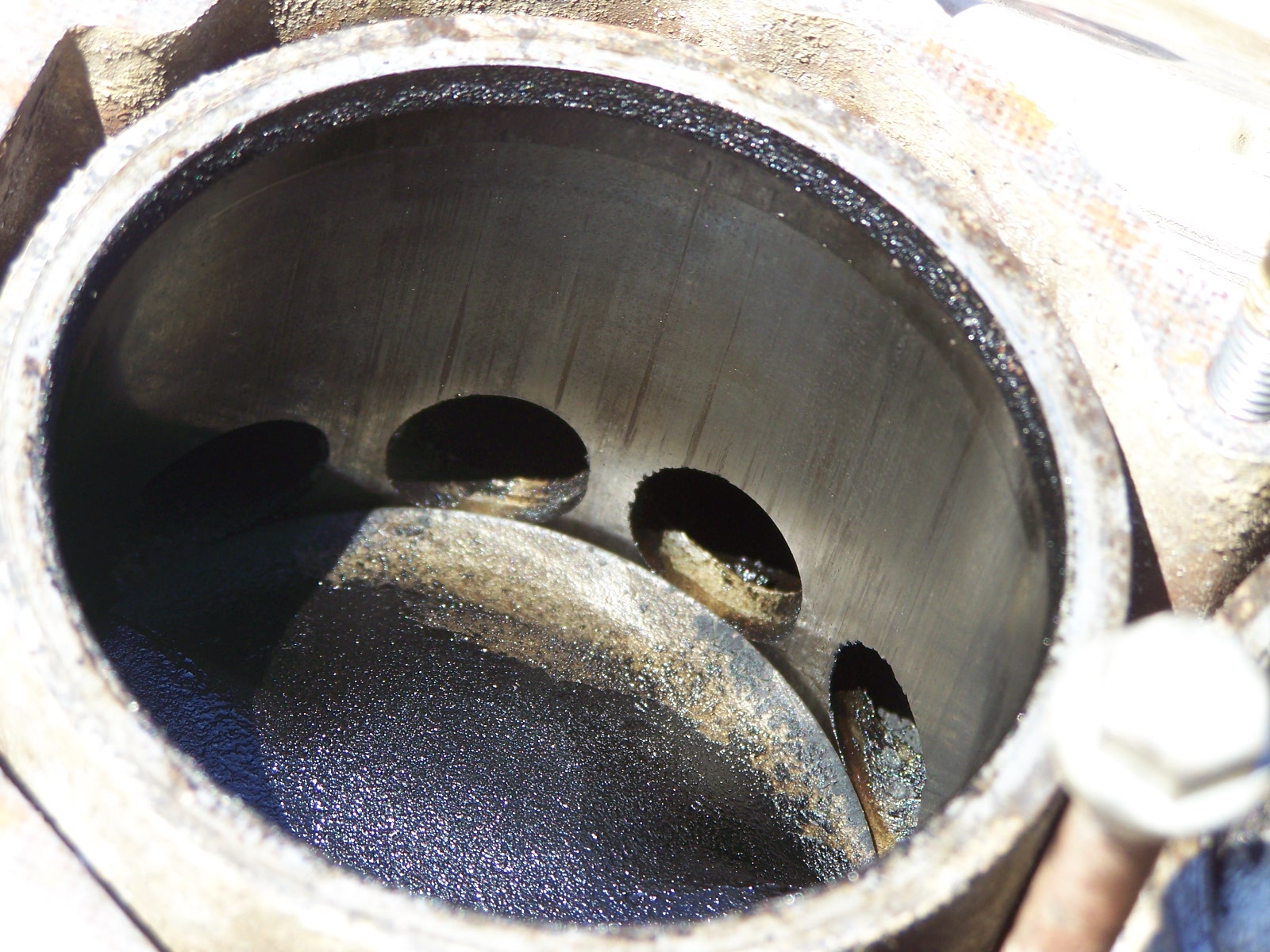

I did the water pump, check to the points, and syncd the carb and ignition. I fired it up and got lack luster performance, Im gonna rebuild the carb and fuel pump and give it another shot. Compression is at 80 pounds on all four. I removed the bypass covers and notoced scoring on one of the cylinders, overheating maybe??. I removed the head to inspect. Please let me know what you think. Here is a video.

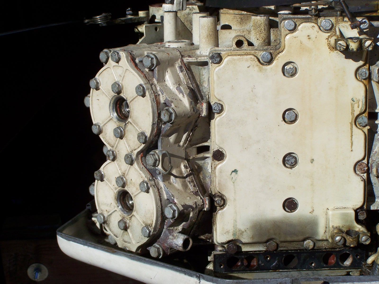

Why don't you pull the rear pan off? At this point it's only being held on by 2 screws. It will make life way easier. When you say lackluster - was in just run in a barrel? Power testing really has to be under a full load with a propeller or test wheel in a large test tank - or in your case - the boat ramp. Leave the boat fully attached to the trailer & back it into the water with the lower unit and water pump housing fully submerged. The scoring is a bit unusual, because it is on the intake side of the piston. Most damage is normally on the exhaust side. This engine may have been run with inadequate / no oil in the fuel at some point. It also could have been overheated and siezed - if that were the case - the paint on the heads & the block where the heads attach might have a toasty brownish color. Bubbled paint alone is not always an indicator of overheating - but burned paint is a dead give away.
The rear exhaust cover is indeed cooled with water. Inside the engine behind it is a stainless steel plate (aluminum on later engines) that has intensely hot exhaust gases blasting it from the exhaust ports. If it leaks, you need to remove it & replace the gaskets - there are two of them. Any stuck bolts need to be heated severely and tapped with a hammer (using a drift) and allowed to cool before attempting removal. Repeat as many times as needed to get it to move. Be careful - it doesn't take but a few pounds torque to break one off. Some people use penetrating oil - others say not to use it as it will make the bolt even harder to remove.
But getting back to the reason why you took it apart - what did you consider lack luster & why?
Finally - do not pour money into this engine as it is damaged. Snoop around and find another one that has good cylinders and pistons. Good ones without scoring can be extremely difficult to find anymore. Over sized pistons and rings will cost you dearly if you can even obtain them. Then you will need to have the cylinders machined. Now you are looking at around 1 grand just for pistons and machine work

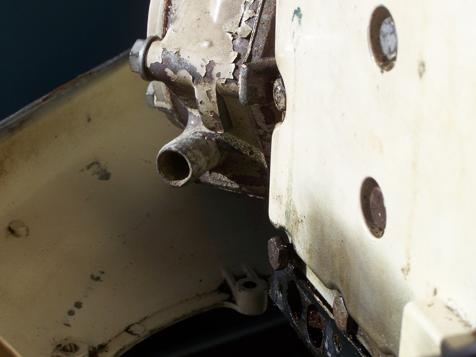

Thanks for sticking with me and my silly questions, I am a novice, but having tons of fun playing with this motor. In addition to the loose carb creating a lean condition in the one and only damaged cylinder as was pointed out to me, is it possible that the loose and frozen exhaust plate bolt in this picture, let exhaust gases seep into the cooling system and cause the upper cylinder in this picture to run hot and get damaged?? Seems odd only one cylinder is damaged.

The exhaust leak isn't good, but I don't think it would cause any overheating issues. Outboards have a fresh supply of cool water at all times, and that usually prevents overheating. This of course requires that the engine is pumping water. Questions are good - not silly. How else are we supposed to learn?
