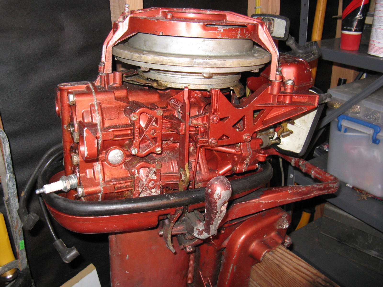

OK, starting a new thread here as I'm sure I'll have some more Q's on this project. Last night I checked the compression after a little seafoam soak to loosen things up in the cylinders. Compression came out right about 92 on both cylinders, but I beleive I forgot to open the throttle plate all the way. Checked for spark, and seemed like only one lead was firing. Pulled the Manual starter off the flywheel, and through the flywheel window, I could see one of the coils is different than the other, so possibly one is still original and bad. Points were tight at.017, and I think the points and condernsers might have been replaced with the coil, obviously there has been some work done, as the engine has clear fuel lines as well, and I think tough up paint. I'm guessing over ten years back at least. I have a bunch of stuff ordered up with a carb rebuild kit, new lower seals and impeller, and coils points etc.. Also went ahead and ordered everything up for the Lark 2 which is coming into my shop as soon as this one is up and running.

Allright, recieved all my parts and got to work this weekend! Yesterday I pulled the flywheel and replaced all coils, condensors and points. The condensors were very loose and in one of the coils the needle looked rusty. Not to mention one coil was black and the other was blue, the blue one looked older and I suspect was part of the no spark problem on one cylinder.
Question on the spark plug leads. Do I need to cut them back a little so the new needles in the coil seat nicely making good contact or just put them back in(what I did)?
Also on reinstalling the flywheel, I was very careful aligning up the key, but it seems like the flywheel isn't perfectly straight level that I've mostly tighened it down, I think there is maybe 1/16" difference or a tad more ? Should I pull and redo, or just continue with torqueing it and it should level out?
Having fun and hoping to get to the carbs next.
Re:56 Johnson 15HP(good first motor?) 13 years 9 months ago #73869
Oh yeah one more thing, the spring washer under the armature plate, I didn't saee it in there but maybe I missed it, is that because this was used with a remote? Should one go back in if using a tiller? Help appreciated greatly!!
Re:56 Johnson 15HP(good first motor?) 13 years 9 months ago #73896
Ok, messed with the flywheel last night and I think it's the armature plate that is slightly off kilter, going to replace the spark plug leads(they are a bit crusty anyway) and reinstall everything hopefully level this time. Any tips or thoughs would be appreciated. Thanks.

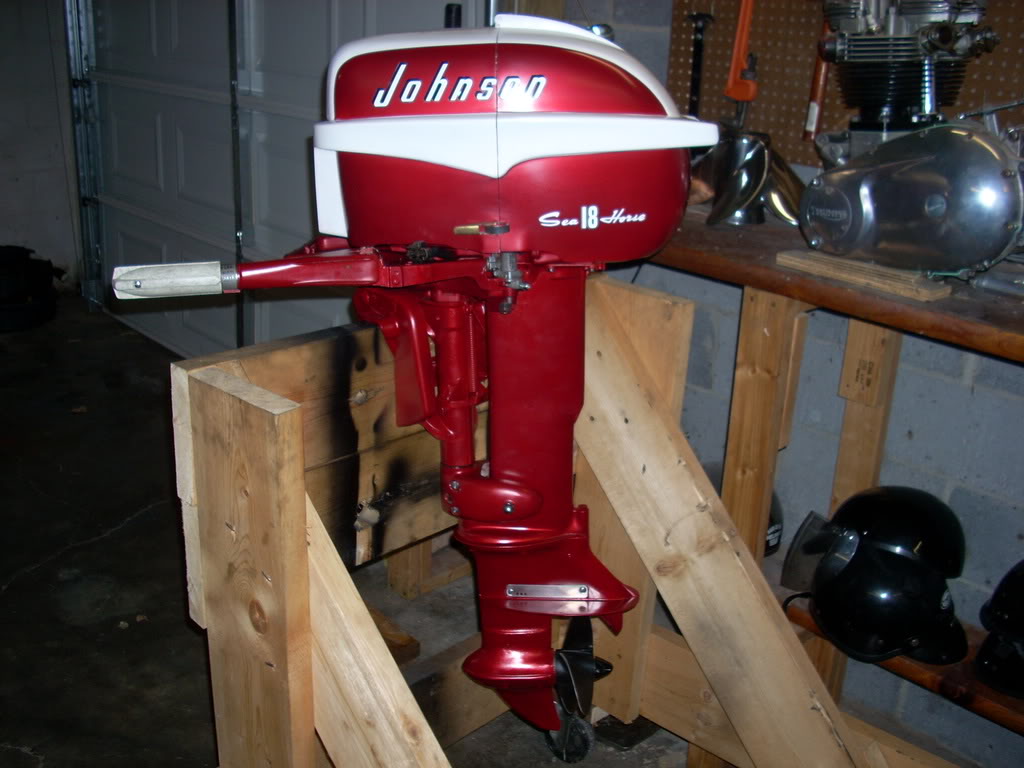

Thanks, yeah lots of good avice so far and having a blast. Read from cover to cover cheap outboards over the past few days. I'm still working on the shift seal, I might try tapping it tonight. I Also need to pull the powerhead I guess due to a seal between the crankshaft and driveshaft being in poor shape. I was planning on practicing first on my frozen 57 18hp johnson that I grabbed for a couple parts(mainly the tiller).

Making me miss the 1957 Johnson 18 I rebuilt a few years ago...it was a great runner.
