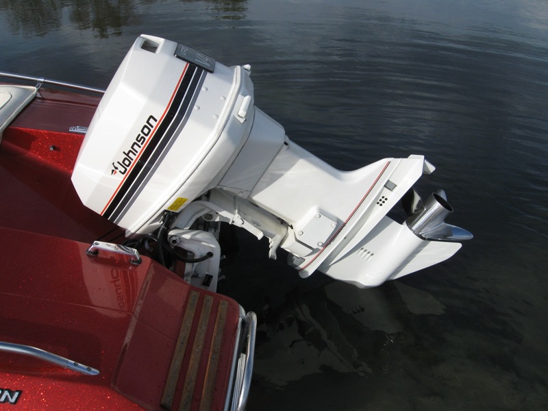

I now have a 16' Glastron/Carlson CVX-16 with a 1985 115 HP Johnson that can go 55.0 MPH GPS with a Raker 22" prop.

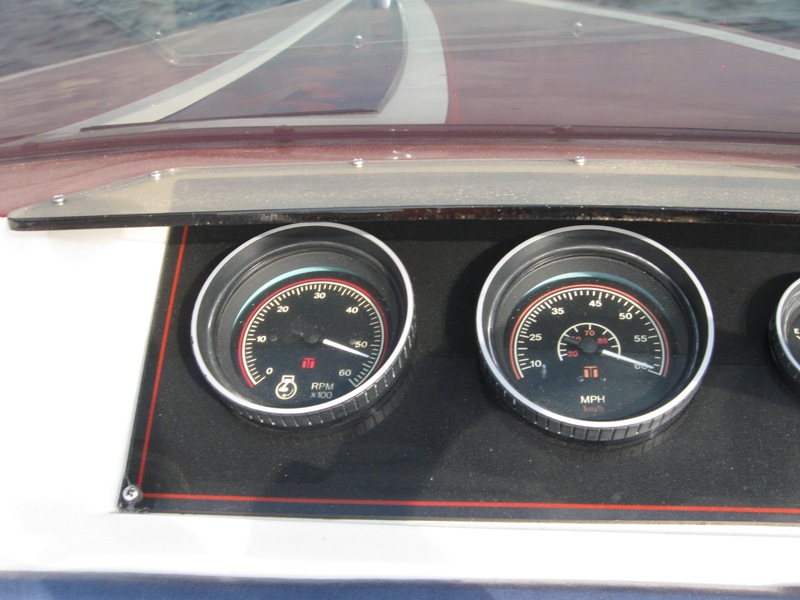

With the 22" Raker with one on board, I hit 55.0 MPH GPS at 5,450 RPM. The speedometer is optimistic at 61 MPH.

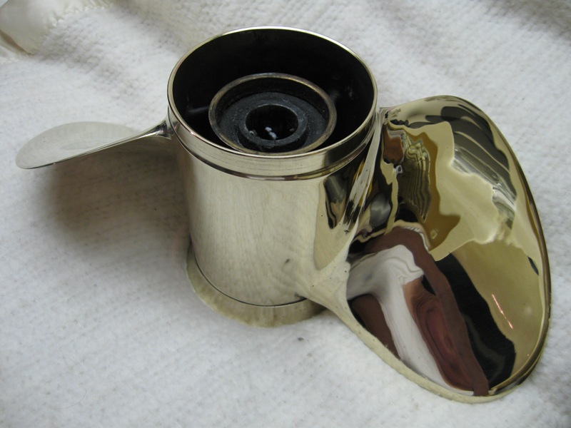

The outer diameter of the prop is the same as the outer diameter of the bullit of the OMC lower unit. so it will make the prop completly useless for a merc. Im looking for a pic of mine but not finding it. what is the merc part # of the prop your wanting to use ?
the center prop in this pic is the one I had done to fit the omc gearcase.

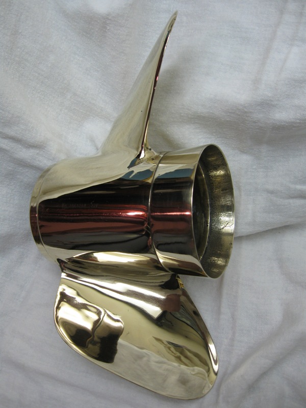

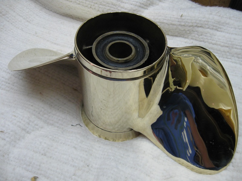

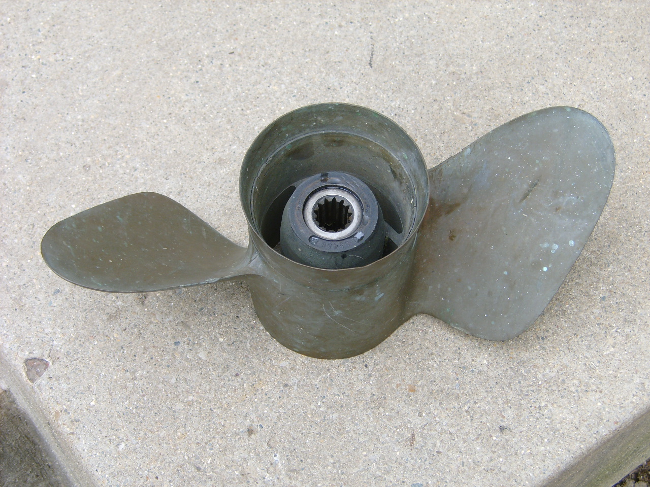

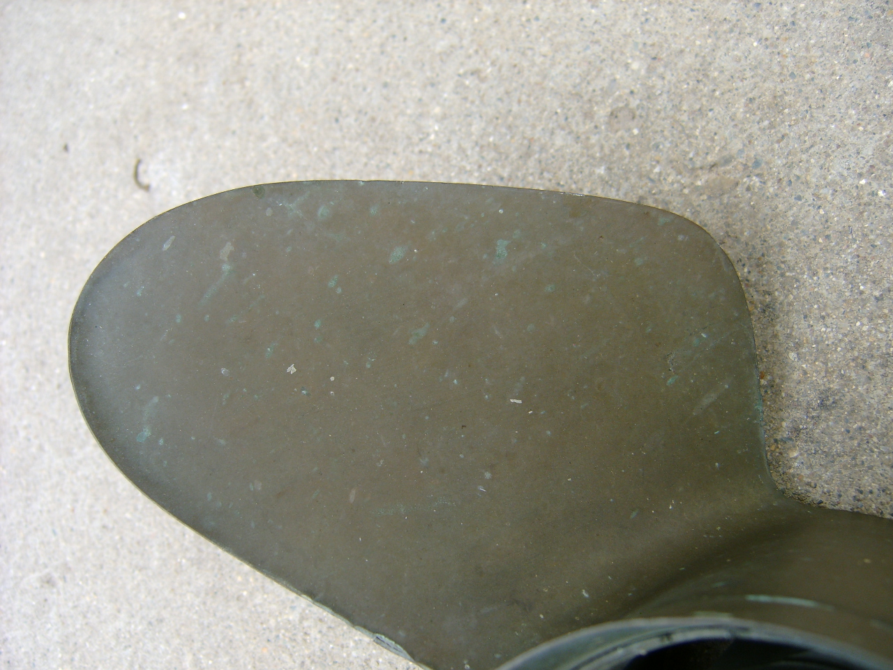

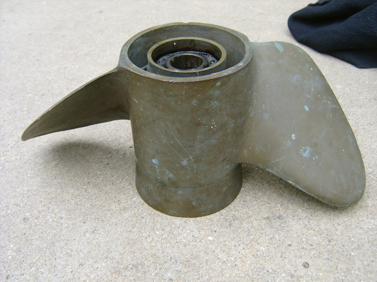

The 2-blade bronze prop I hope to covert is part number 48-49630-21, pictured above and below. I also have a prop like the three you have pictured, a 22" pitch Hi-performance 2-blade but I do not know how they perform. The 48-49630-21 is a proven to me prop that goes fast.
Is it necessary for the front of the prop metal to fit inside the gear housing? Could one cut back the front of the prop to have it almost butt against the gear housing?

I measured the Johnson lower unit gear case outside and inside wall diameters and the Mercury Quicksilver propeller. Both outside walls are 4". Appears that the front flange of the Mercury prop will have to be cut off so that it butts close (1/8"?) to the back of the Johnson lower unit - both 4" in diameter.
The trick will be to cut off just enough of the front prop flange after rehubbing with a Johnson hub and using a Johnson thrush washer.
May rehub both the 21" and 22" bronze props.
The props will be called "Long John Silver"
Re:Converting Mercury Prop to Johnson Outboard Motor 13 years 10 months ago #73250
It seems a waste but Ive done it too. Ive been looking for a pic of mine but I cant find one, the prop is on the motor backed up to a wall for the winter (first boat in). and yes rehub it first and cut as you need to. mine sets about .025" away from the motor.

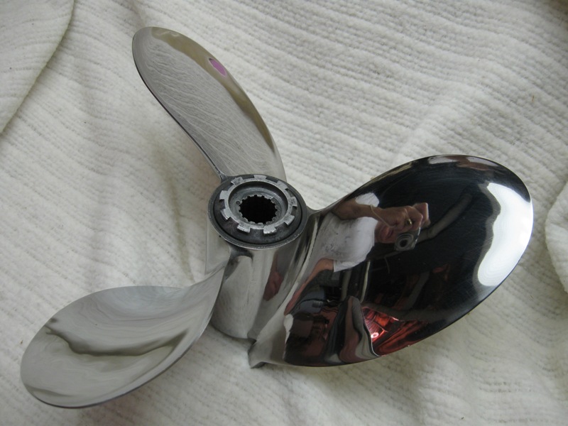

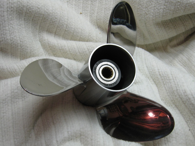

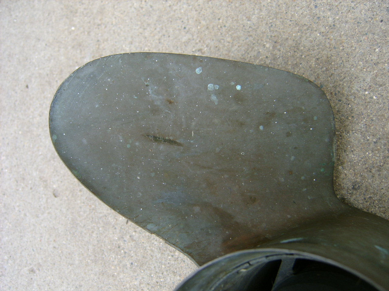

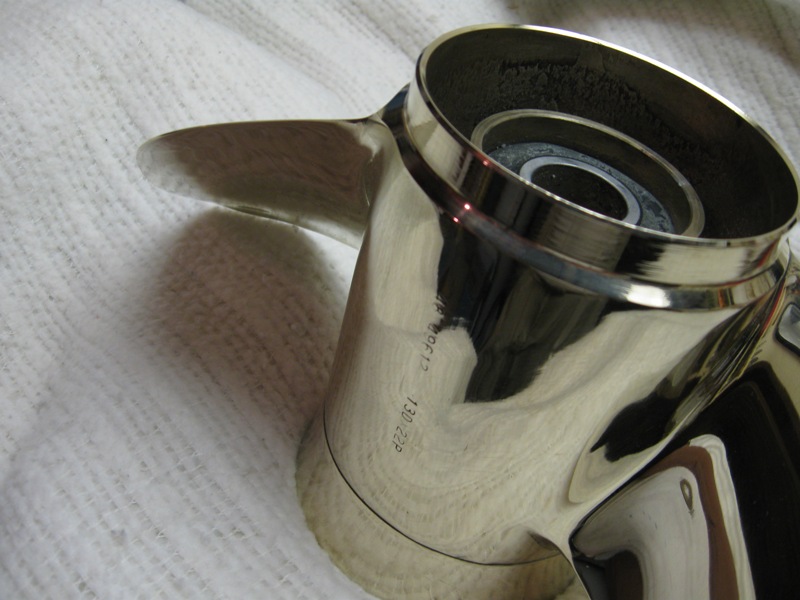

Ponyboy, have you had a chance to test the Hi-performance 22" bronze prop on a Johnson? Does the outboard need to be raised on the transom to work? Still debating whether or not this prop will be faster than a Raker 22". Pictures of a Hi-Performance 22" bronze and a Raker 22".

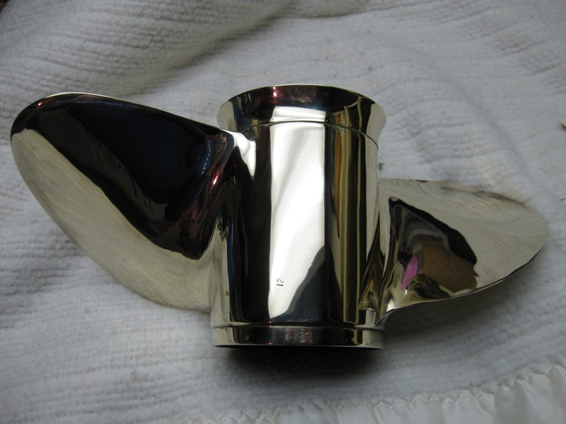

Here is a picture of a 22" Mercury Chopper that I sold without trying it on a 115 HP Merc.
