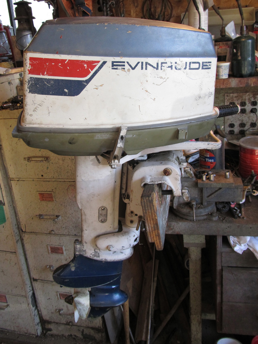

I'm not much good at ID'ing the older stuff, but if the size of the cowling is any indication of what's underneath I think you may be "under-propped" there Scott! He he

Robby, thanks. I noticed only a mist for water output. The impeller looks pretty weak so I'm going to replace it. Pretty simple. So surprised when I noticed it had two cylinders! Pretty cool. I have a couple of Scott Atwater 3.6hp motors. Only one lung on those.
Re:Why is my JW13 different? 13 years 11 months ago #71673
There is only supposed to be a little mist coming from the motor leg. 95% of the water goes out the exhaust outlet above the prop. Still a good idea to replace the impeller, though. Cheap insurance!!
