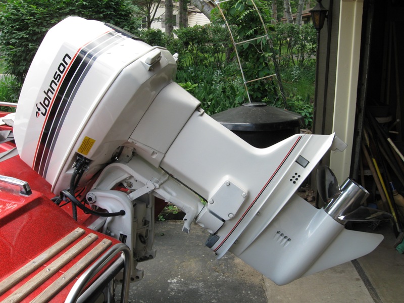

Does anyone have experience with the OMC 21" Pitch 2-Blade Bronze prop part #384141? I have a 87' Glastron/Carlson CVX-16 with a 1985 115 HP Johnson and have the best results with a 22" pitch Raker running 55.0 MPH at 5,400 RPM. Was wondering if the OMC bronze is worth tracking down and buying. Anyone have one for sale? Picture of my boat attached. Contract David at This email address is being protected from spambots. You need JavaScript enabled to view it.

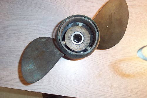

I have one for sale.....OMC 2 blade bronze prop #384141 (13 3/4 x 21) cup. It's from my late father in law's estate.
